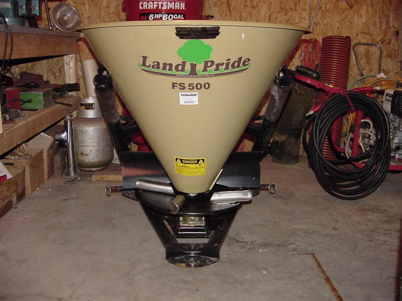

Marty,We have the standard Hopper Type P.T.O. driven spreader.It has the steel driveshaft,not the flex type.Has 2 openings that determine the flow rate.I've found that the ONLY way to spread Ag Lime with this unit is that the Lime has to be almost powder dry.
I live within 10 miles of a good Quarry,I will call them to see if they are crushing stone that day,if so,I will have them deliver a load that is "right out of the crusher".
If the Lime is the least bit damp,it will bridge and not flow worth a darn.Have learned this the hard way.The pelitized version will flow,break down,and start working sooner,but is much more expensive.
If you have access to dry Lime,this spreader will work for you.
