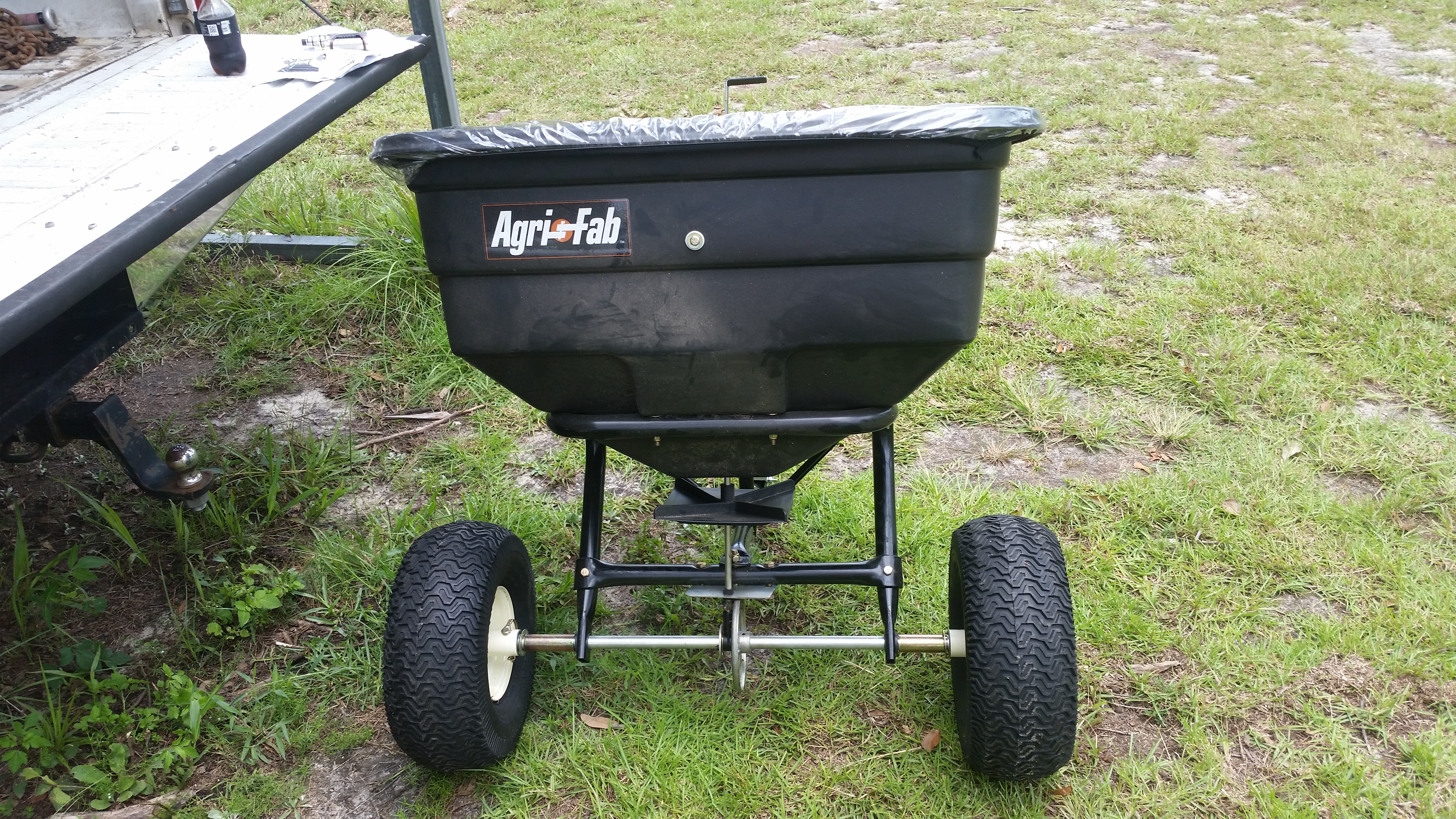

I am in need of a spreader and see a lot of complaints that spook me. I thought my needs were simple but apparently not. Here is what I need to accomplish.
We will ultimately have about 15 acres of field to spread nitrate.
about 3 acres (possibly more) that I will want to spread Black Kow Compost on as it is Centipede
The Centipede grass will also get Milorganite
Also seeding and other things
The complaints I see are:
Striping/overspray of Nitrate
Compost/Top Dressing plugs the spreader
I am looking at the Land Pride PFS series since the tow behind less expensive spreaders all said they won't spread top dressing. I don't really want to spend a ton of money and really didn't want 2 implements.
Any advice would be greatly appreciated!

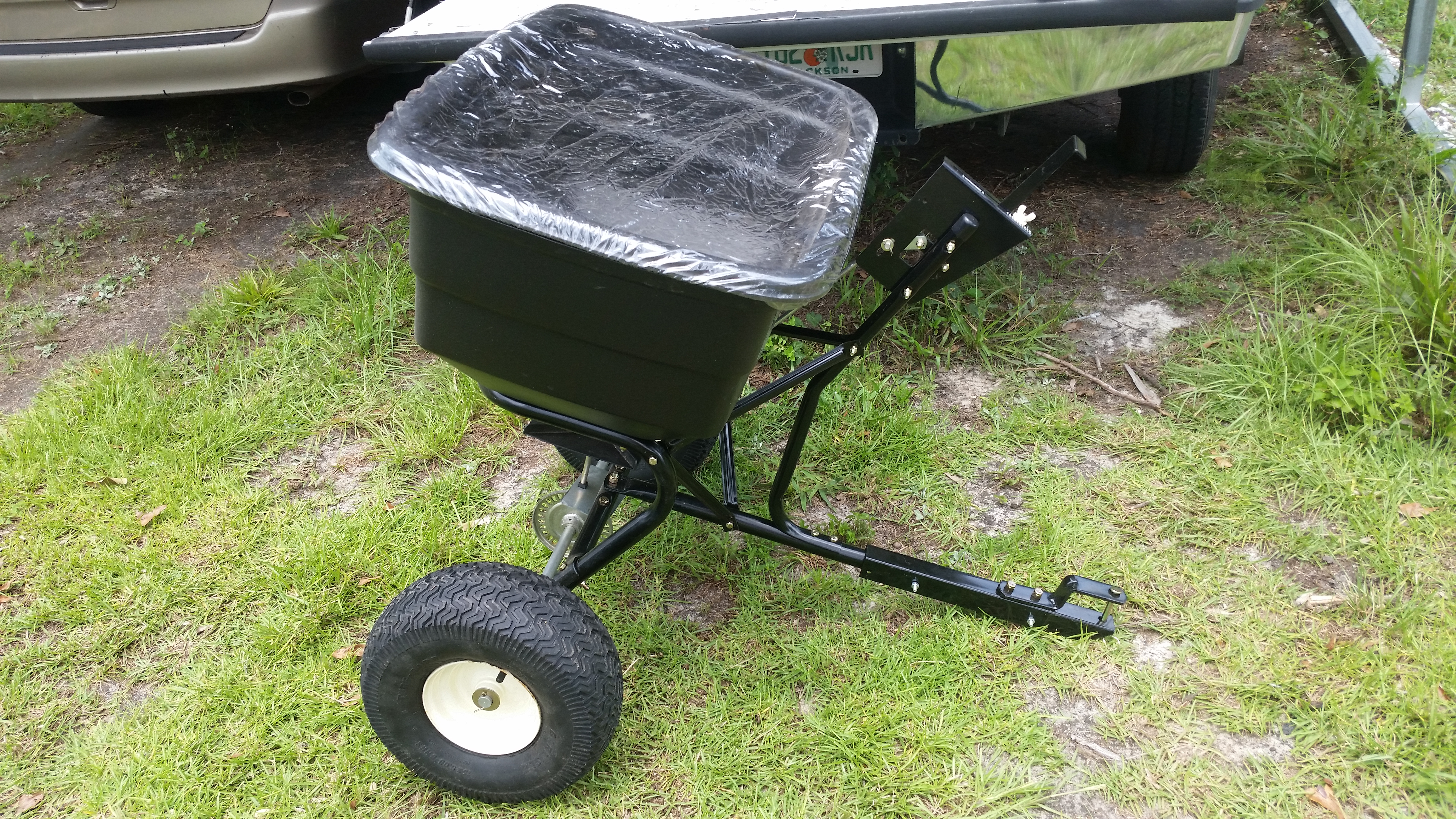

I made a decision to just get a spreader for seeds and dry fertilizer. The teenagers (ages 14 and 15) will just have to be my compost spreaders :D Hey, I tried to do it mechanically. :D
Our local tractor dealer had a AgriFab broadcast spreader in their warehouse that was just a one off and we got a deep discount on it. It is 250 pound with ATV pin hitch as well as an adapter for ball hitch. Here is a couple of pics of it. I am quite pleased with this decision. I just couldn't justify the cost of something to spread the Black Kow Compost..... Sad but I will get over it.
