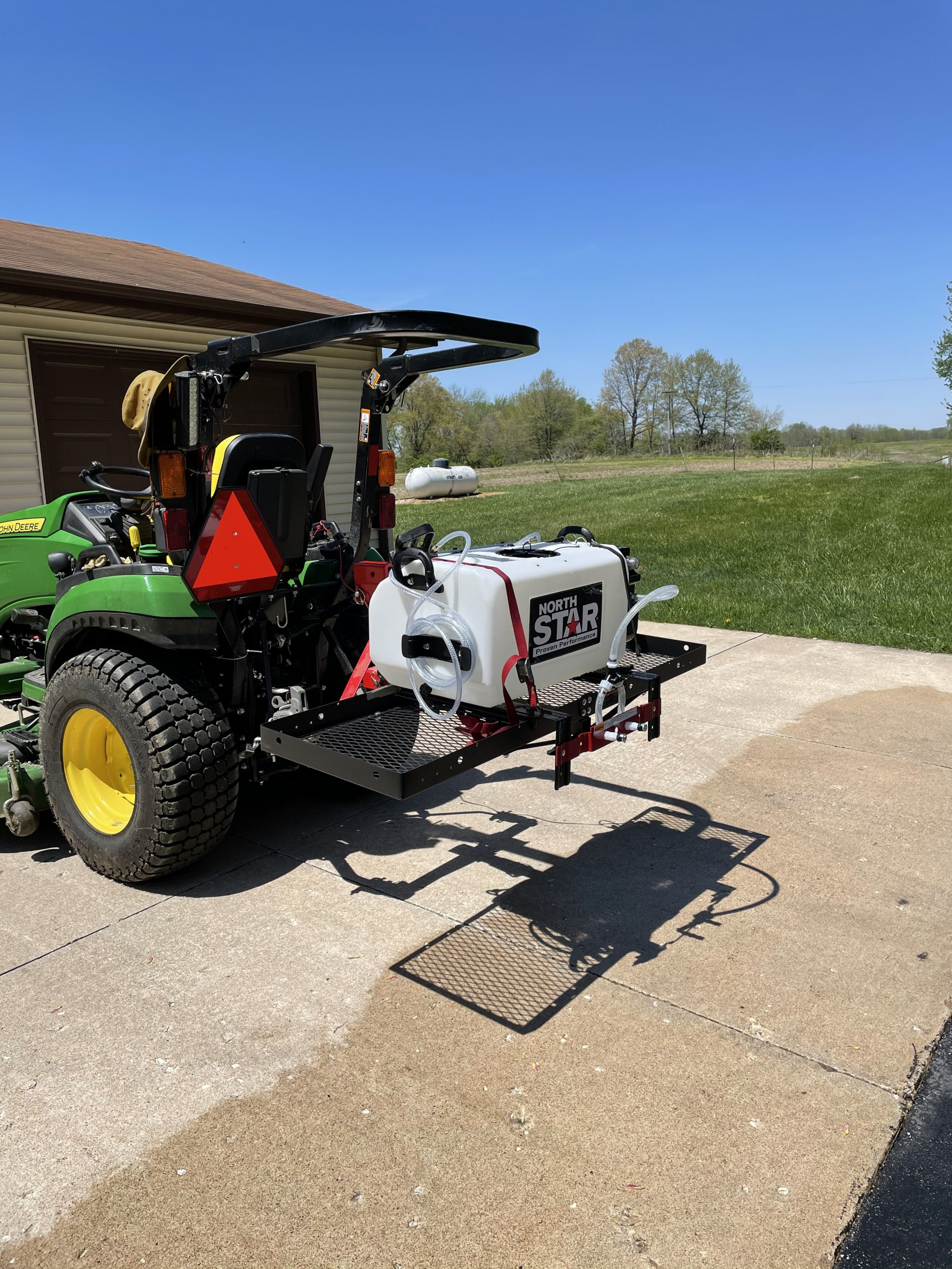

/ sprayer? #9
This is a Northern Tool 26 gallon, it’s designed for the back of a UTV but I put it on a cargo rack mounted on my 3 point. I just got it a couple of weeks ago, it has two broadcast nozzles and a hand sprayer too. It was about $375 on Amazon. I like it but it had some leaks I had to tighten up before using.

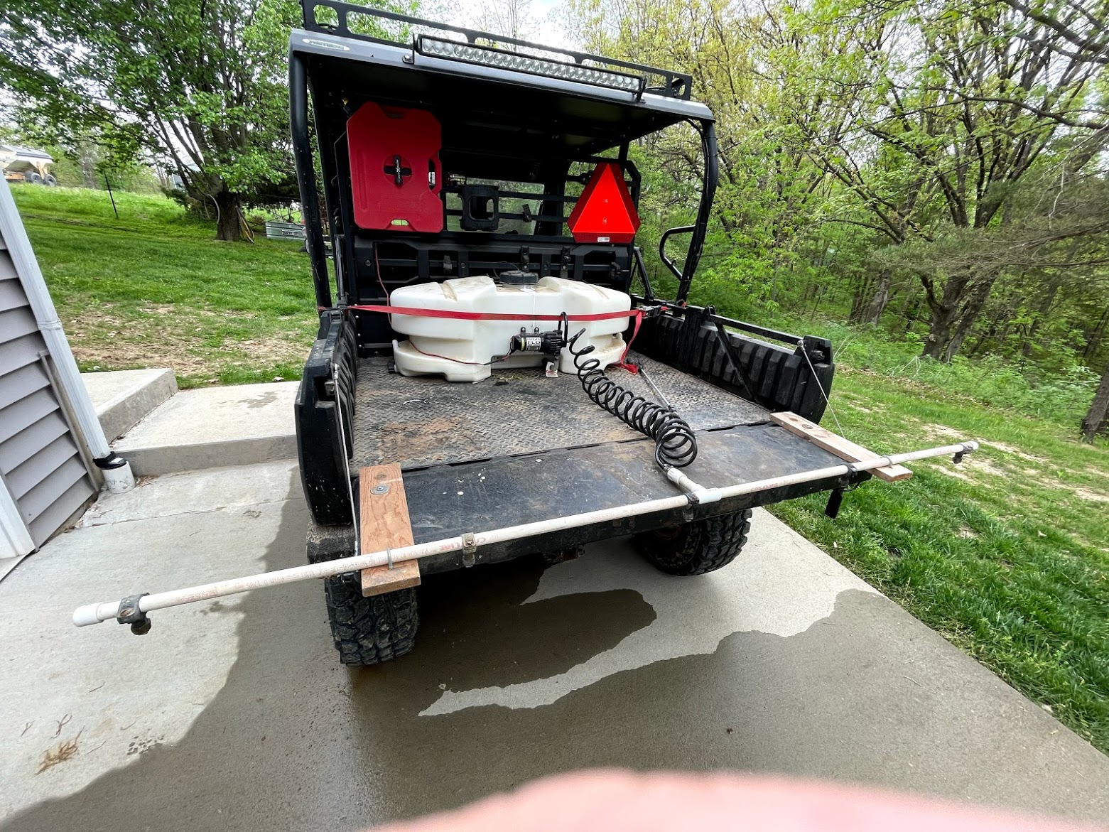

I just went sold my 3pt sprayer w/ roller pump. It held more water than my 35 gallon diaphragm pump sprayer does which was nice but for me managing 5-10 acres of food plots a year it was just easier for me to use the UTV sprayer. I built my own boom for it. I'm not really a fan of the boomless sprayers as you don't get as good of coverage compared to a boom. I take my diaphragm pumps off and store them in the house over winter.

Here are some pics of my set up. The boom less nozzle is on a pipe and it slips into a larger pipe that is more permanently mounted to the back of the bed. I have valves so that I can spray from either the nozzle or a wand.
I mounted a switch on the side of the seat. I have only one power supply to the bed. I just switch the power to which ever tank I'm using. I also use the power for a light mounted up on the cab.
