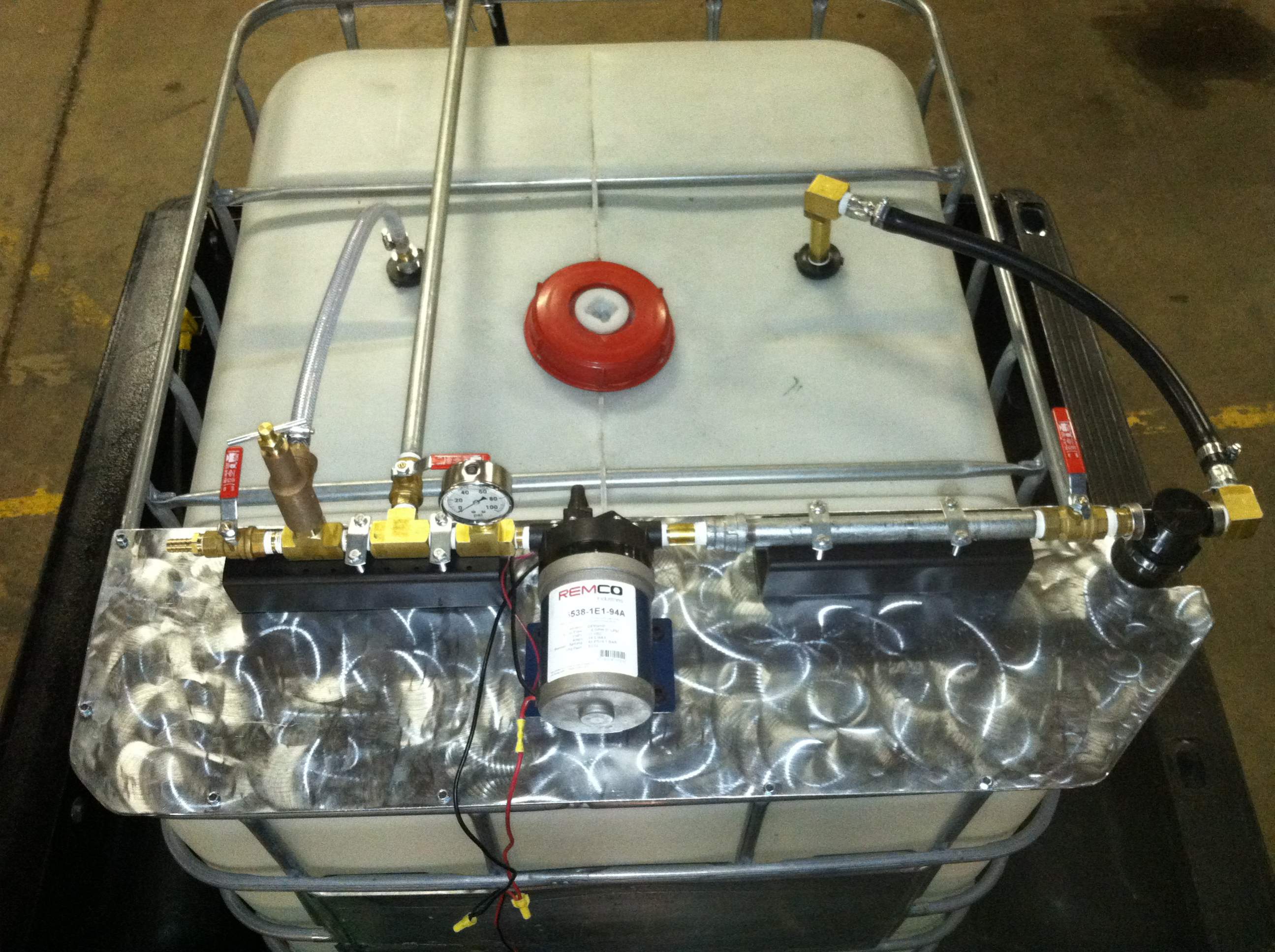

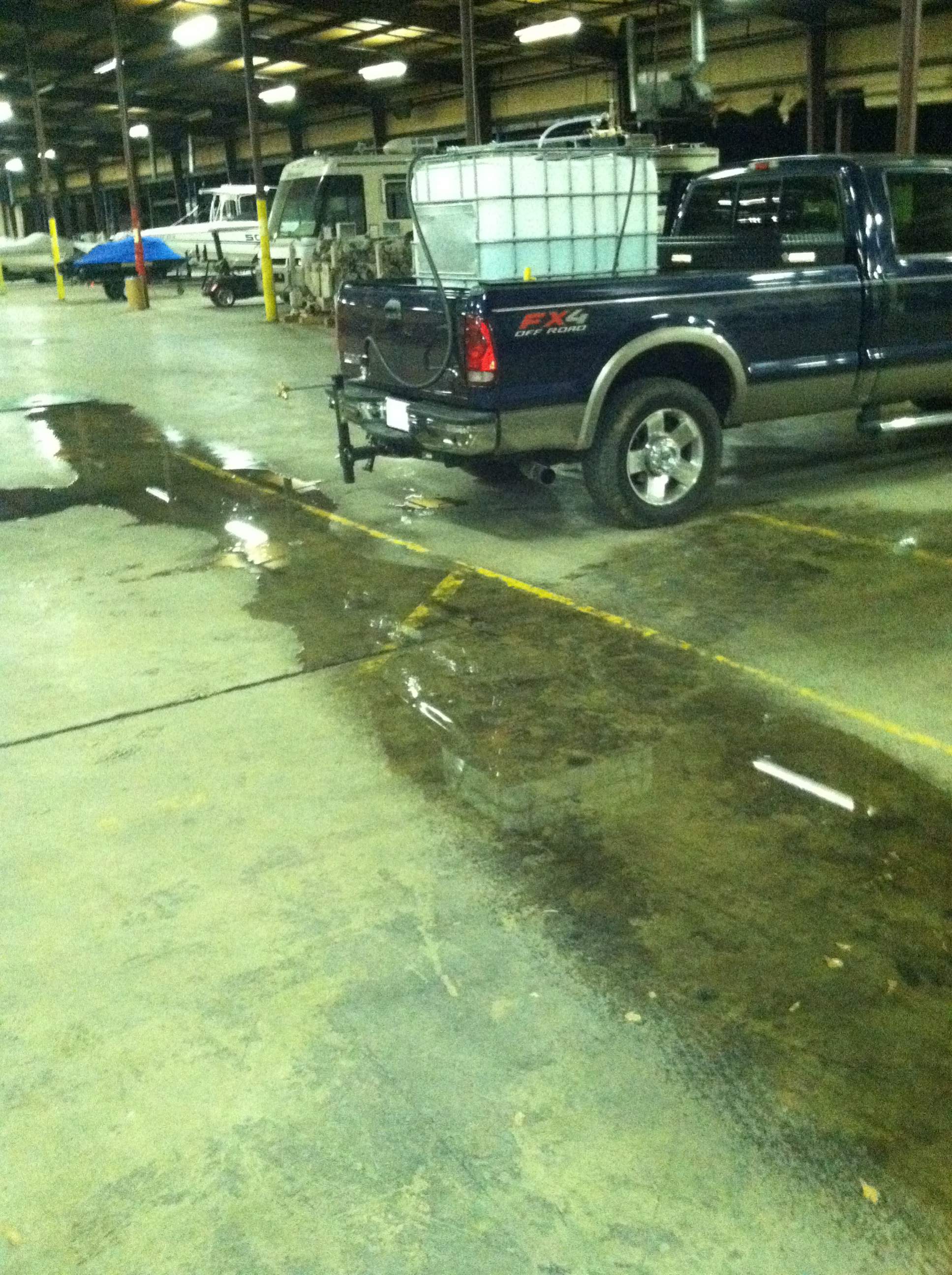

This is what I have come up with after much research and advice here on TBN. I debated about several styles, 3 point vs. trailer vs. skid type. For my needs, hopefully this will work. I wanted it easy to transport, able to fill with water at home rather than on site, quick, and not dependent on having a tractor, and of course, cheap!

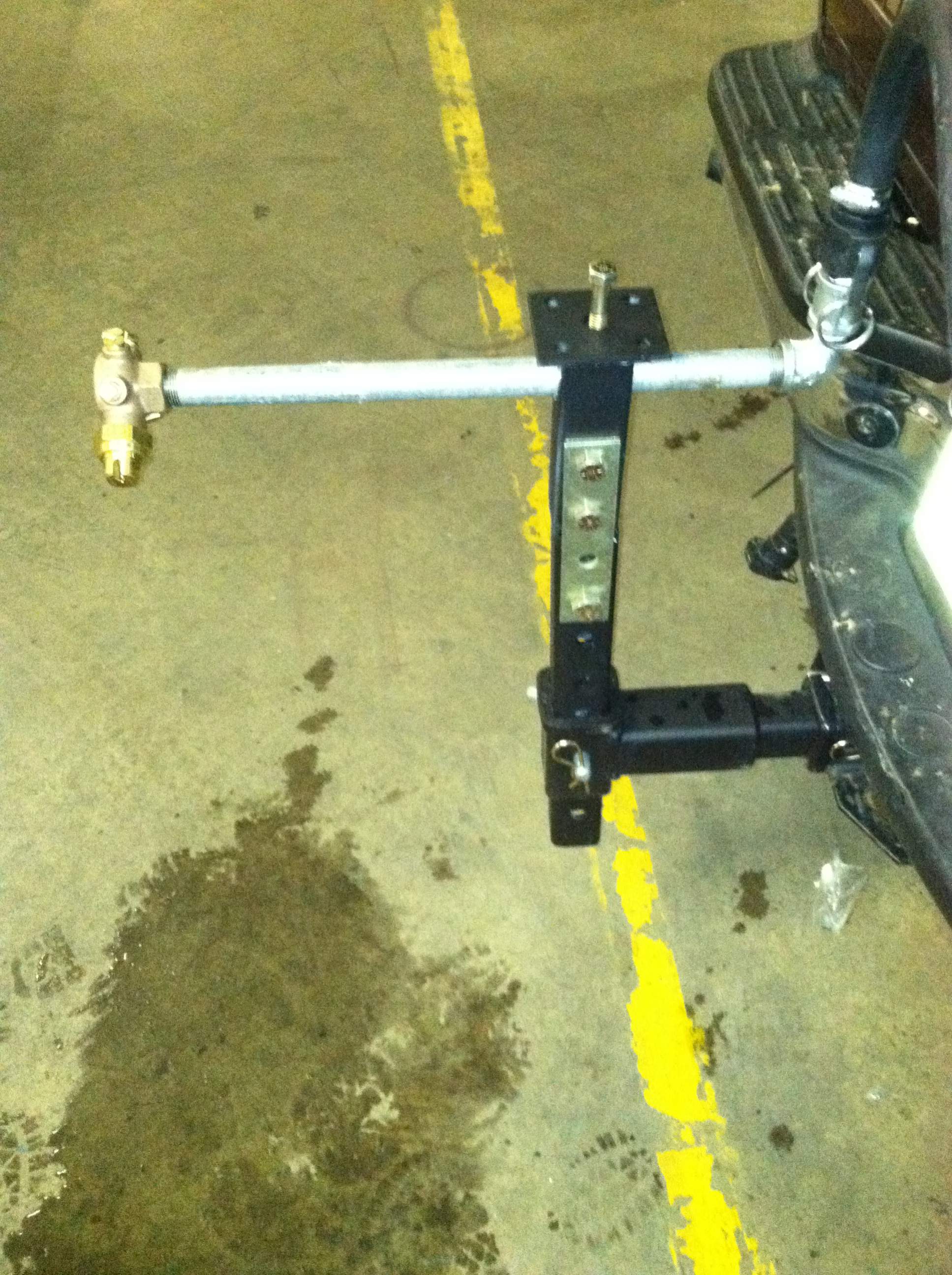

I bought a 275 gal. tote, and plumbed it with common hardware store items. The pump is the mac-daddy 12 V. pushing over 6 gallons per minute. It was the most costly thing, about $250. The jet is a tee jet boomless found at Tractor supply. It has 5 nozzles, but I had to plug the outer two as it just sprayed too wide for my usage. Even with them plugged, it sprays about a
35' path. I need to play with the PSI and angulation and height of the jet. I connected it to a deep cycle battery, but will eventually wire it to my upfitter switch on my dash, and have a plug in. THe hoses have quick connects and it also has a spray wand for occasional use. I will try it out soon to spray my plots and road ways with Roundup.

WOW, HC, I'm pretty impressed. Since I only have two little fields, a 2 acre anda 1 acre, I don't need anywhere as much capacity but I'm pretty impressed with your ingenuity and talent.:thumbsup:

Thanks! But I don't want to get too cocky until I see how it works in the field! It works great wetting my shop floor. I think the first time I use it will be a learning experience. I probably need to be back in the truck bed monitoring the flow while someone else drives. I think proper speed will be critical as far as coverage. And I expect some overspray, but in my situation, killing some road or plotside plants will not matter, in fact, it is desired to maybe minimize the trimming I have to do. I designed the rear hitch so that I can also attach my boom (from my little 20 gallon ATV sprayer) by only using one bolt, and the hoses will also quick connect, so if I need more accurate coverage, I can always switch from boomless to boom.
I also see the need for a 12V controlled valve. I thought i could control it from the cab by simply turning the motor on/off with a remote switch, but it tends to dribble, and that will waste chemicals. But all in all, I think it will work, and at least it has the capacity to cover some ground without having to return to a water source to refill.
I initially intended to build a frame so I could lift it with my FEL, but after some thought, I decided lighter was better. I can now load it in my truck by myself (empty of course). And I don't see the need to ever lift it with water in it.

Here are some things to consider. First make sure you have an area away from a public car wash to wash the back of your truck off. Secondly if that pump don't have thermal protection be prepared to shut it down to let it cool.
The dribble you are talking about is the main reason I always recommend diaphragm spray bodies and booms.

Tried out my new sprayer today. It actually worked well. I put out about 450 gallons of glyphosate and 2-4D over various food plots and roadways. I had a friend drive the truck while I operated the 12V switch. It covered about a 30 ft. swath. The pump stayed cool to the touch and did great. Some of the areas were grown up in 24" tall grasses so it will interesting to see how it responds. I feel I will need to bush hog before I plant, and maybe even spray again. I probably should have cut it a few weeks ago first, before I sprayed. How does grass this tall usually react? Can't wait to see the result and to try out my new notil planter and drill.
