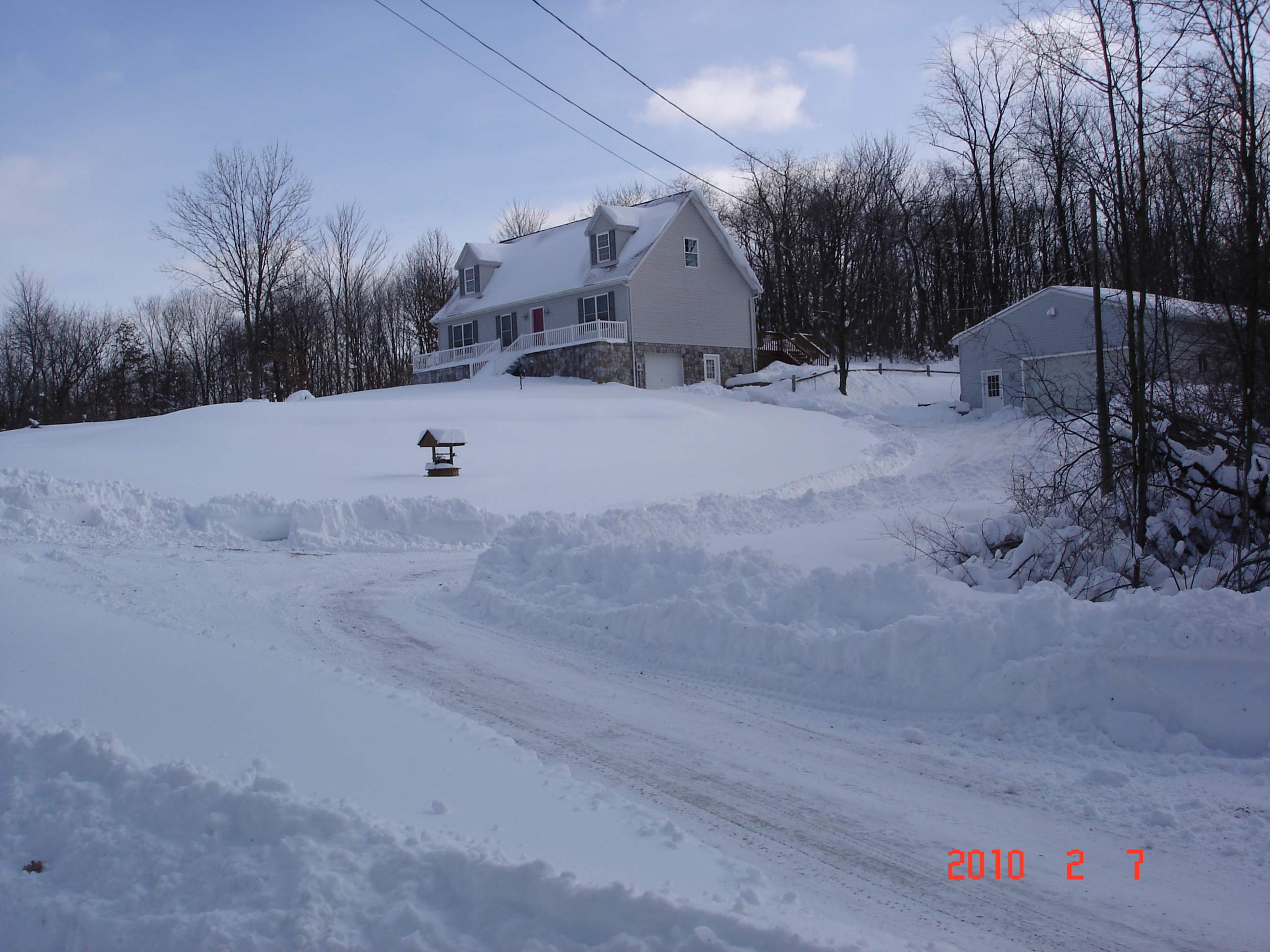

Thanks for the info given so far...more data: 5" of open cell on the roof joists and 3" on the gable ends and dormer walls. They want to put a thin sheet of foam board down at the soffits and fill the gap with foam...The open cell is giving me some pause as has been said here. The company says it's no issue--gonna call the manufacturer tomorrow.
The interior of the knee walls and collar ties will be drywalled, heated and air conditioned. I have a heat pump with an electric backup furnace so no fuel burn issues...All mechanicals are in the basement.
For reference, here's an outside picture so you have an idea of the style..12/12 pitch etc

Your pic shows heat loss at the interface of the gable end wall(s) and roof, and at the ridge line.
Have you had an energy audit done? Blower door test, to see how many air exchanges/hr?
I would have those done before any of the work you plan to do to show a base line and then where they hopefully make improvements in the building envelope.
Is the attic living space? If not then the alternative, less costly method is to super insulate, (R-50) the 2nd floor ceiling/attic joist bays and keep the soffit vents/ridge line vents, gable vents. Then the cold air area above the heated living space is not problematic.

At the time of that picture, there was "utility insulation" on the floor and stairwell in addition to an uninsulated door at the top of the steps...Also, we had 3 feet of snow the night before and the outside temp went to almost 50 the next day, so oddities all around in that picture as far as snow melt.
Edit--The picture also is showing the north side of the house, the sun and warm temp had already melted the south side...There was no drywall etc up there at the time, just some insulation on the ceiling of the first floor...The sun would warm it up pretty good, even in the winter due to the pitch and size of the roof.
