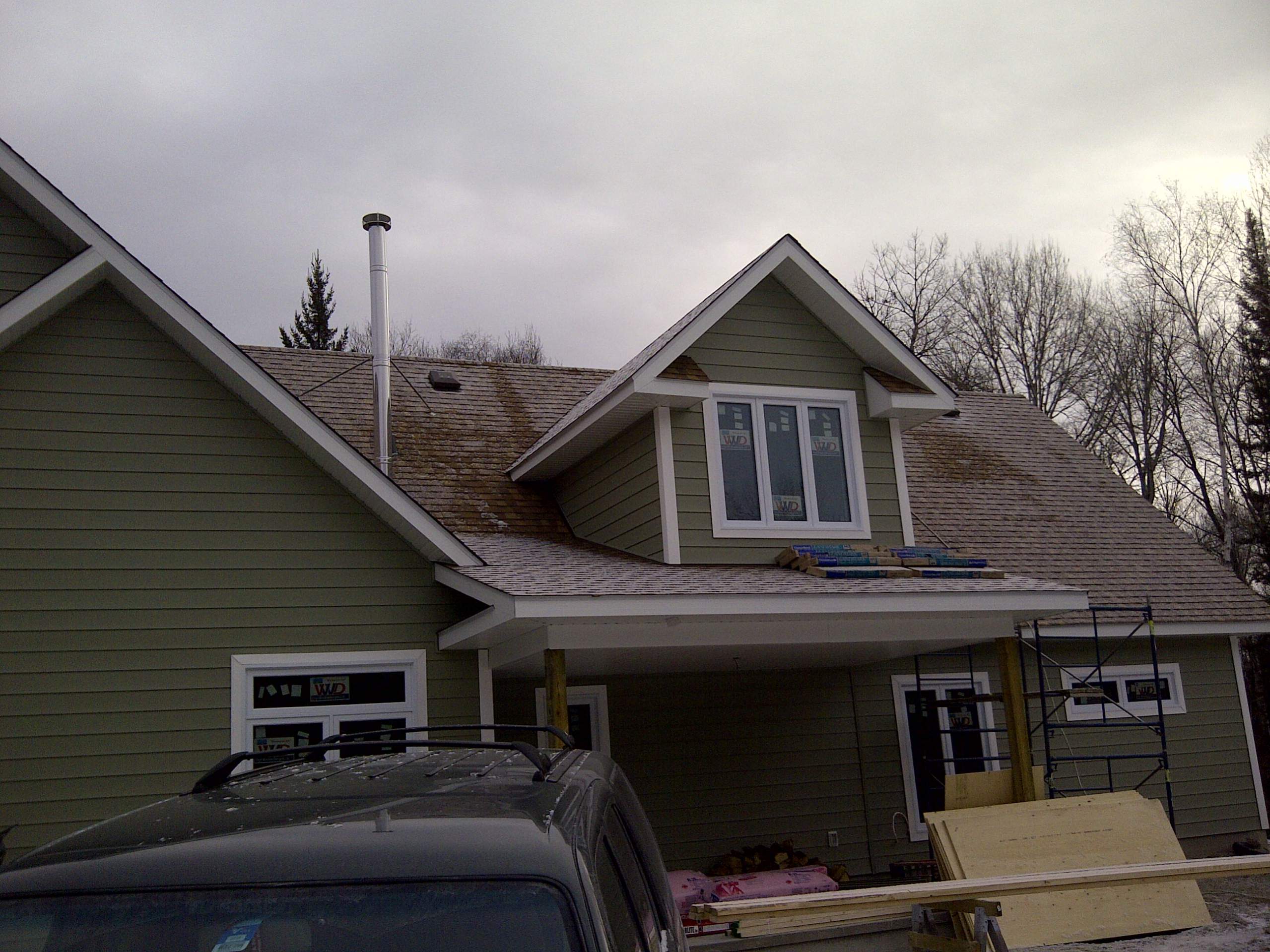

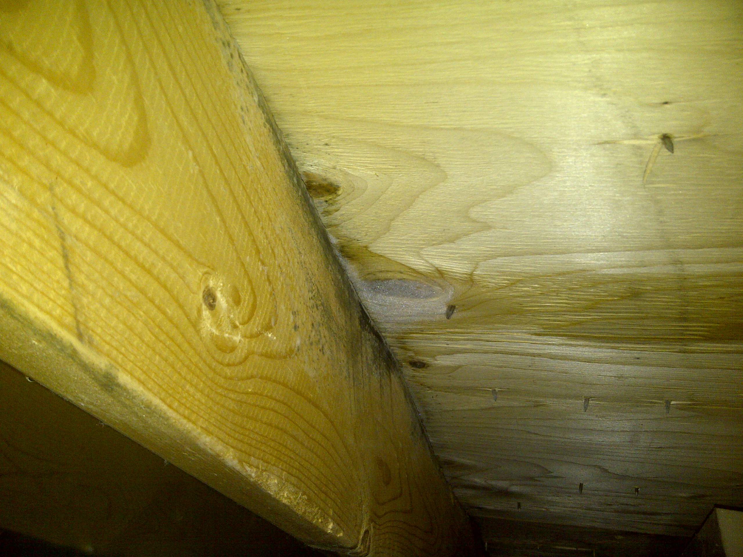

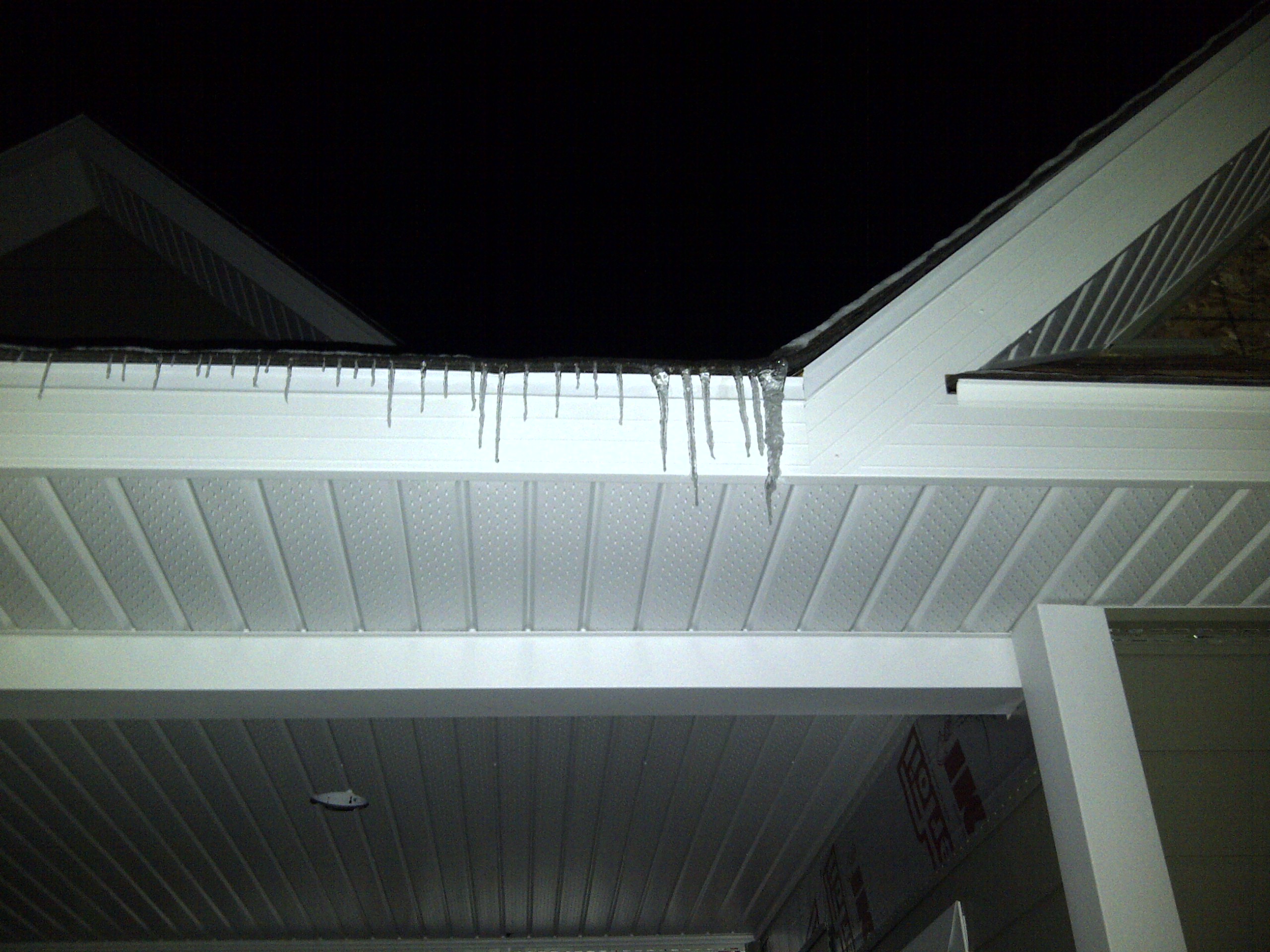

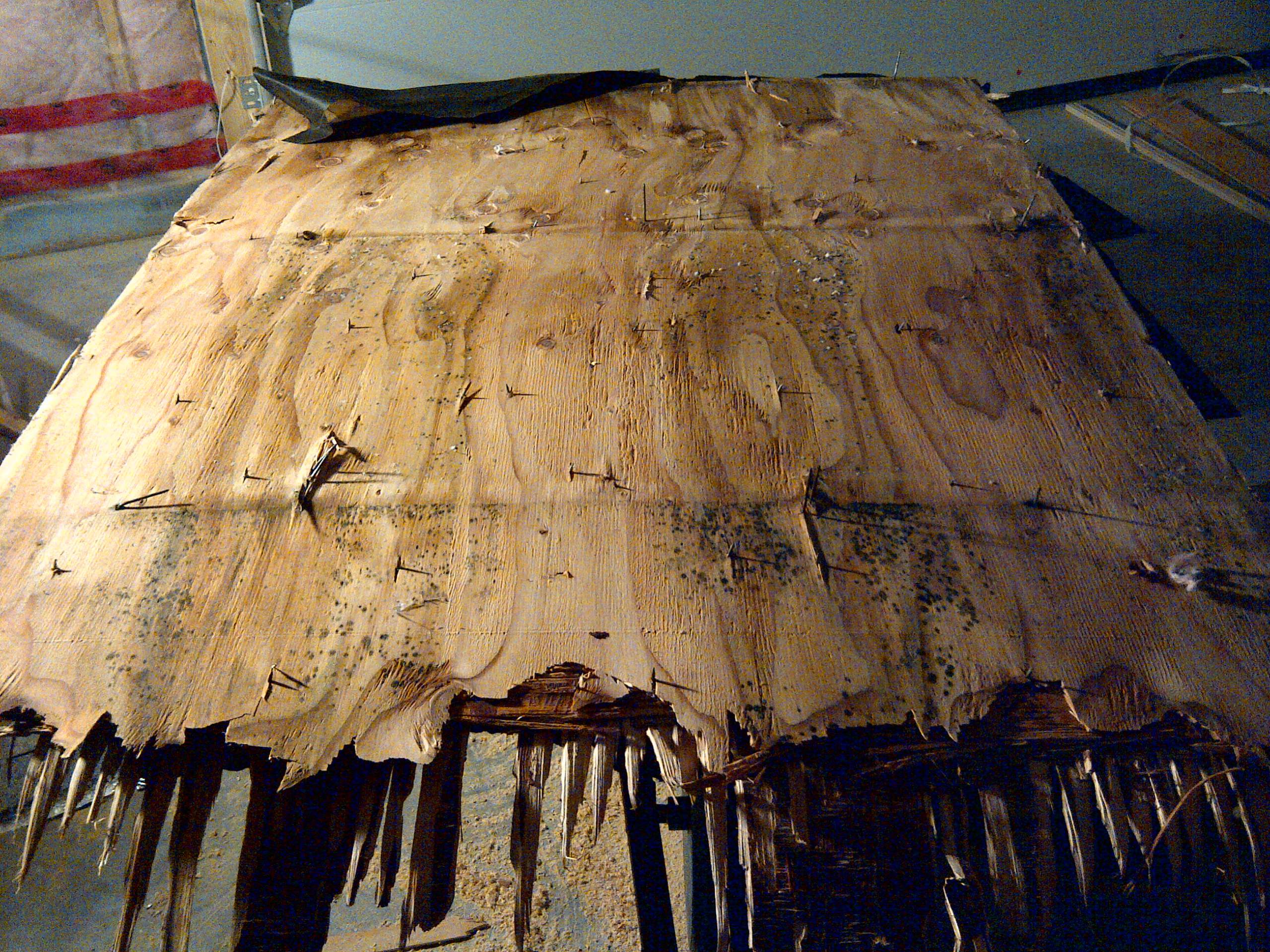

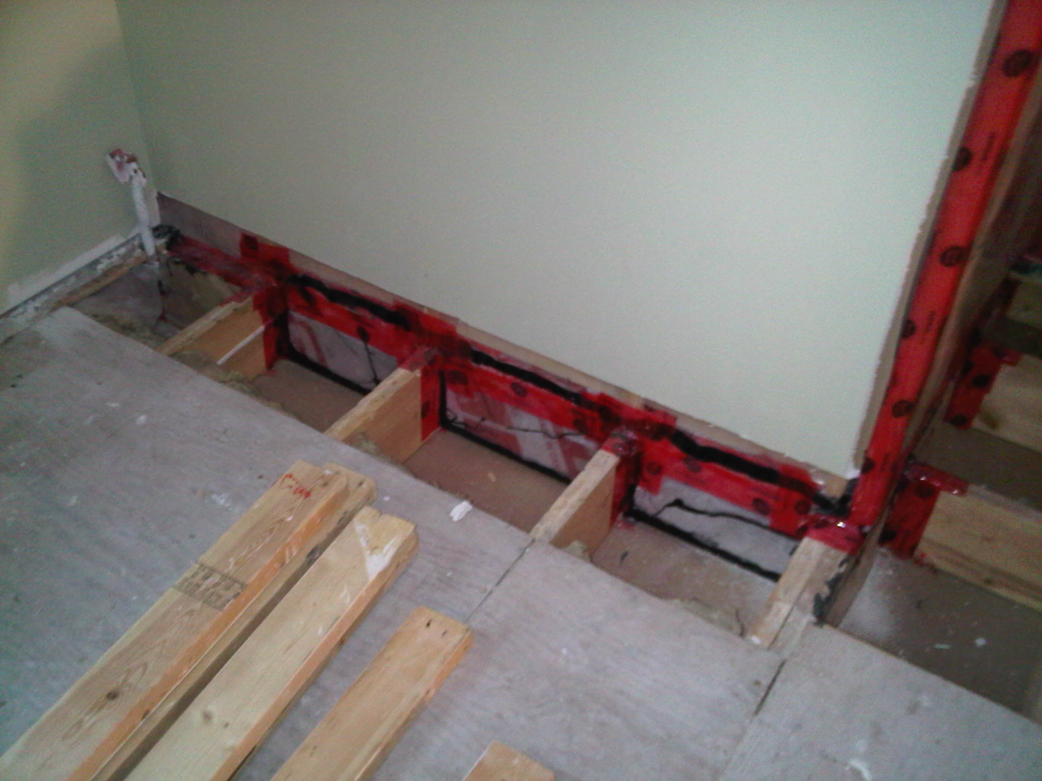

Here are a few pictures of a recent built (2012) cape cod insulated with fiberglass insulation. I had R 60 on the flat areas, R13 plus 3" of rigid foam on the verticals and R40 (2 x R20 batts on the angles) with 1.5" of venting between insulation and the roof deck.
Pictures taken late fall 2012(Builder said that this was normal):
Picture taken early winter 2012(Builder maintains that this was normal):
Picture taken of roof plywood removed and trusses 6 weeks after the home was insulated:
We tried to seal up the vapour as best we could once the issues were discovered:
After the builder tried to fix the problems for the 3rd attempt using conventional fiberglass insulation I insisted that the architect's recommendation to use spray foam be followed. During winter 2013 we could not see any frost/snow melting or any ice forming on the edge of the roof.

Where is the venting for the attic of that gabled roof?
   / Spray Foam Question #30
CT-
I see a couple of turtle vents up there, if that's the only vents, there is going be a lot more problems
