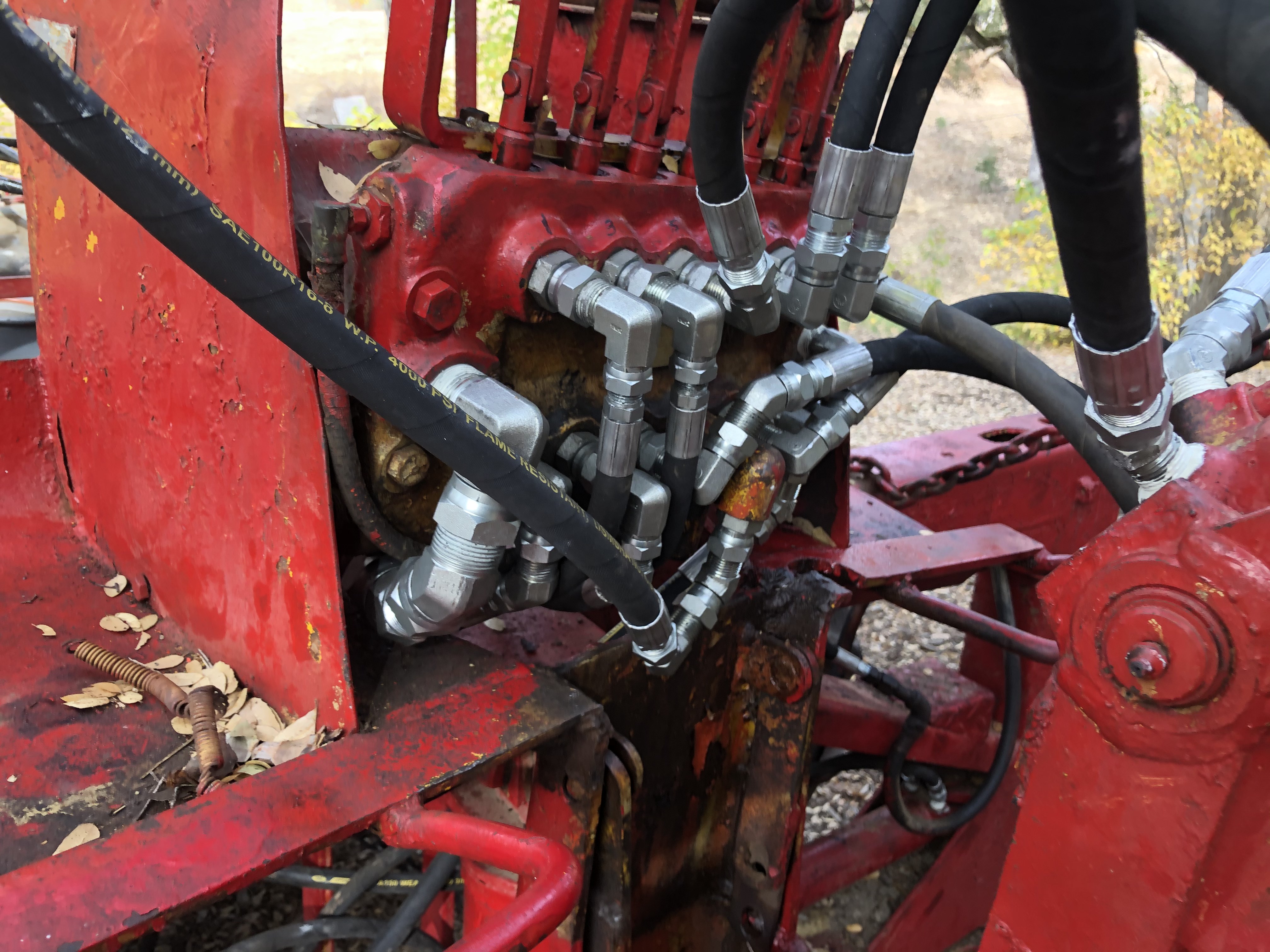

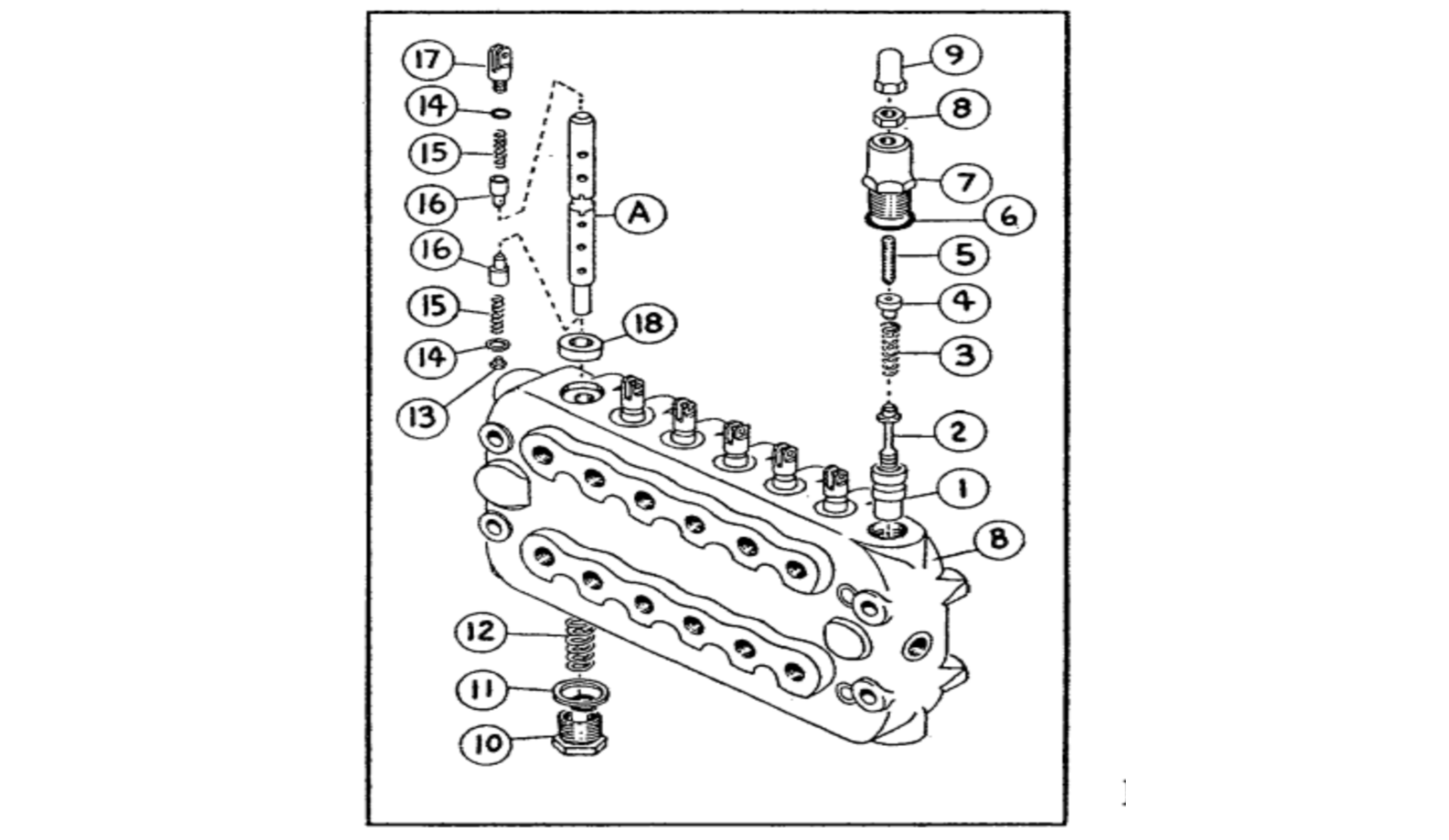

The last of the external leaks on my Davis 185 backhoe are coming from a few of the spools. The diagrams show the seals press in from the top. Is it possible to remove them without pulling the spools? #18 in diagram.
Thank you,
Don

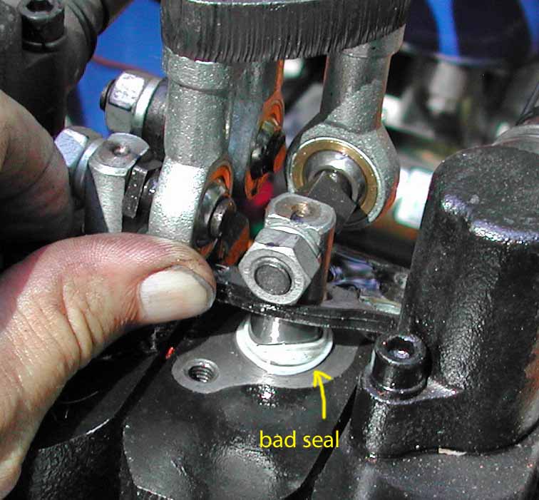

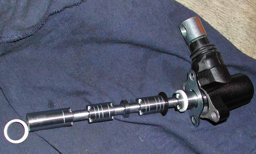

Do you have access problems, Don?
It is usually not too hard to get the spool out, and that is the correct way to replace the seal. You need to remove retainer (#10) from the other side.

Looking again at the diagram, #14 seems to be more a seal on both ends of the sleeve itself, the top one being perhaps changeable by just pulling the sleeve partway out. (O-ring?)
My advice on page one was with expecting #18 to be a lip seal with steel shell/face vs say a poly bushing/wiper, I now agree more likely. If that wore enough to let dirt gum up or mess #14 changing both would seem to vet whether the bores were worn enough that a good #14 wasn't enough to reduce the leak enough.
If what leaked between #14 & #18 could drain to return, would the top one have to contain much pressure? (unlikely :laughing:) Double-lip seals at both ends of crank/cam shafts contain oil pressure that I bet is fairly higher than return pressure in an OC valve/stack.
/ Spool Valve Seals
#14
I looked up #14. They call it a ring seal, so your correct. I think I will pull 1spool and prepare myself for a new valve assembly and the work required to make it work.
