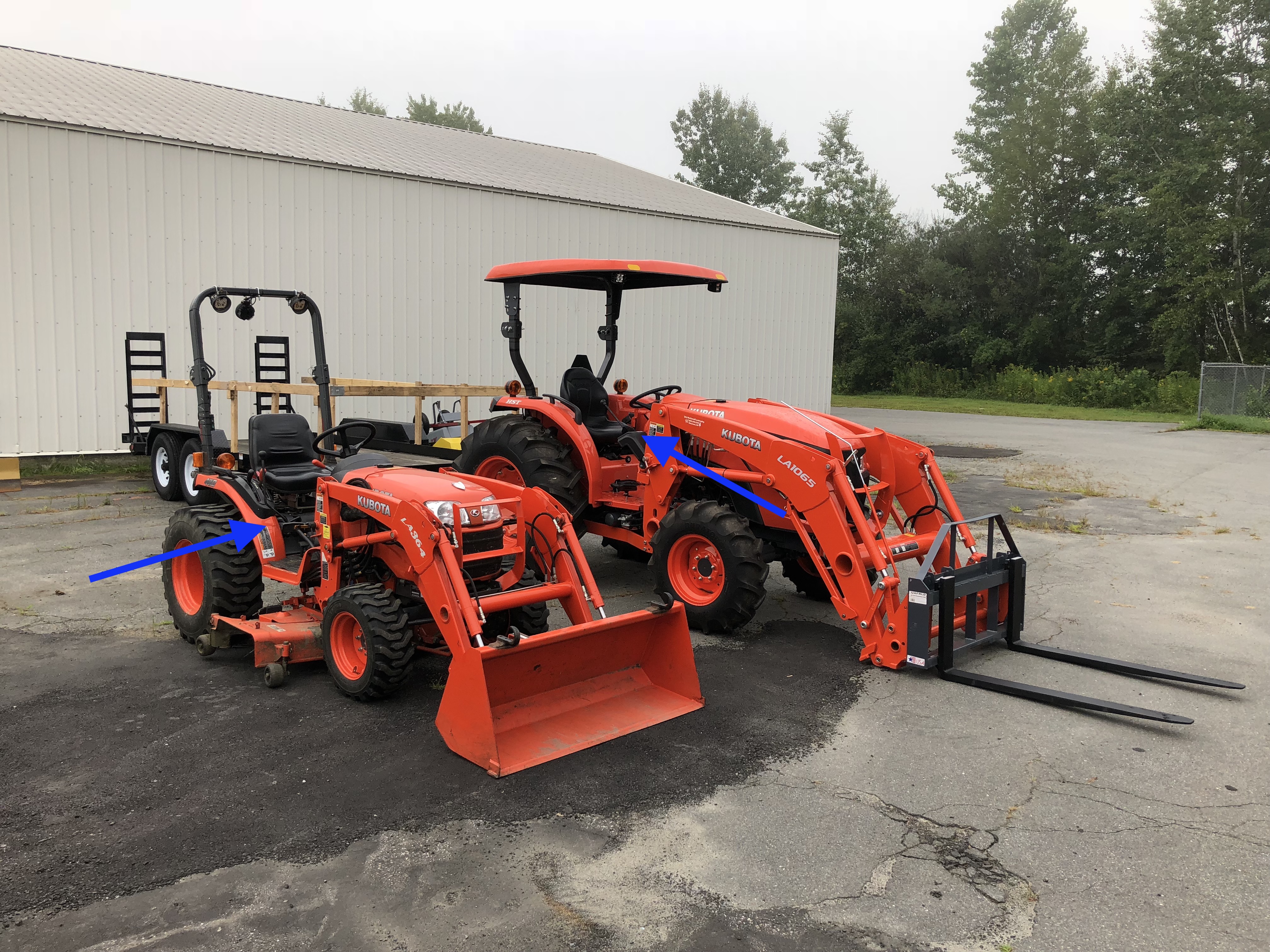

The Kubota B-series is a little different, I think. For example, the loader valve comes with the base tractor, but no loader. It is mounted down on the side of the transmission, kind of inside the rear fender. The loader joystick comes up from the floor by the operator's right foot area.
My other Kubotas have the loader valve mounted up high to the right of the instrument cluster. Attached is a pic of my B-series next to my new MX...arrowed are the locations of the valves. Do you think one of these aftermarkets would still work?
Yes, an aftermarket would work. No question about it. And it would be more durable and probably more sensitive. But after viewing your picture it would require some pretty sophisticated fabrication abilities as well as knowledge of hydraulics to move an aftermarket valve up to a new location. Price wise you'd probably save half the price of a stock valve in return for your time. I'm guessing you already know if you have these skills or want to put that time into it.
