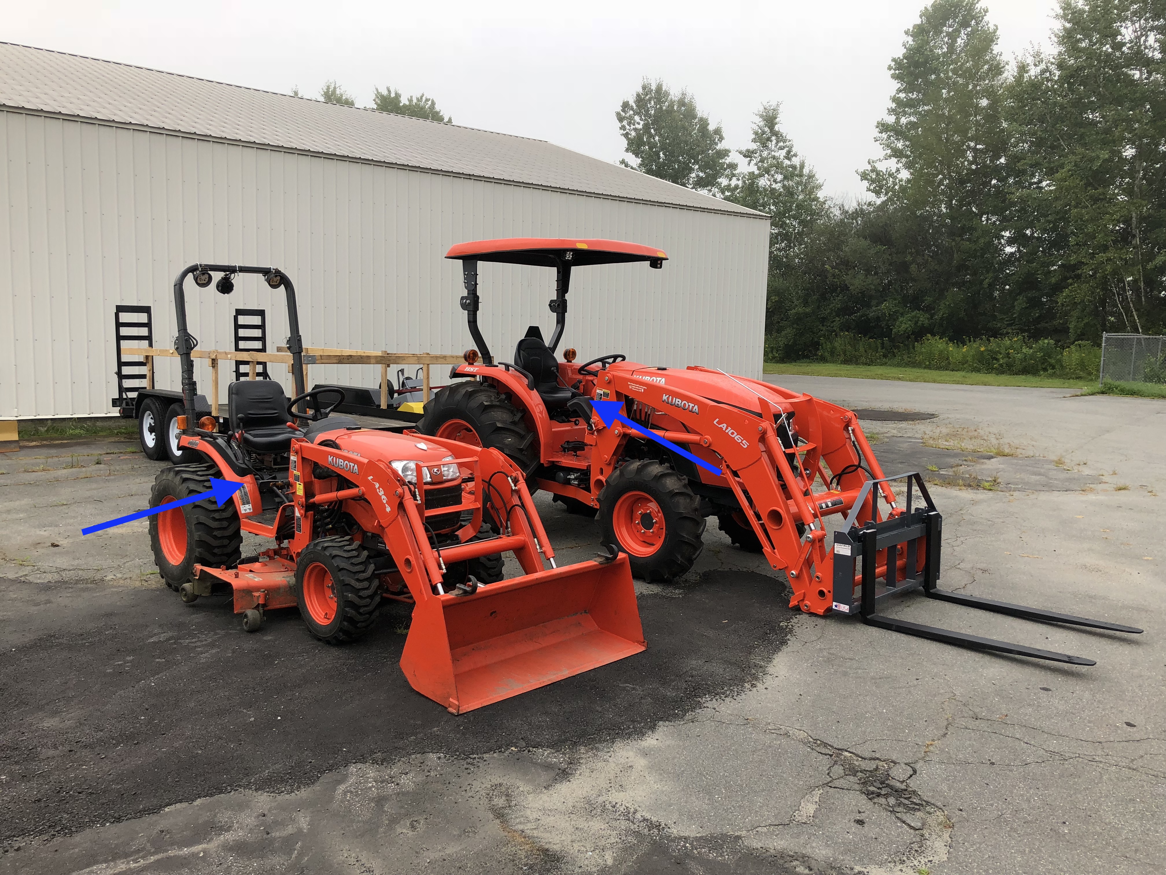

Thanks a lot guys. Do these aftermarket valve kits just "bolt on" or is some fabricating needed?
The Kubota B-series is a little different, I think. For example, the loader valve comes with the base tractor, but no loader. It is mounted down on the side of the transmission, kind of inside the rear fender. The loader joystick comes up from the floor by the operator's right foot area.
My other Kubotas have the loader valve mounted up high to the right of the instrument cluster. Attached is a pic of my B-series next to my new MX...arrowed are the locations of the valves. Do you think one of these aftermarkets would still work?

Many (most?) newer tractors put their factory FEL valves near the driver's right thigh, as you have on your 'B'. They use a manifold that connects right up to the trans housing. The IN line comes out of the pump way up front off the engine, usually with a hardline. The PB OUT may use an external hardline to the 3-pt cyl, or connect internally thru the manifold. The OUT line return-to-tank probably uses an internal connection thru the manifold.
That is how my Kioti is plumbed, as well as numerous JDs I have owned.
So you CAN use an aftermarket valve, but you will have to do some custom plumbing work: adapt IN and PB hardlines, find another OUT port, and probably mount new valve on right fender.

from pics I found it looks like the 2929 has a remote loader valve. Usually those are operated by cables. So you will need to get a cable operated type valve and connect or adapt the Kubota's joystick cables to it.
