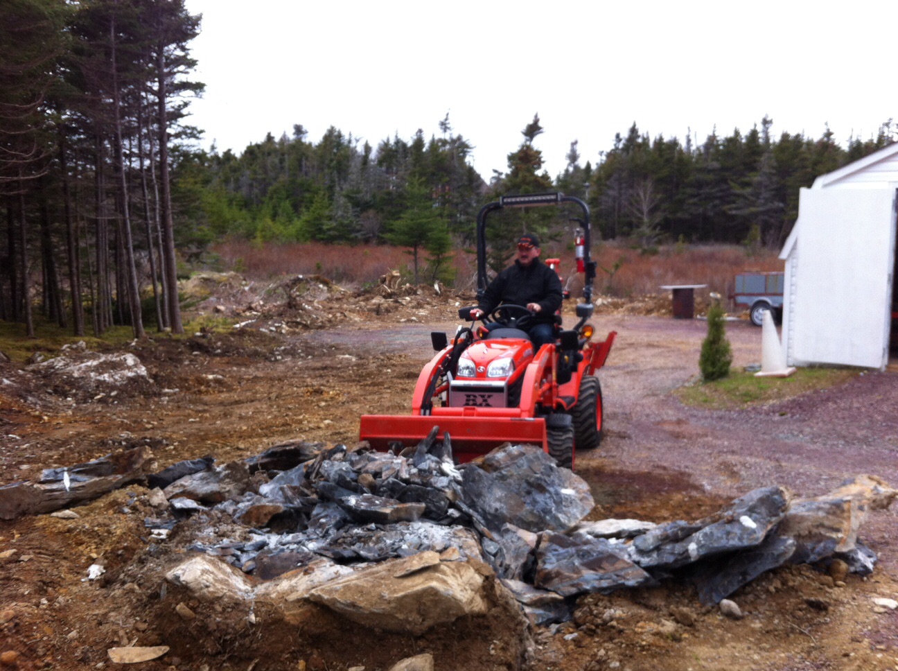

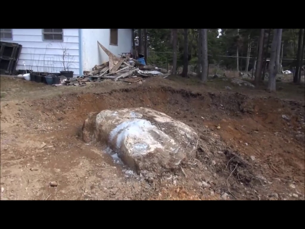

I drilled 30 1.25" holes with the SDS Bosch hammer drill then poured the Ecobust in. Let it set for 24 hours and you could here it splitting the whole time. After I got the BX and cleaned up the pieces but the rock was still a little above grade so I did it again and the battle was won.

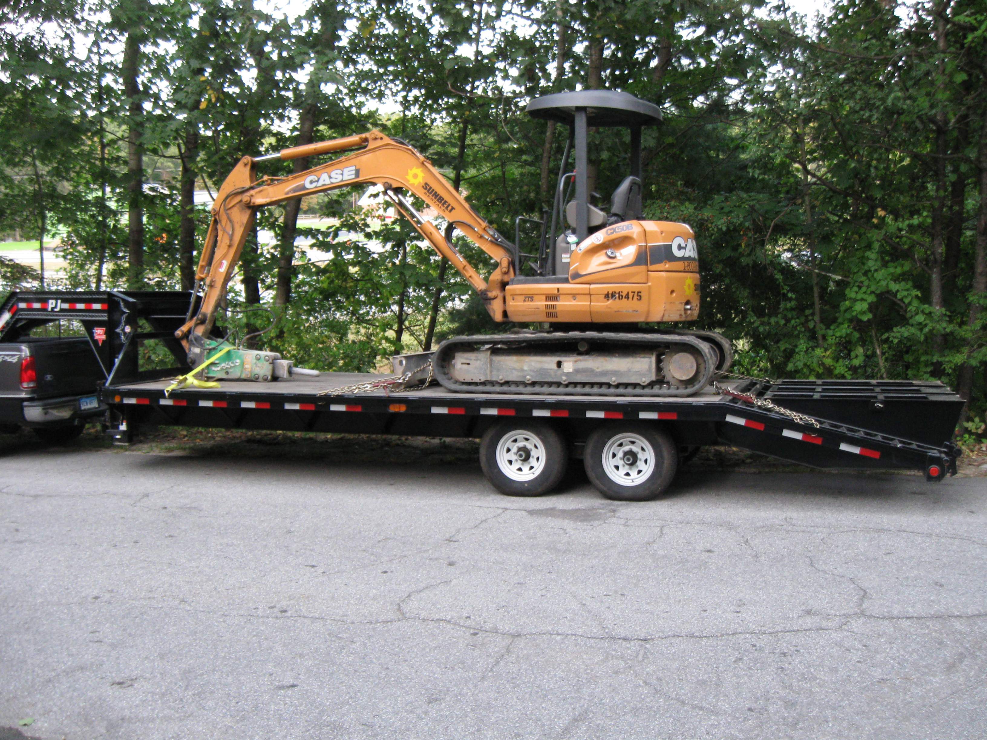

Can you post pics of the rocks in question? I had some compact car size granite rocks in my property. I was doing the drilling and feathering thing but it was a slow process. I ended up renting a 5 ton mini ex with hammer for around $700. The rock was smashed to pieces in about 20 min. I was shocked how well it worked out.

I was skeptical about the hammer on the mini before running one. One thing I'd look for if you go the mini route is get a cabbed unit or at least lexan shield because I took several bullets of shattered rock to the head and body.
