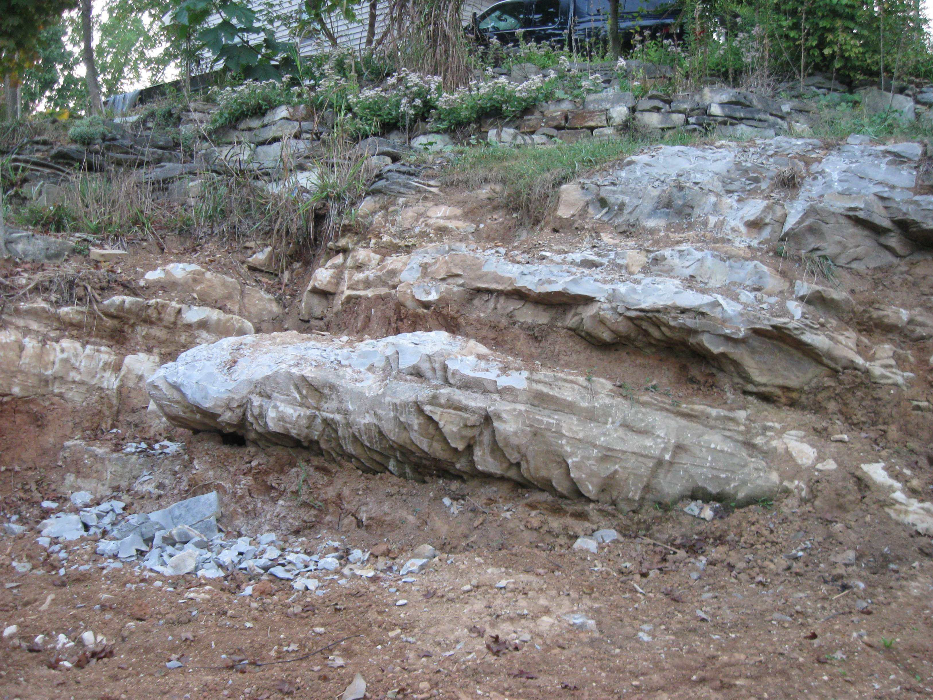

Find or call your local rental yard and rent a rock drill package (in CA they rent for around $150 per day)......then purchase the expansive material (sells for around $120 per box)...I listed a picture of the granite rock we split on an earlier post

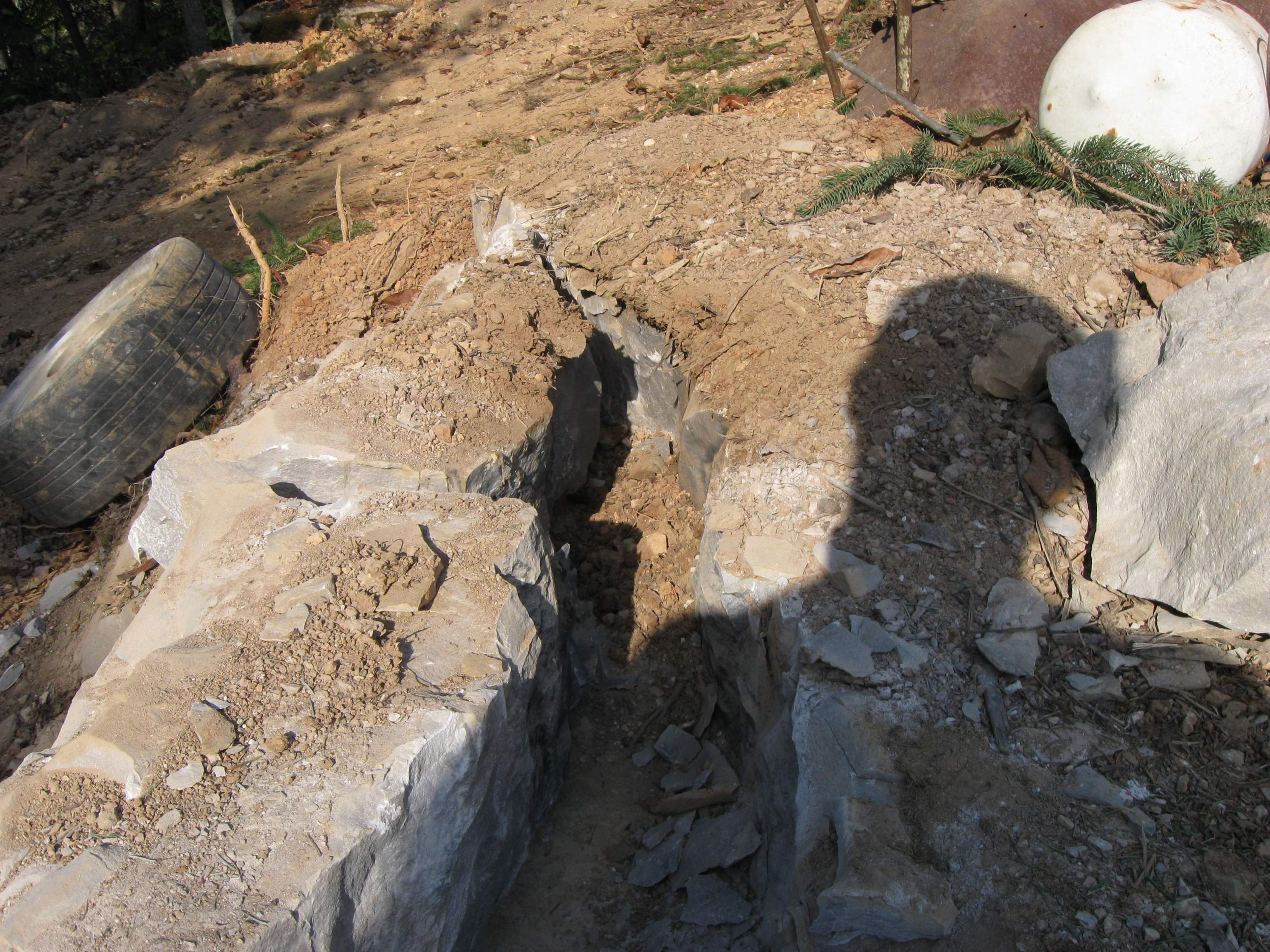

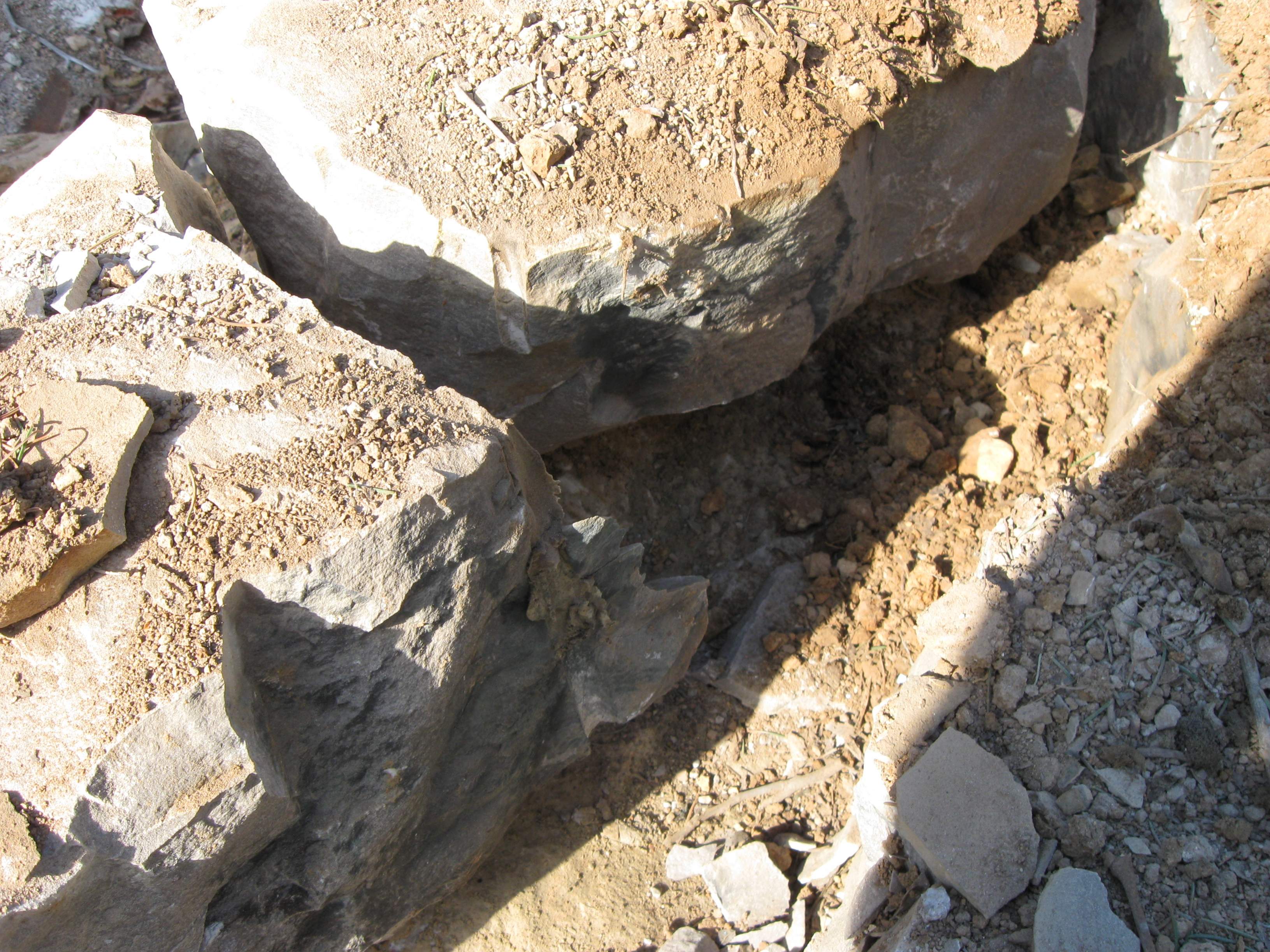

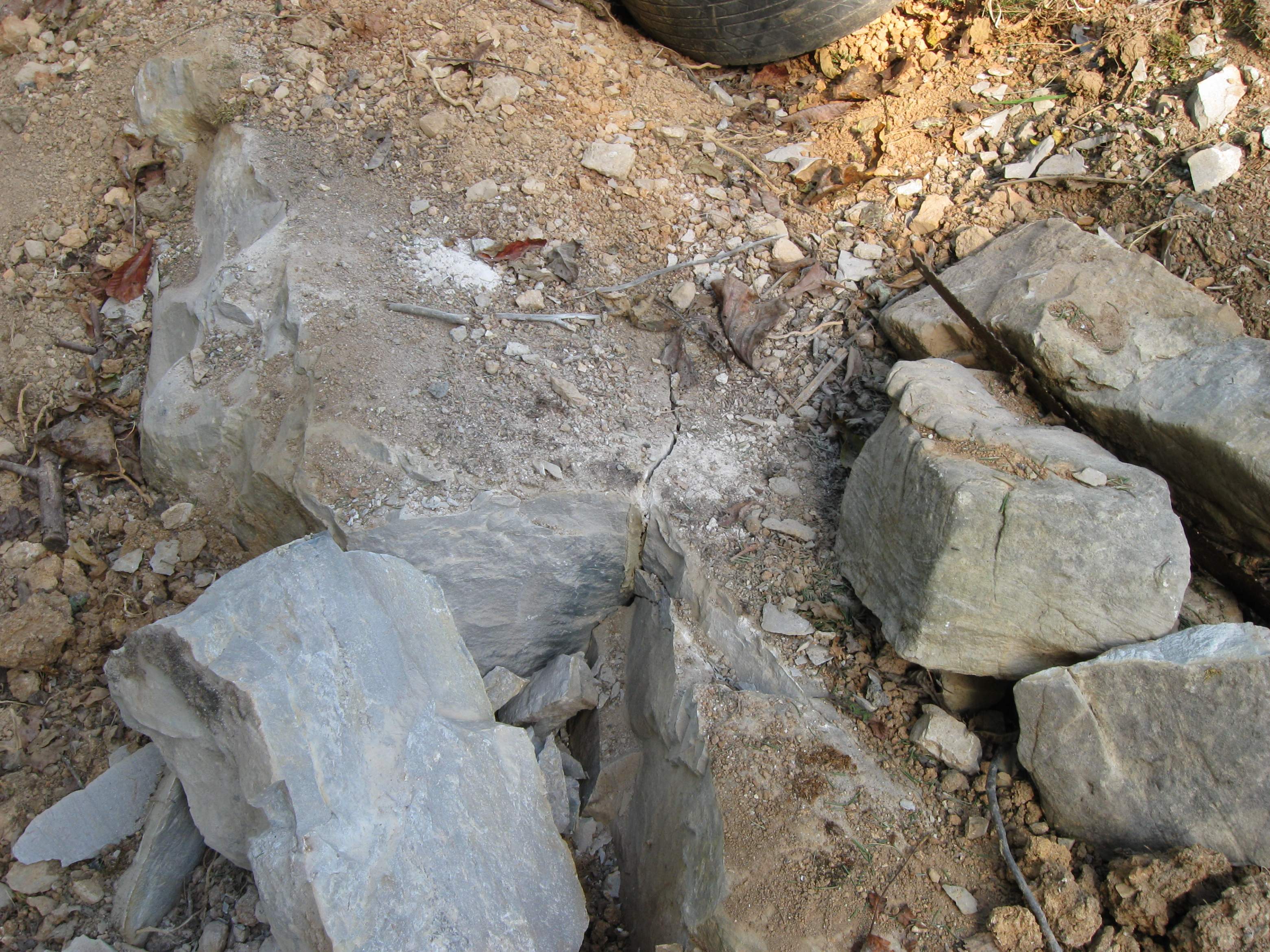

If you're cheap (like me) and don't mind whittling away at it for a couple of weeks (like me) the pyrodex method works pretty well. I had some serious rock in a hill I was cutting away with my excavator. I drilled 1/2" holes about 16" deep, blew them out with air, poured in about 120 grains of pyrodex, stuck in cannon fuse with about 6" sticking out of the hole. I packed in plumbers putty and used a dowel to compact the putty. It has to be packed tight. Once I lit the fuse, I threw a piece of old carpet or plywood over it as a blast blanket to catch any shrapnel that might go flying through the air. Mostly that consisted of a few rock chips so it was nothing significant. I also did it during deer season so most of my neighbors just thought someone was sighting in a muzzleloader.
