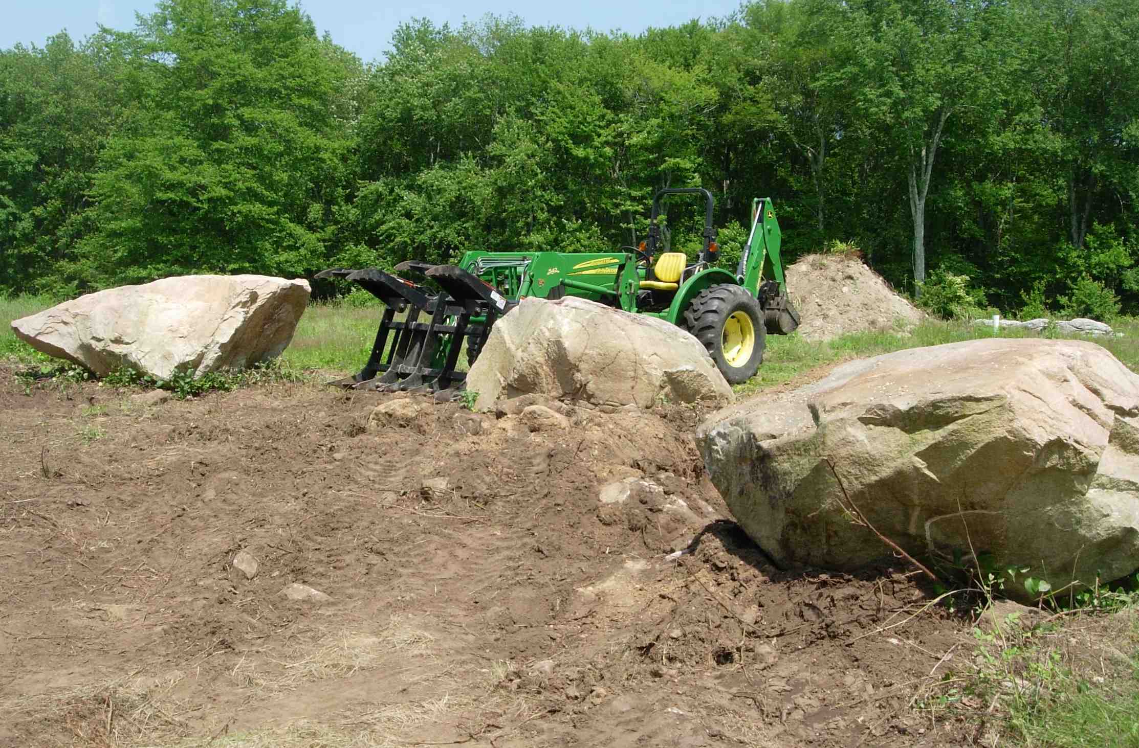

To complete a vineyard project I have 6-8 large rocks(20-40K lbs each) that are on or near the land surface and in my way. I need to get these split down to ~12K lbs for me to dig them out and/or move them. It appears there are rock demo people in my area. Before I get them over to give me quotes I have 2 questions for this experienced group. First, how many methods are there to split rocks of this size and is there one preferred over others? And secondly, what should the cost be per split or per rock? Oops third question. How long should this take? Thanks for the replies.......Gary

I've added some pics below that show (1) largest rock, (2) medium rock, and (3) rocks I can manage with rented 14 ton excavator. My JD 5325 is shown in each pic for scale. As I said before I have 6-8 rocks I need to make smaller so that I can move them with excavator....Gary

Haoleguy,
It looks like you know how to operate machinery pretty good. Why not just rent a hoe ram for a day and break them up your self. Any rental house should have one. Around here a 1,500 lb hammer on a backhoe would be around 300 to 400 for a day before delivery and tax. I rented a takehuchi 175 with a 2000 lb hammer on it for around $800 a day. It was more money but the 500 lb's of difference was worth it.

Whitnel - Good idea! I'm a bit naive on using the hammer.... how does one choose the size for the job? I assume larger means it can break off larger chunks of rock and make the job faster? My local United Rentals might have the Takeuchi 175 hammer setup you described. I will check with them and compare pricing to having a local contractor do the job. Thanks for the idea. ...........Gary
/ Splitting Rock Questions #16
The number is the lbs of force the hammer hits with. The higher the number the bigger the hammer.
I would say you can get by with a hammer mounted to a back hoe. Just ask them what size the hammer is. The 2000 lb hammer I got was a bit of an odd ball. It is the only one around Nashville that I know of. The next size up from the back hoe is usually a 5000 lb mounted to a 200 class excavator. You might find a middle of the road you will just have to call around.
This may sound wierd but it also depends on how hard your rock is. Some rock is softer and breaks up easier. Some rock is super hard and takes more time and force to break up.
