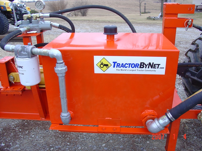

I built mine with a 11 gpm pump. a 5.5 hp motor and a 7 gal steel tank and it works well. I usually run it for about 1.5 hours at a time. (thats as much as this old body can take)
/ Splitter #8
Joe had emailed me about the tank size and I responded to him but wanted to add my comments here as well.
I used a 21 GPM PTO pump. I read several articles that said to use a reservoir equivalent to the pump output. So I used a 19.5 gallong tank. That was a waste. I only added 15 gallon of oil and it barely gets warm. If building again I would use a 10 gallon reservoir with my 21 GPM pump. My splitter was big enough to fit the tank without problems but I just think it was excessive.
I don't think I'd be comfortable with a plastic reservoir. I'm just old fashioned that way. I'd fear vibration breaks or stupid human tricks like knocking a hole in it. My steel tank holds a strainer and my filter plumbing.

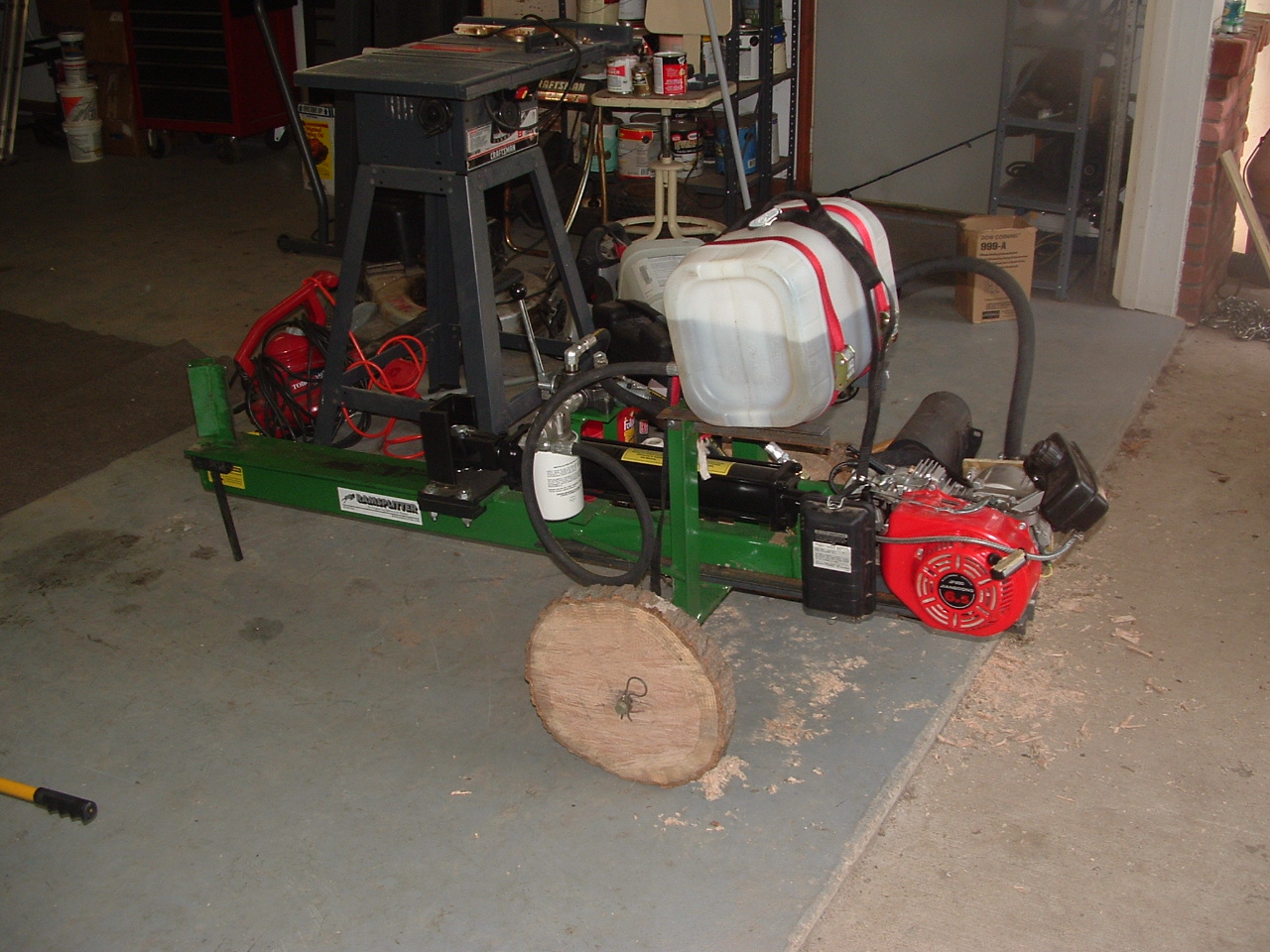

The splitter is complete and works. I used a 5 gallon, thick plastic container for the reservoir. It does get air in it...I think adding more fluid would help.
I will be posting pictures soon, and disassembling for paint.

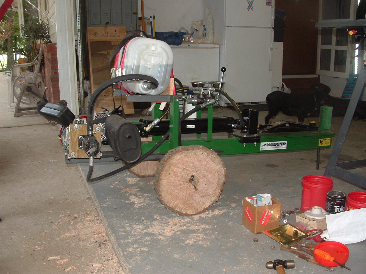

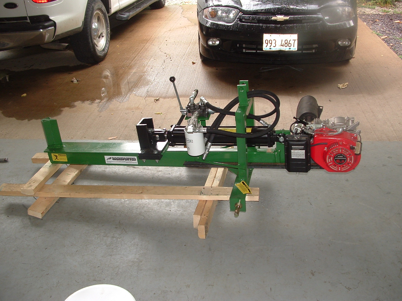

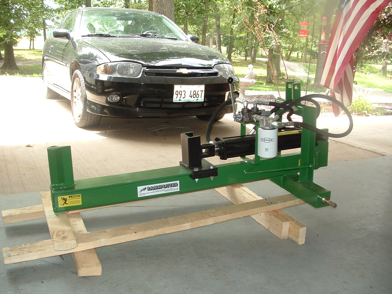

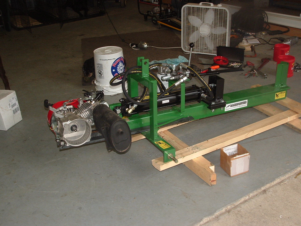

The pics are here. I've since changed the fuel tank and, umm, tires/wheels since these pictures. LOL:D I'll get some new shots soon.
Joe
