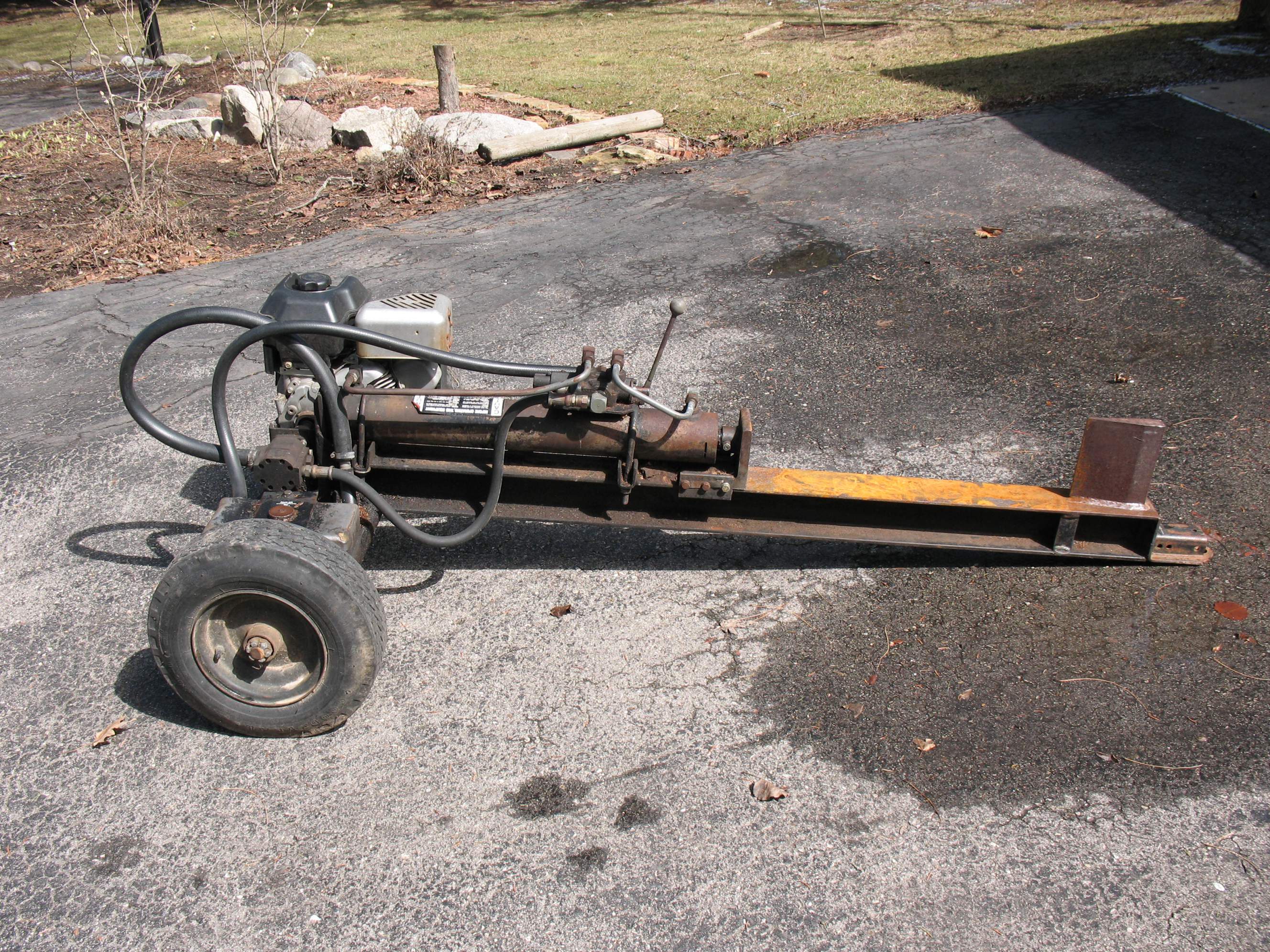

While I agree that a good designed hydraulic reservoir with ample fluid capacity should be used on a splitter there is always something out there that wants to prove us wrong. Back in the 70's Didier made splitters for John Deere , Sears Robuck , Montgomery Ward, and many others with a 1 1/2 gallon capacity and 45 years later 1000's are still working.
That looks almost identical to mine. At least before the PO raised it to waist level. My tank looks like that one, but my measurements calculate it at only 3/4 gallon.
