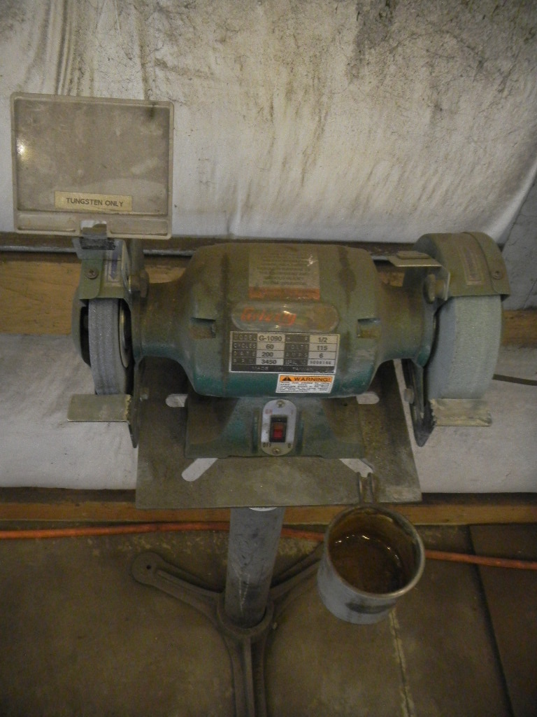

I was taught to never use the side of the wheel, and the company I worked for the safety department would have a fit if they caught you using the side of the wheel. So I use the face. Few years ago I bought a green wheel for my bench grinder, I was going to use it for tungsten but I liked it better for drill bits.
/ split point drill bits #6
Never use the side of a grinding wheel! They may come apart. The Green wheel is designed for carbide but works well on most hard surfaces. It will break down quickly and needs frequent dressing. I prefer a hard white wheel to dress tools.
