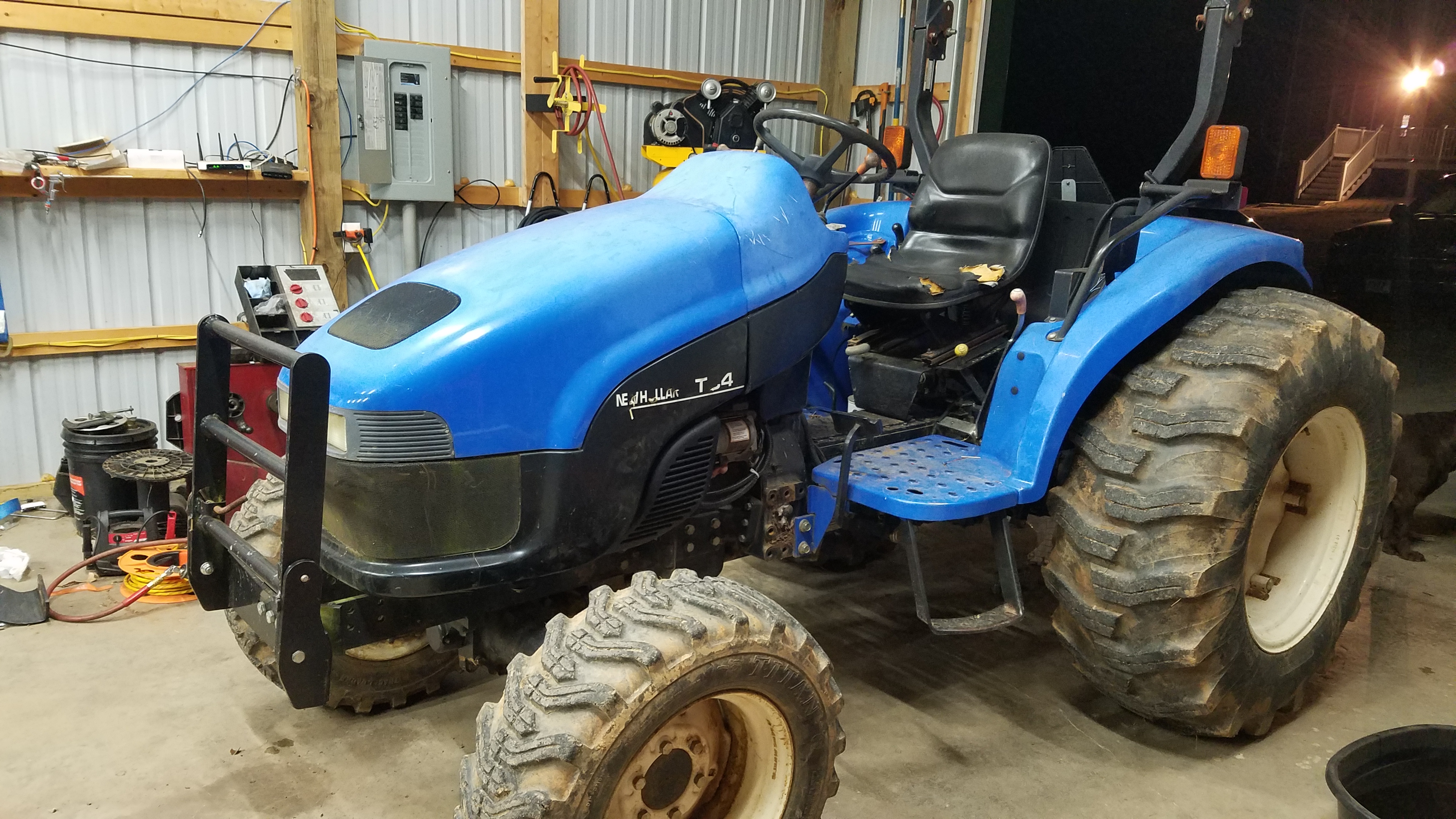

Yeah, I realize it will wear quicker, but I think I'm OK with that - ask me in a year! Ha. Even if it lasts half as long as the original clutch, it will be good for 5 years, probably.
The new release bearing is dimensionally identical to the old one. I don't think there's a good way to shim the bearing on the hub.
According to my micrometer, I shimmed it 1.68mm.
I initially tried .84mm, but it didn't work. I think the release bearing was pressing the fingers in far enough to release tension, but the fingers were then making contact with the clutch itself, which obviously isn't a good scenario. Not sure what other option I have with the current parts, besides sending them back and sourcing something else. I don't really want to shell out the cash for New Holland parts (>$750 for the clutch, pressure plate, and release bearing - while I paid $250 for my current setup). I'm just going to roll with it. I'll get it back together enough to do a test drive in the next couple of days, and if all goes well, I'm done with it.
On the positive side, my alignment tool worked great - both shafts slid right in without issue!

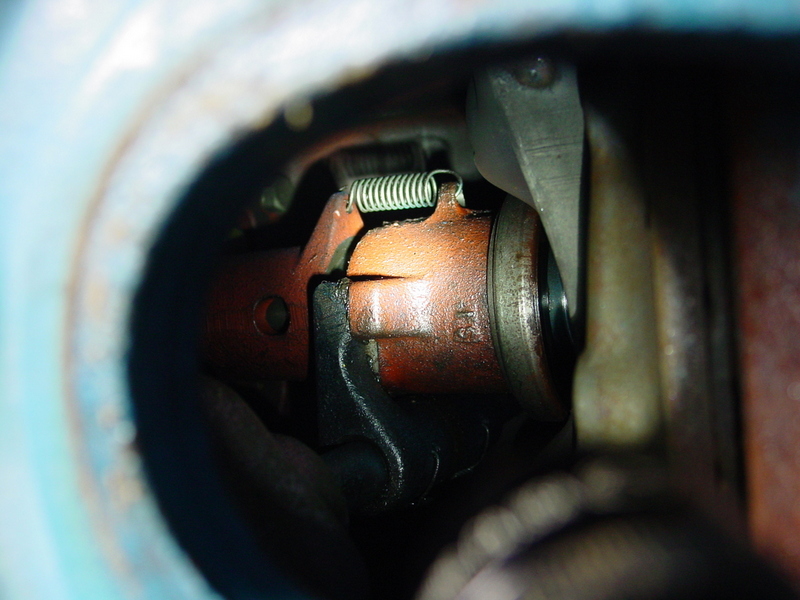

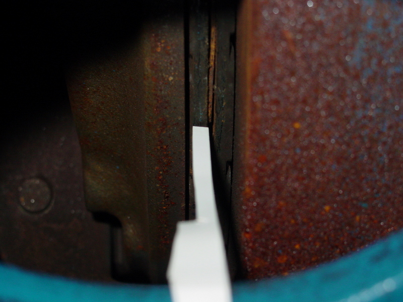

Great, you are a well informed individual and do the risk benefit analysis. Depending on the operator and use of the tractor the clutch can last a very long time. My 40 year old Ford 1700 has never been split for a clutch change and I still have more than 90% of OEM disk thickness left. I think you will be fine if you check it under load and if it did not slip. Rubber covered inspection hand hole on the side of bell housing is an awesome simple design.

I had a few minutes to spend on it today and all's well. I got it back together enough to do a test drive and the clutch felt great. It's no longer "slip...slip...go", but now "grab & go". I got the body panels back on tonight. I still need to get the FEL subframe reinstalled.

Got the tractor out and moved a bunch of round bales today without issue. So, it sure seems like "mission accomplished".
