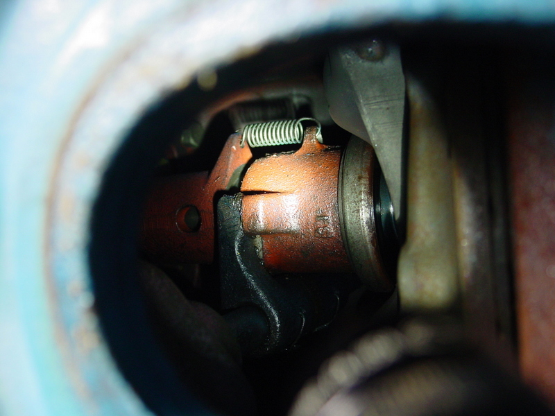

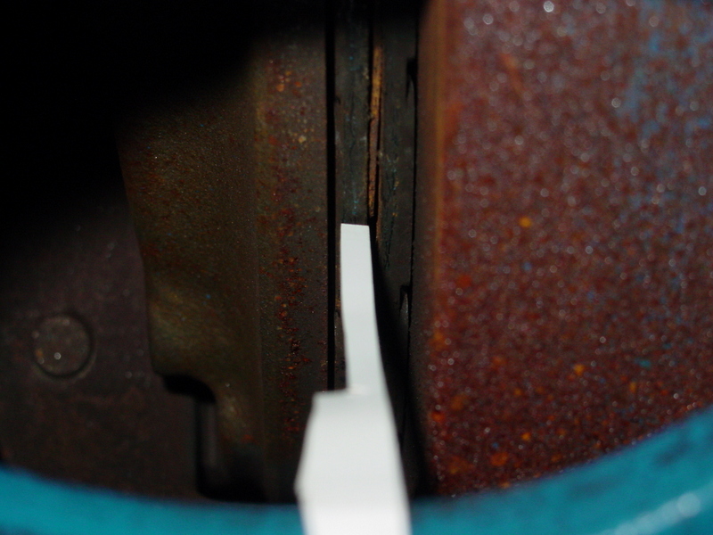

Great, you are a well informed individual and do the risk benefit analysis. Depending on the operator and use of the tractor the clutch can last a very long time. My 40 year old Ford 1700 has never been split for a clutch change and I still have more than 90% of OEM disk thickness left. I think you will be fine if you check it under load and if it did not slip. Rubber covered inspection hand hole on the side of bell housing is an awesome simple design.
