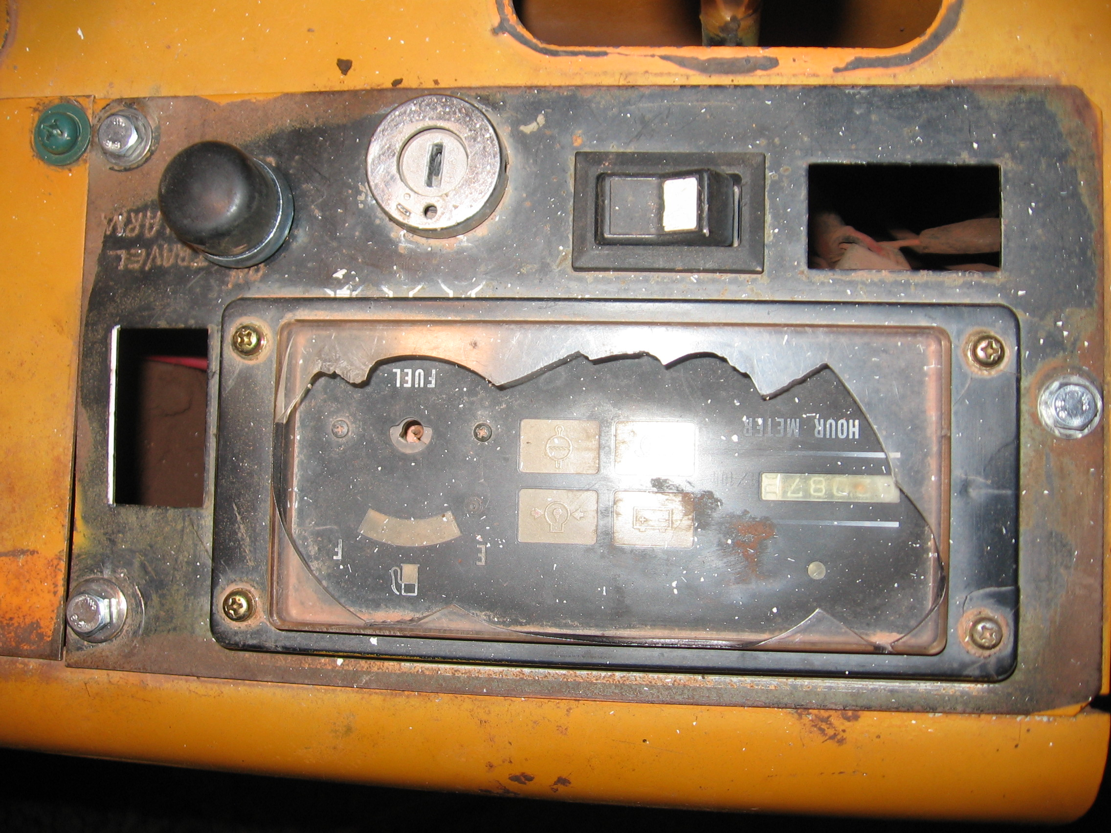

I need some Rocker Switches for the instrument cluster on my Mini Ex project.
STSP, 15a or 20a, lighted or not. Need (4).
I would like them to fit the existing holes in the panel, so I don't have to fabricate adapters & such.
Problem is, I can't find anything to fit the existing holes.
Depending on your measurement preferences:
.940" X 1.690"
15/16" X 1 1/16"
24mm X 43mm
Plenty of depth available, panel is .063", 1/16", or 1.6mm thk.
Any ideas?

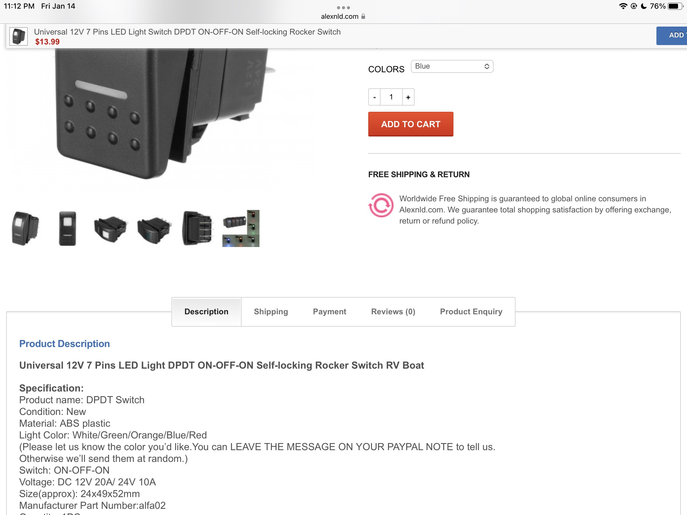

The last time I needed an odd size switch I found it on eBay. Amazon may be another option.
   / Source for odd size rocker switches?
Tried both of them; lots of switches, but none that fit those holes.
Also tried Auto Zone, O'Riellys, Napa, Graingers, Surplus Center, Cycle Gear, Ace, HD, Lowes.:cry:

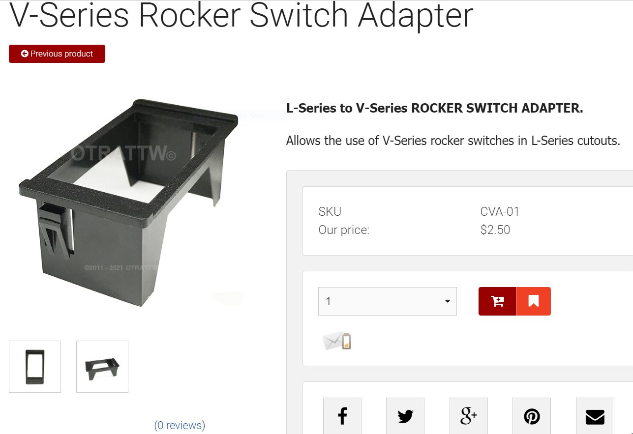

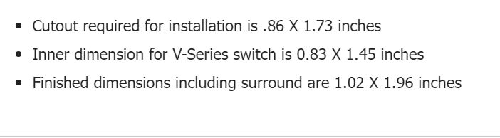

Closest I've seen yet, but I wish they had published the actual hole size necessary, rather than the OAL dimensions of the switch.
