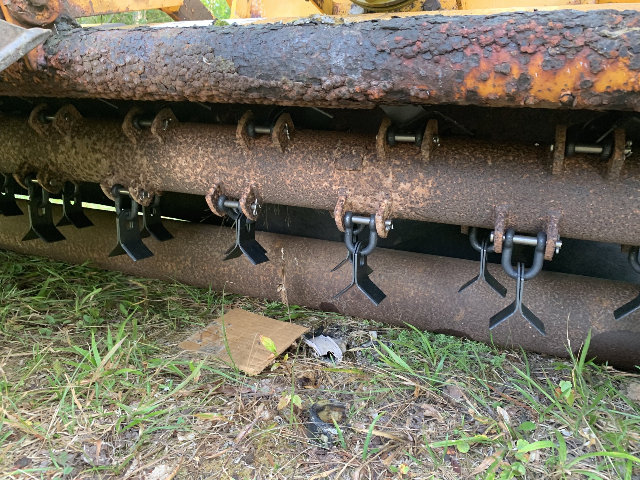

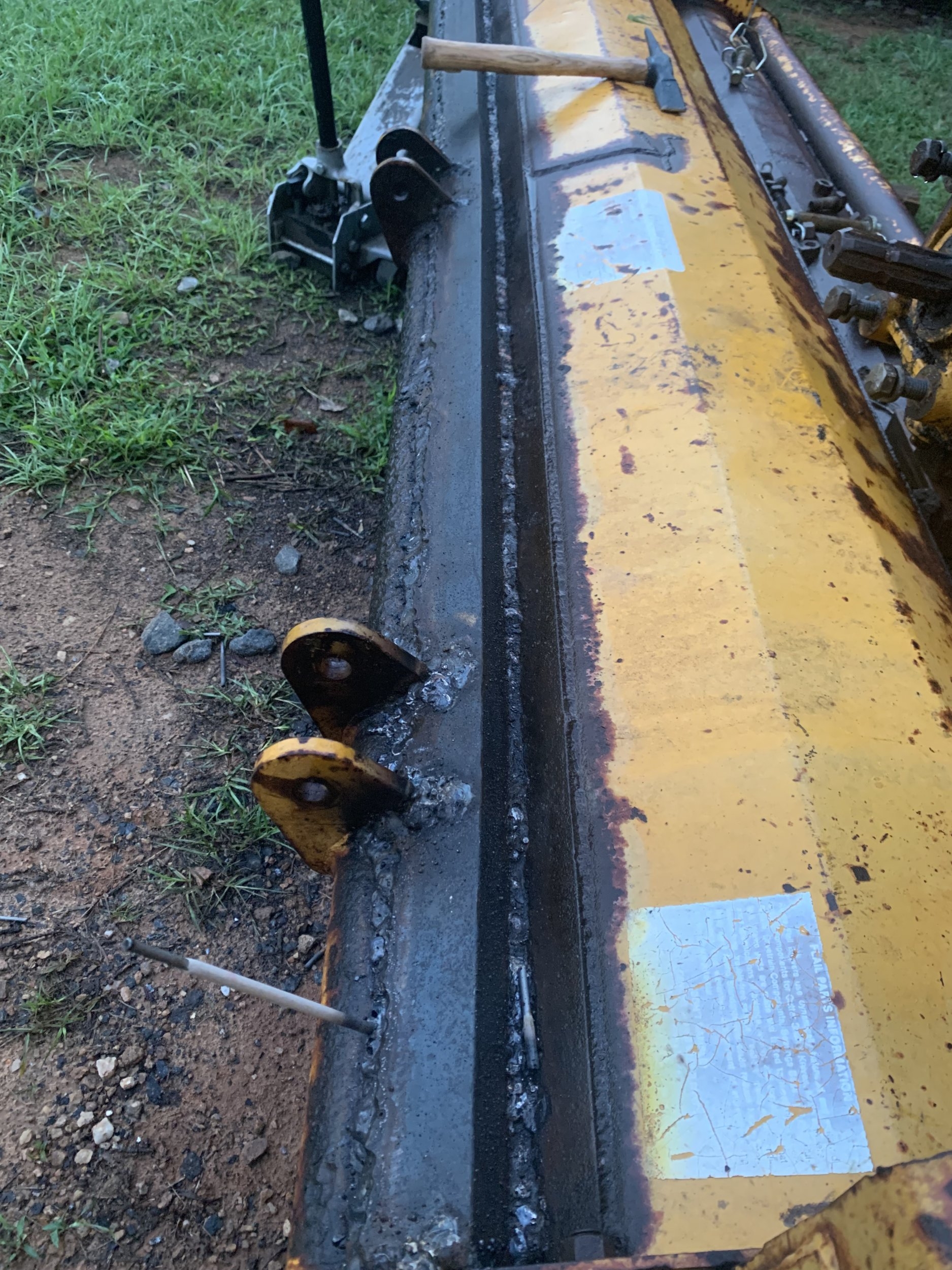

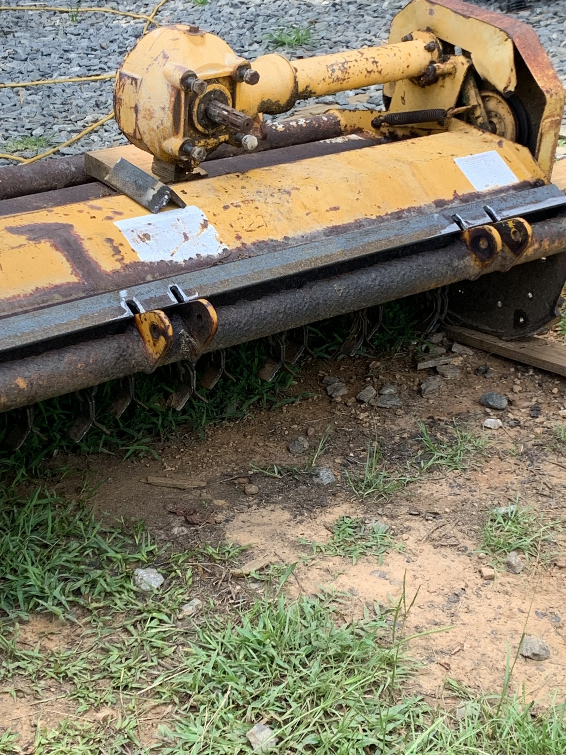

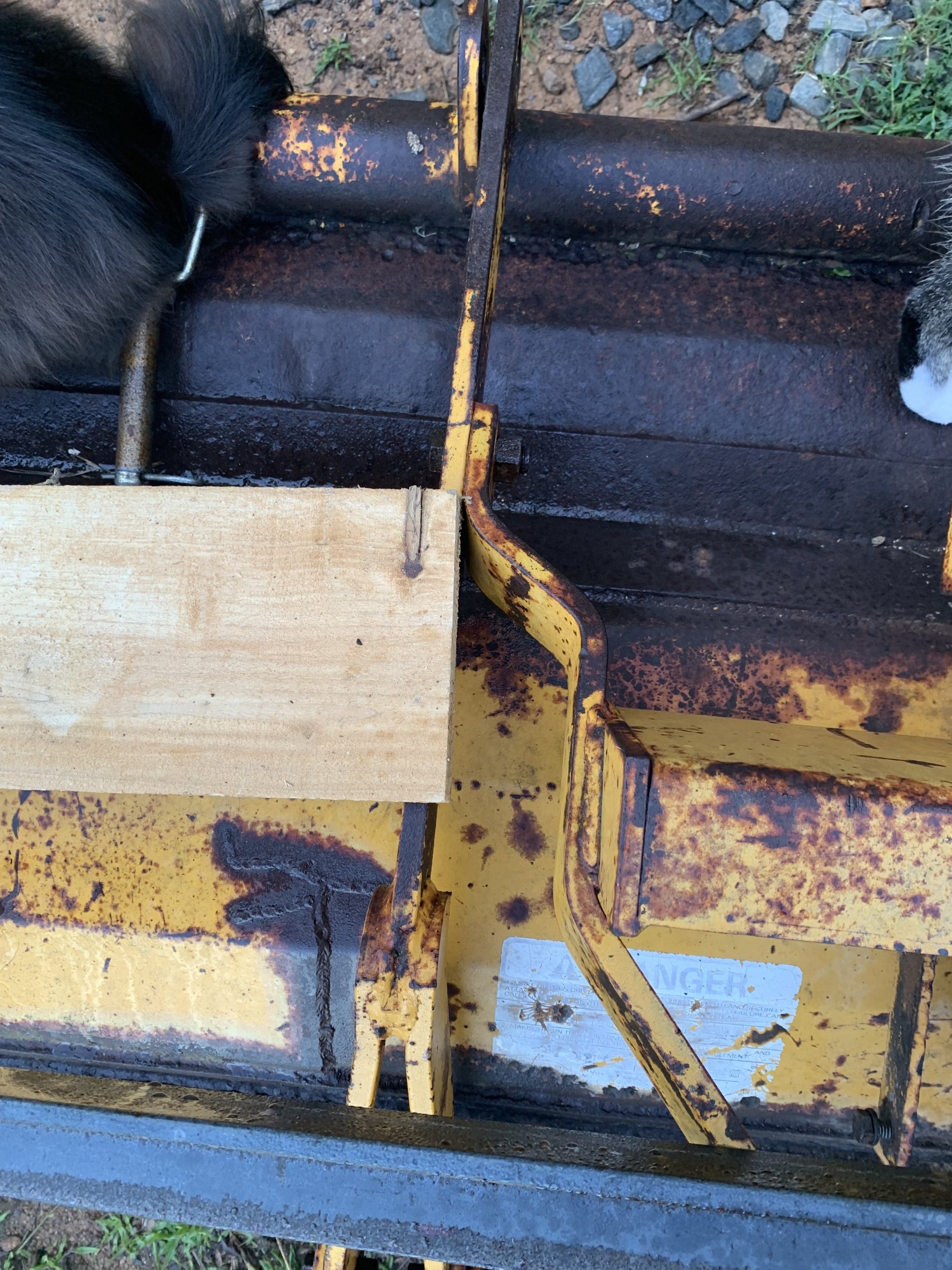

I just wanted to bring an update- based on the advice here, I contacted Flailmaster and they were absolutely dead-on helpful. I ordered 125 HD forged knives M-108381 from them, and also 100ea grade 8 7/16-20x3-1/4” cap screws and lock nuts.
What a difference in capacity the HD forged knives made. they’re more than double the thickness as the heaviest stamped knives (.1015”) at .2225”Working to tame some heavy overgrowth that included many sweetgums, I havent lost a pin, shackle or knife since mid-july.

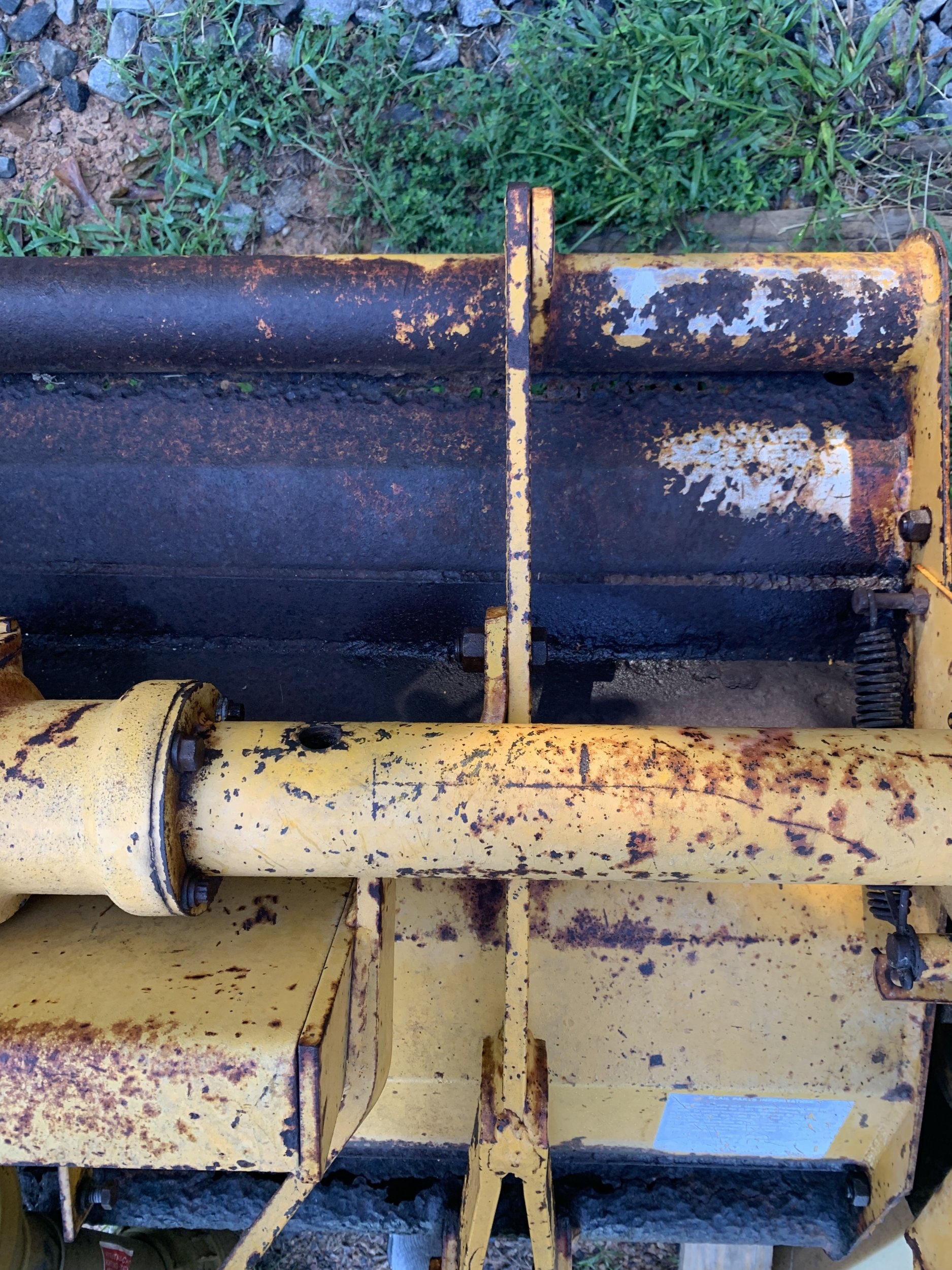

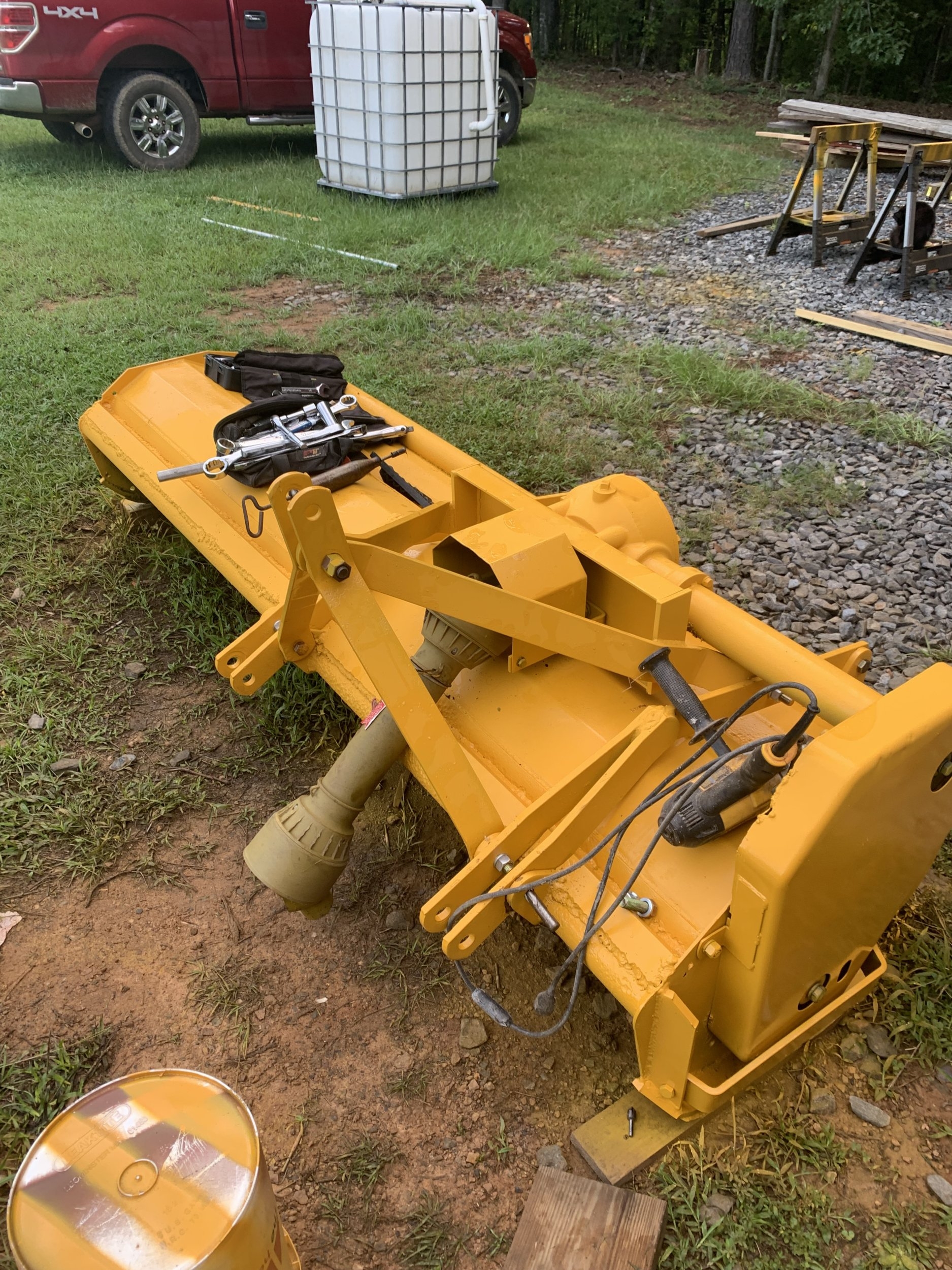

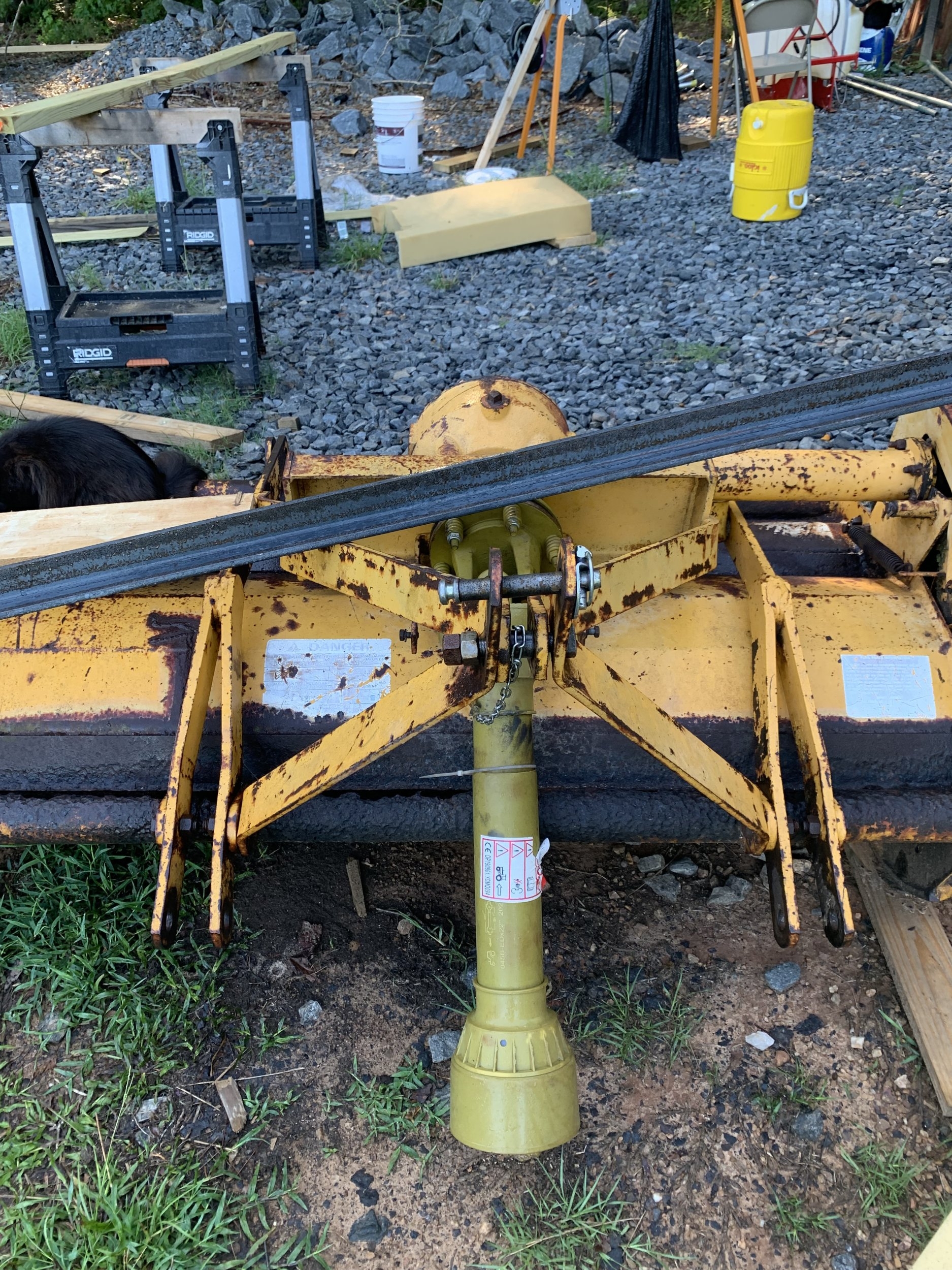

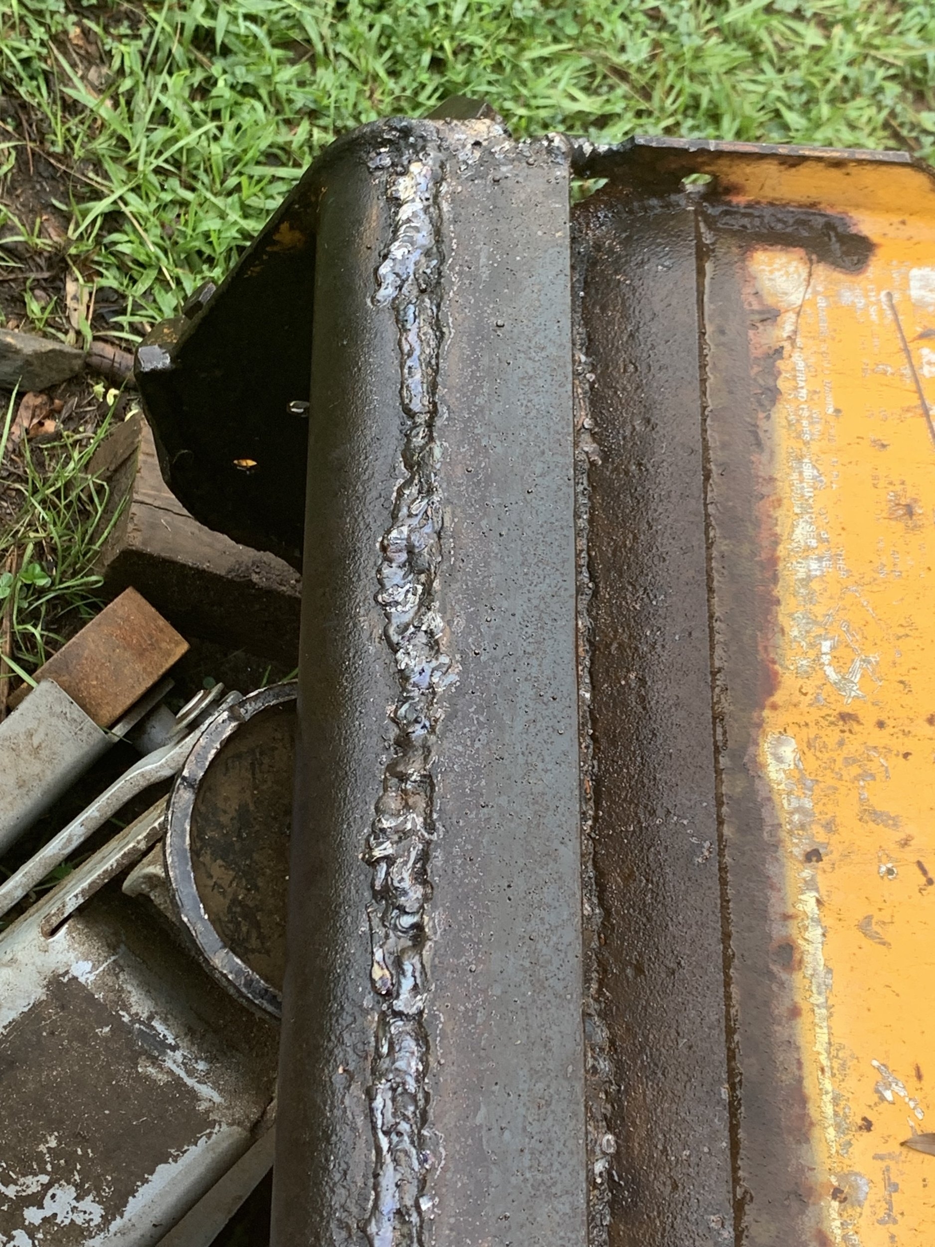

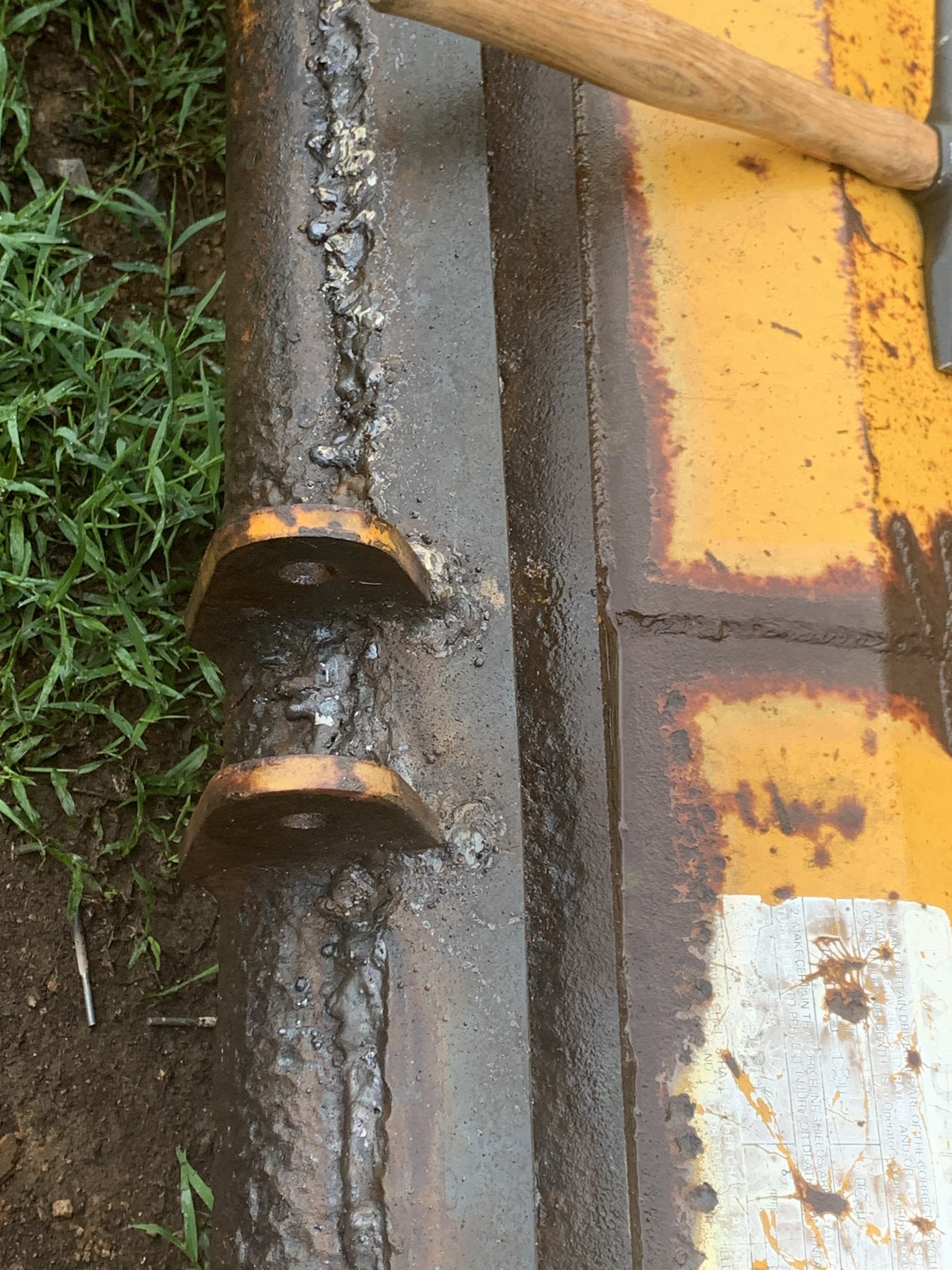

I had to take a break to reinforce the rusted front tube support, and decided to repaint while I was at it. I am not a pro welder or painter by any stretch of imagination, but the weld held and the paint looks great from the highway.
if anyone has a stencil for the alamo logo, or a link to vendor who does, I’d like to add it back to the new yellow beast:)
