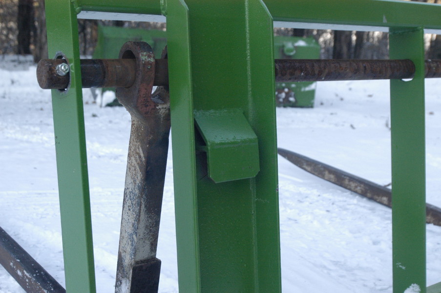

does anybody have close up pictures of ones they have fabbed?

This is the one I was looking for from user HookBlock in THIS thread.
Thanks!! That looks solid and easy enough to fab. I did find them on JDparts.

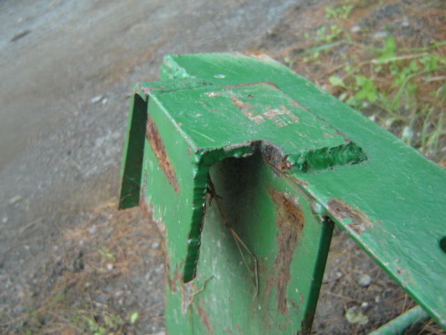

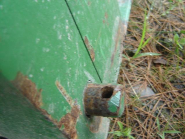

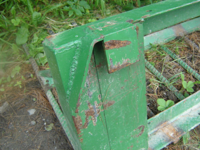

I fabricated mine with some 3x5x1/2 angle over the top of a frame used to support my Snow Blade. Going on 5 years now and I have had no problems. I reinforced the sides with a piece of flat bar also used to force the arms into the hooks if a little out of alignment. The picture is a little fuzzy, I could get better ones tommorow. I have since built 2 more sets for a bale spear and a rock bucket I built.
/ Source for Deere Quick tach mounts #18
A better picture would be great and I am sure it will help someone in the future.
/ Source for Deere Quick tach mounts #19
A little better pictures, I am no photographer. I was a little off on the angle dimensions. It was 3x3x1/4 angle that I used. 1 1/2 x 1/4 flat par for the sides. I have a 790 with a 419 loader. I copied the design from my frontier pallet forks. Theirs has a 2x1/4 flat bar wraped over the top of the angle to help reinforce it, I don't know why I didn't do that.
