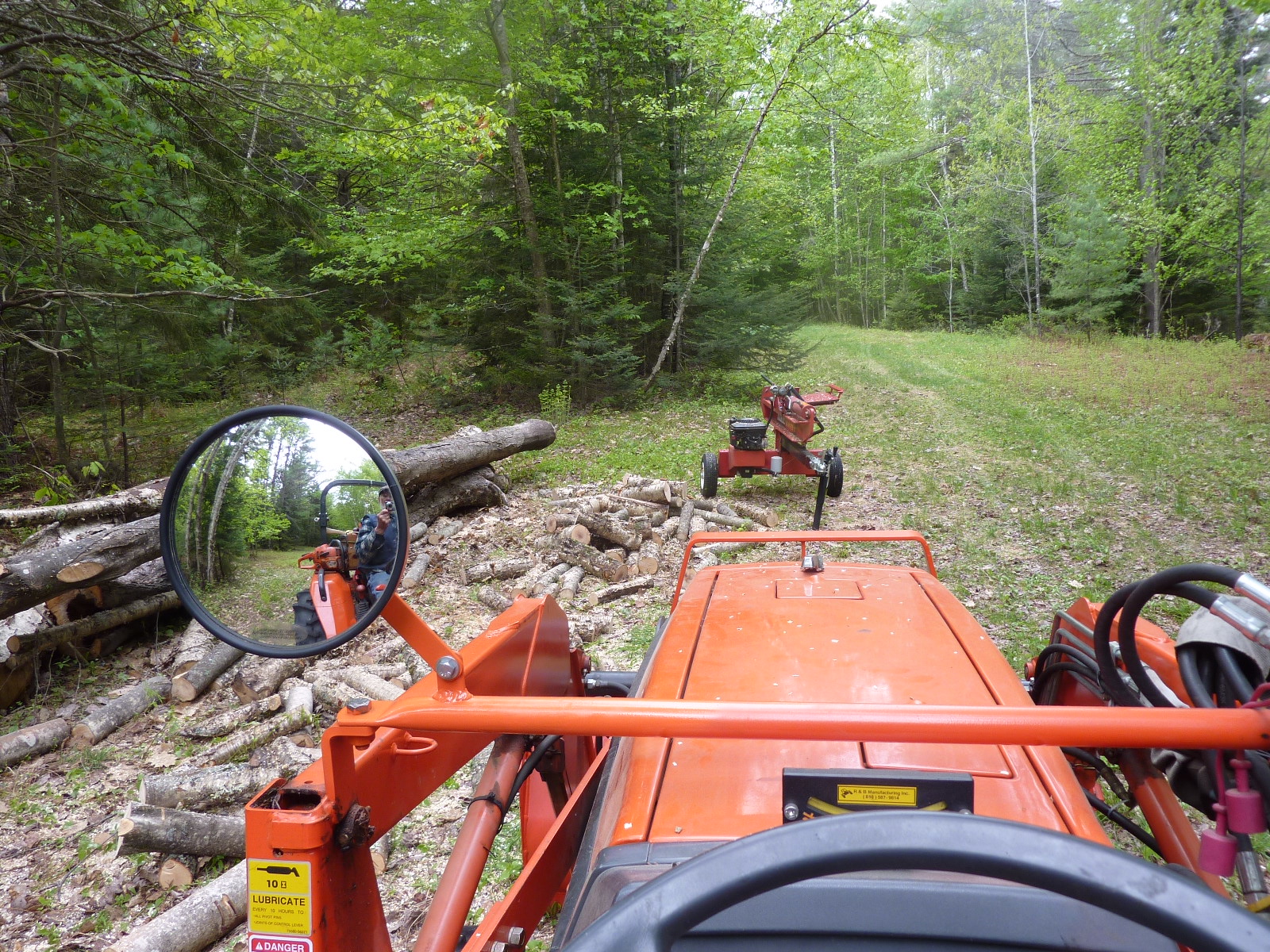

I put mine here on an L3010
gg

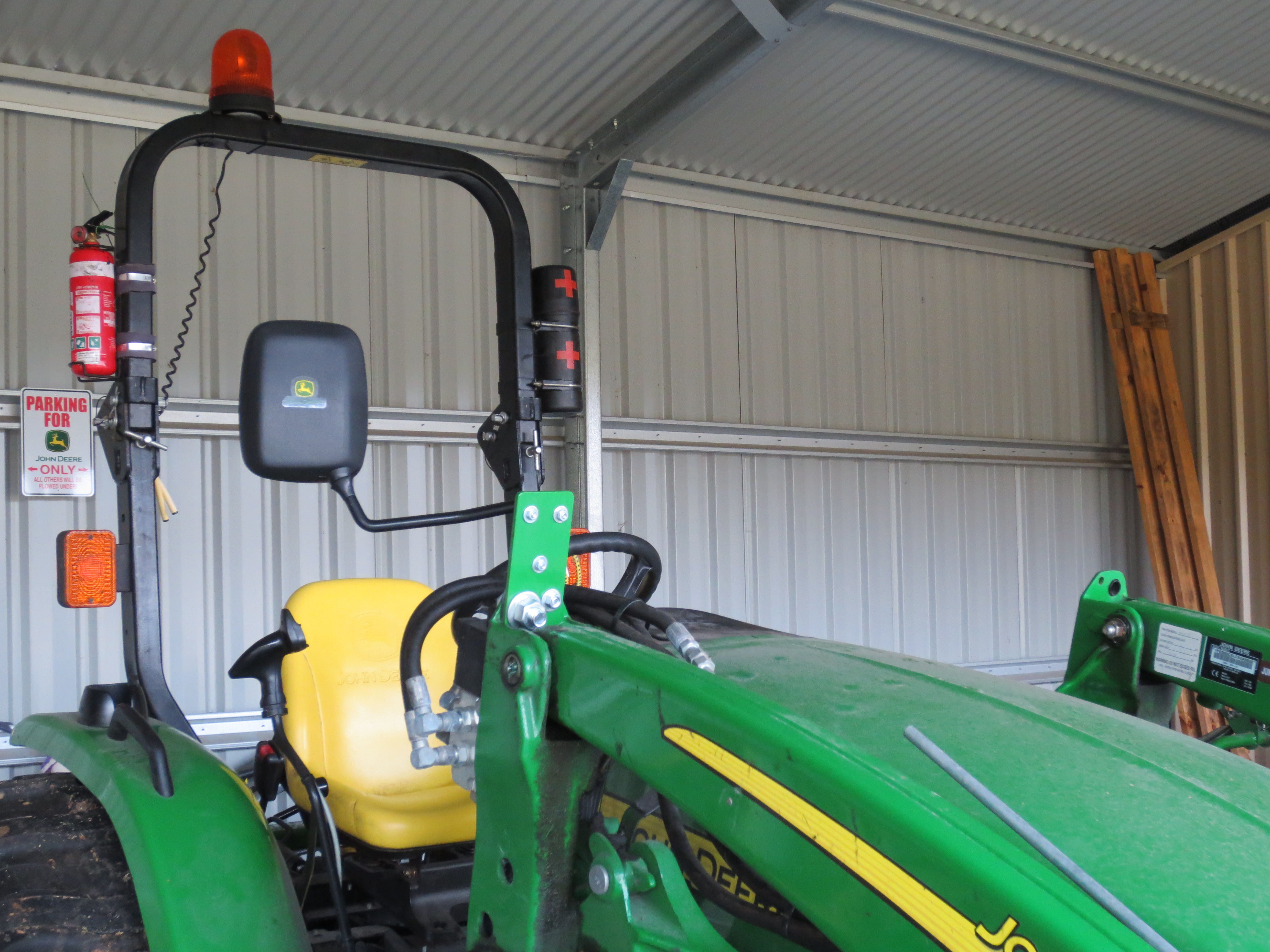

Where have you guys mounted the mirror? I have a Kubota L2800, fel, no cab. I have a nice sturdy mirror from a forklift but never could determine a good place.

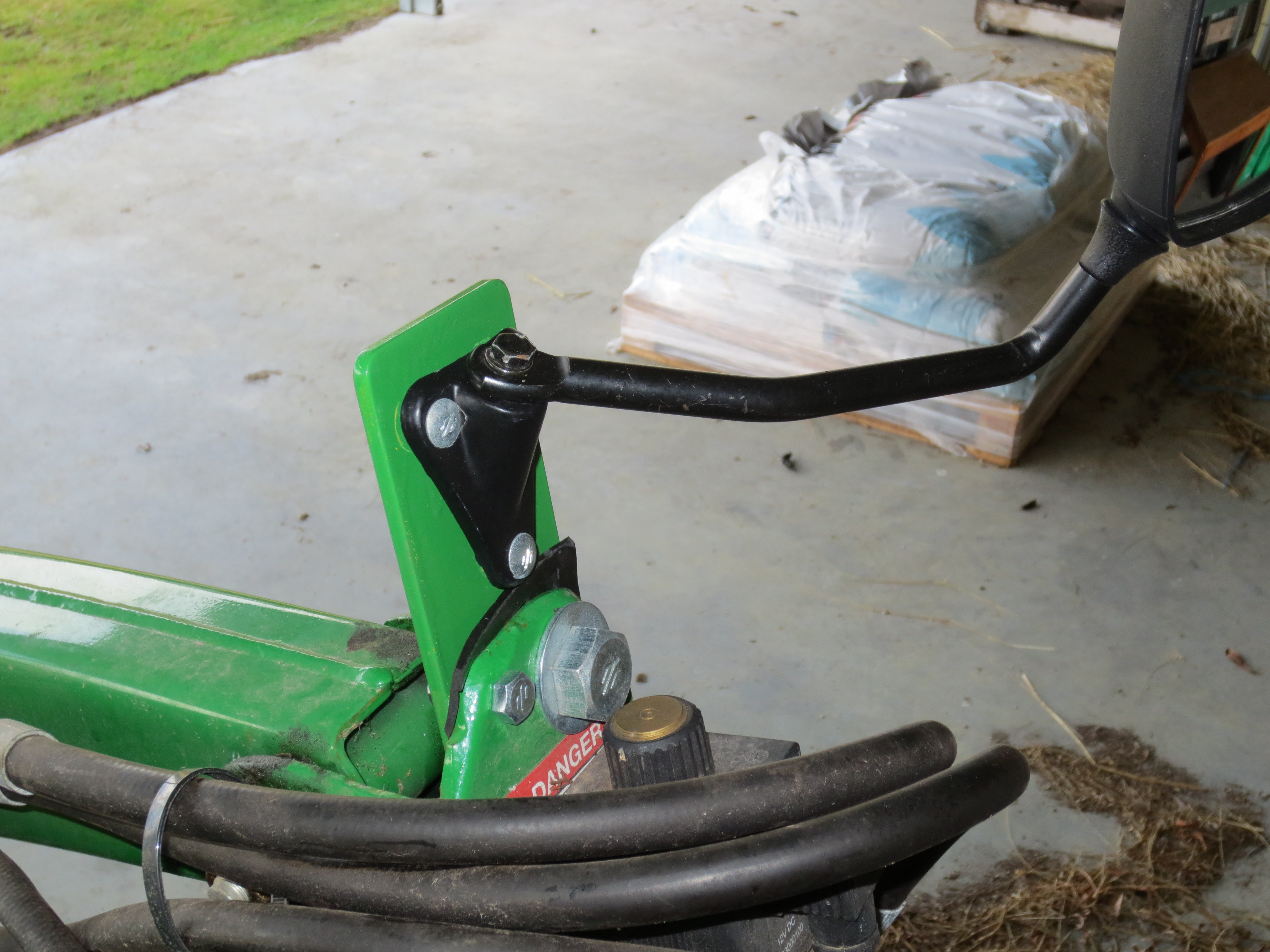

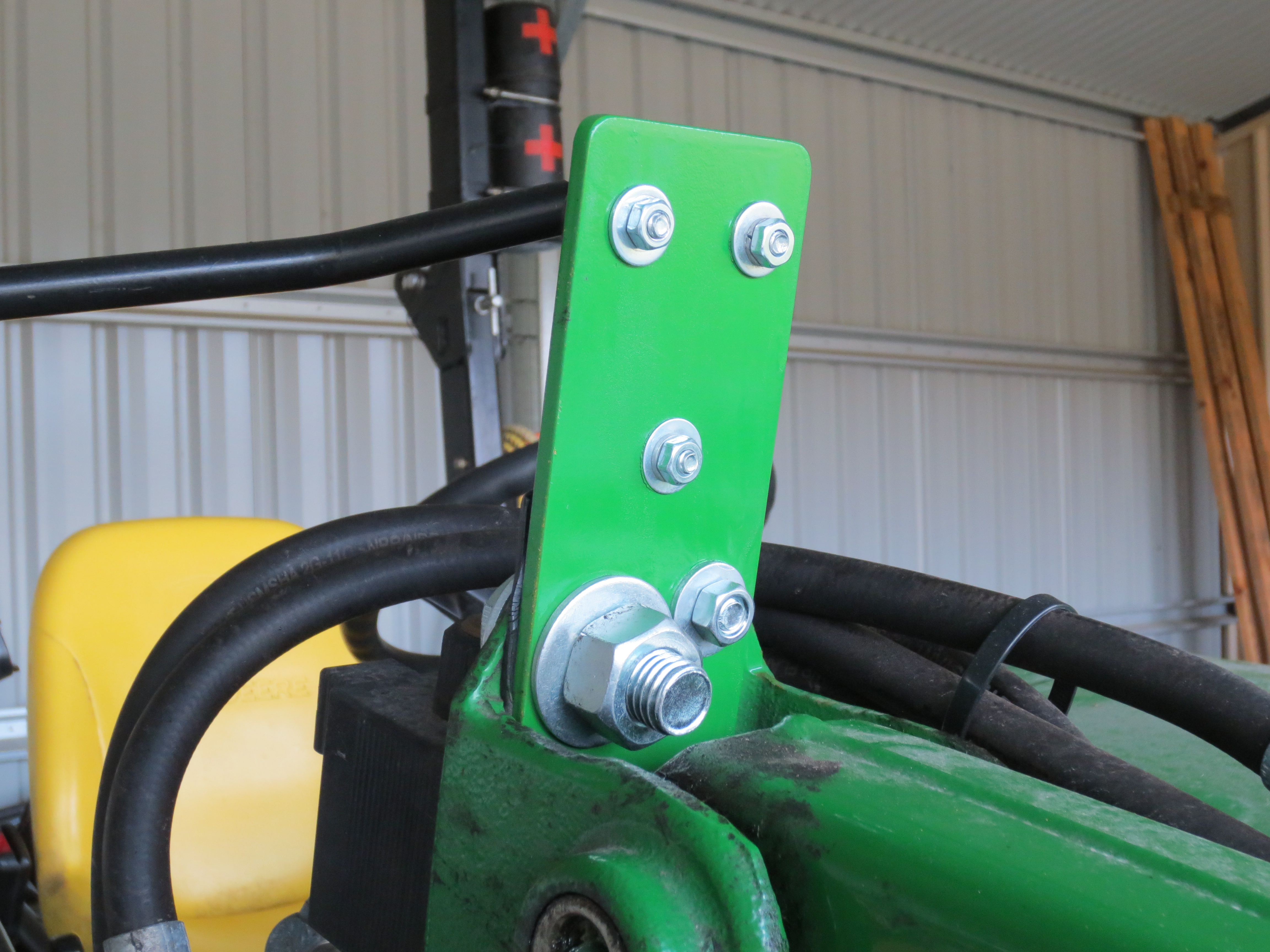

I can't speak to your FEL set-up, but here's where I mounted mine (on the right 'cause we drive on the left). I had to have a mounting 'bar' manufactured at a local metal shop, then I painted it JD green IOT look like it's a stock set-up. The mirror is a generic 'van' replacement from the local auto-parts store.
