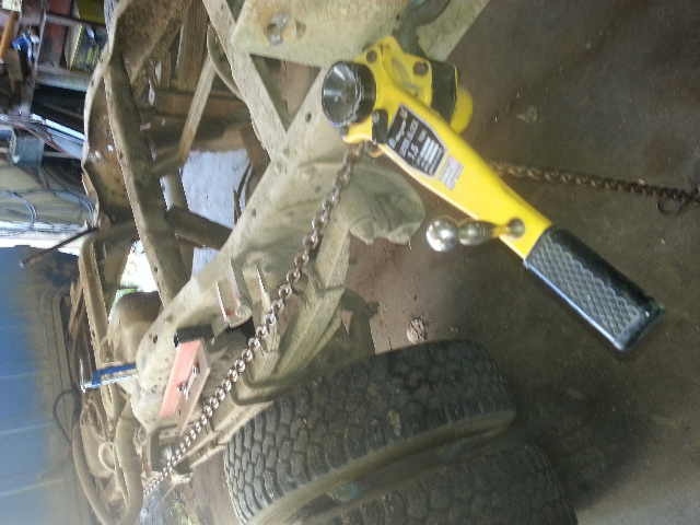

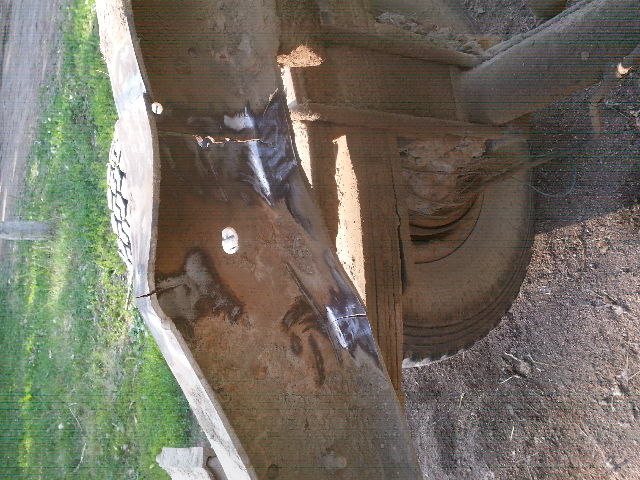

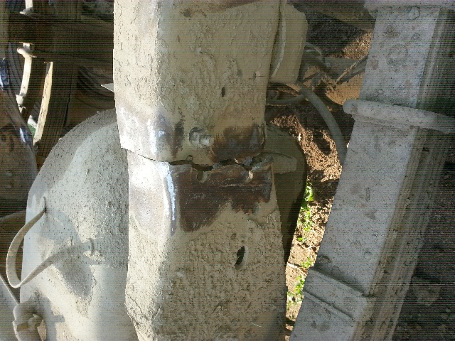

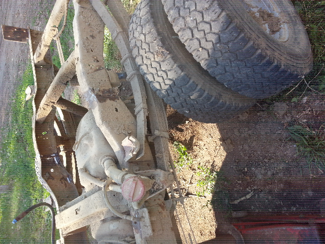

My neighbor brought me his bale truck and asked me to fix it. Both frames are cracked. One is cracked all the way through and the other side had about an inch of frame that isn't cracked. I offered to change the frame but he didn't want to spend the money and I don't blame him. For what the truck is being used for a repair will do an adequate job.
The first picture in the attachments is supposed to go here.

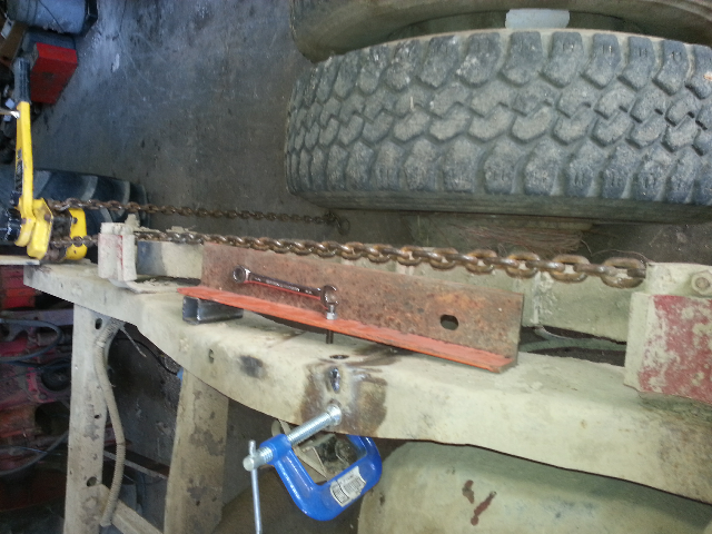

Here I'm starting to get the frame lined up.
This is what i did to pull everything into place.

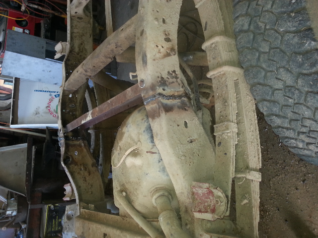

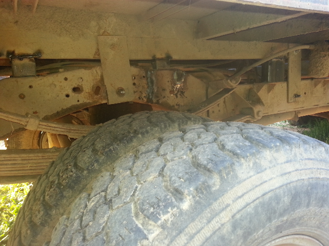

Finished product and i added a cross member as i figured the reason why the frame had cracked was because it was flexing in every time a bale was picked up.
I also added blocks between the frame and the bake deck to help support the load.
We will see in a few years how this holds. The truck isn't registered and only gets used in the fields and corrals.
   / sometimes i get interesting jobs. #3
If those plates were all that transferred the load to the frame, that would explain why it cracked.
That is a normal Dewese method of mounting bale decks and there are a lot of decks out there mounted like that. This is not the first one I've seen cracked but there are a lot that never crack.
The decks are mounted by solidly bolting the rear of the deck to the frame and then two of these plates on each side to transfer the load to the frame.
The truck is a first generation 250 Cummins that has been converted to a dually with adapters on the rear axle. I haven't done any measuring but I wouldn't be surprised to find that a Dodge 350 has a deeper frame. I drive a 90 250 Cummins for my work and have a 91 for parts. The frame on the 91 is an inch deeper.
