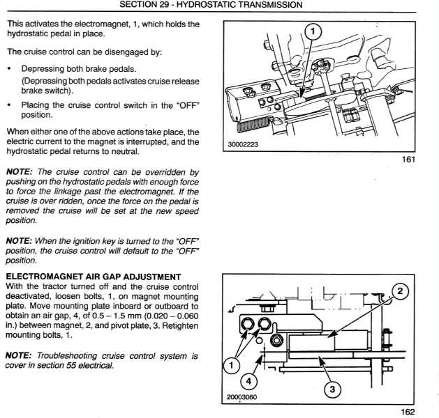

Check for grease/oil on the plate where the magnet attaches to control speed. Clean with acetone. At the very end of the pedal travel the return spring is exerting maximal return effort. I'm not sure I'd want to activate cruise control at max speed, however - just a personal choice.

Chris; Thanks, I'll slink underneath tomorow and take a look. If it looks like I may have to disassemble too much, I think J&R will get a call Monday. /forums/images/graemlins/smirk.gif

To the best of my knowledge you can check the cruise control circuit without the engine running. Make sure your parking brake is set. Stand beside the tractor and turn the key to the on (run) position, push down on the forward or reverse hydro pedal with your hand and activate the cruise switch. The magnet should now hold the HST pedal captive.

</font><font color="blue" class="small">( Check for grease/oil on the plate where the magnet attaches to control speed. Clean with acetone. )</font>
Chris, Tthat's exactly the advice I was planning on giving as I read this thread. I've been away from the computer all day and checked in a few minutes ago. I saw this thread and was "itching" to reply, but you've said exactly what I suspected. I guess the connector could have come loose, but if that were the case, John would have no cruise at any speed. I think grease on the plate or too wide a gap could be the cause of slippage. On a new tractor, I think grease is the most likely culprit.

Chris; Where did you get these drawings? It appears they are out of the mega-buck shop manual. Nice to have thing. /forums/images/graemlins/smirk.gif

John, I'm not sure Chris feels this way, but that repair manual has been worth every penny of the high price to me. I haven't bought the CD version, but my paper copy has served me very well. I'd also recommend the Illustrated Parts Manual. For some things, it shows extremely good detail.
I also just noticed that Chris recommended using acetone. If you do use this to clean the "B" shaped plate, I recommend you use a rag wet with acetone to wipe the plate clean. Acetone will instantly melt paint and plastic if you inadvertently splash something. I think I'd use a strong solution of a purple cleaner like SuperClean first. If you have only a light coating of oil/grease, this cleaner will be a lot safer than the acetone. Also, remember that acetone is extremely flammable. ...just a few thoughts. /forums/images/graemlins/smile.gif
