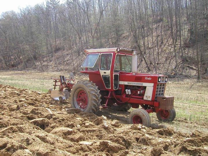

I know exactly the type of soil you are in, for the past two years I've been trying to turn ground over that was in CRP for twenty years. It can be very frustrating and I've experienced the same things you are describing. The coulters will help some, ground speed is important, you go to slow and the ground will flip back into the furrow, plow setup is critical, and also the condition of the share and shin. There are shares that work better than others, the deep suck share works well in hard ground.
I'm not sure how much plowing you've done but setting the plow up so it works correctly is almost an art.

You said a mouthful.... "Like solid rock".
Way back when, in the day when plowing was still a routine event, there were more options as far as plow designs. In conditions like yours, a plow share called a "deep suck" share would be used. They had an extended point that dug in and helped pull the plow into the ground. They're virtually a thing of the past. You'll occasionally find them on some antique plows, but they're a rare commodity anymore.
A plow with conventional shares needs to have GOOD, relatively NEW shares, not ANY wear, if you're attempting to break "old ground". They need to have a nice sharp edge. The plow needs to be adjusted near perfectly. And it helps if there's a bit of soil moisture. DRY, hard turf is darn near impossible to plow.
When I still had my farm, I had a 10 acre field that I'd grow a corn/soybean rotation on. The first couple years when I started plowing it, a plow wouldn't much more than scratch the surface. Afte a few years, and a couple rounds with a subsoiler, I finally got it where it was tillable. But for the next 30+ years, it STILL had hard spots. Some ground IS "just like solid rock".
