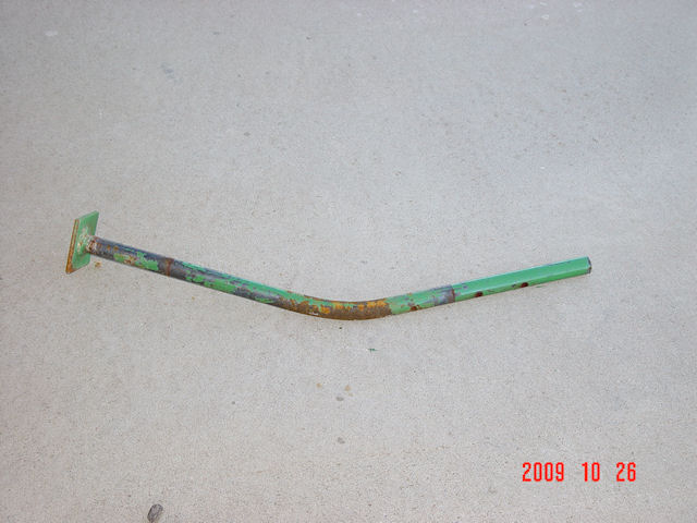

I like the parking stands - nice job. Did you drill a hole in the bottom so water will not collect in the pipe, causing it to freeze up and burst? Don't ask how I know about this. :eek:
   / Some new additions to my snow equipment for the season #7
Be sure to paint those parking stands a contrasting high visibility color as a reminder to make sure they're raised.
That Deere/Frontier/Woods rear blade parking stand is solid 1" round-bar. The replacements I made are Deere yellow.
Good point, even though my implements are are stored inside. I will add that when I paint them this spring.
Wow, that took a lot to bend 1" solid bar. I will take the advice, even though I triple check everything before I pull away. It doesn't hurt to have the visual color difference also.
I was physically and mentally tired when I bent the stand, so any redundant checking I'd normally do went out the window.
Deere/Frontier/Woods wanted $40 for a replacement stand. I made three and had them powder coated yellow for about the same cost. That way I have two spares in case I frak up again.
