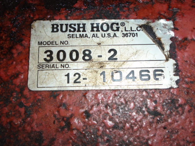

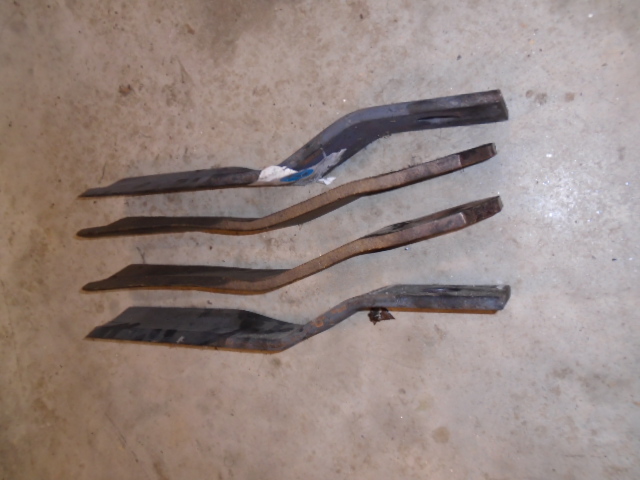

I've had a bunch of "bush hog" mowers over the years, from cheap to expensive. Right now I have a 8' twin spindle Bush Hog brand HD 3pt mower where the blades have about a 2-3" drop in them from the mounting surface. I replaced them with the correct Bush Hog brand blades and in very short order, they were bent upwards and cut like crap. I've never seen this before and am thinking about just putting a flat or straight blade on. I called Messicks (where I ordered from) and never heard back from "the right guy".
FWIW it's a model 3008-2 and in the pic below are my old blades (I bought it used) and the new, uninstalled blades. i
In under 10 hours the new blades look the same.
I've never had this happen on any of at least a half dozen mowers before.

Hmmmmm..... Why is that happening? Makes no sense. In theory the end of the blade should pull downward. If you scalped the ground I guess the end might be forced upward because the pan wouldn't be taking part of the impact?
I always thought the large drop blades would be harder on the swivel pin. And I always thought they might pull a little easier because nothing is hitting the inner blade or pan?

I can't figure it out. A good friend said after a while the centrifugal forces straighten out the blade and he'd seen it before. I really don't "buy" that one. As I said it wasn't 10 hours on brand new blades before they were straightening out and I concerned that heating and beating them back will not be the answer. These blades are not cheap and there's 2 different p/n for cw/ccw rotation. They cut "in" to each other.

Hello rustyiron,
You need to check the steel plate to see if it has any weakness/flexing
in the plate and the sides as that may be what the problem is with
causing the damaged blades.
I can't quite swallow that reasoning either. But I sure don't have any other answer.

The pan is reinforced with a bar similar to a cutter without pan.
