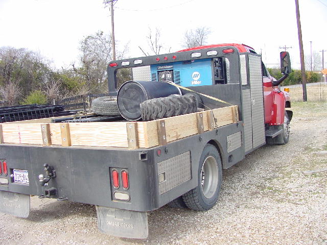

Moby's gone. I understand she's gonna have her wheelbase shortened and get herself a nice coat of red paint. They're gonna put a dump bed on her and she's gonna haul local.
This is Lucy almost complete.

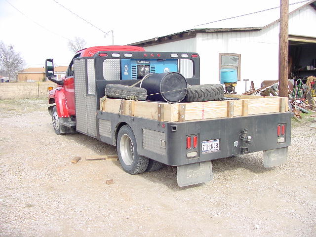

#38
From the south end looking north........

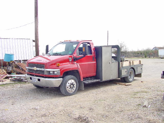

#39
Another........
Friday I put thirty six hundred pounds on her. We did a hundred and forty nine miles and used fifteen gallons of diesel. I'm so proud I could spit.
Then Saturday morning on the way to the dealer for tags and inspection she wouldn't shift into fifth.
They put it on the puter and said nothing came up as far as codes go.
So this morning on the way to the dealer she kicked into fifth like nothing had ever happened.
The dealer dude told me she's learning my driving style. I guess running eighty with a load made her decide to slow me down a bit./w3tcompact/icons/laugh.gif
   / Some days............. #40
Lucy is Lookin' Good/w3tcompact/icons/grin.gif
As far as learning your driving style, give her a few hundred more miles to figure it out!
