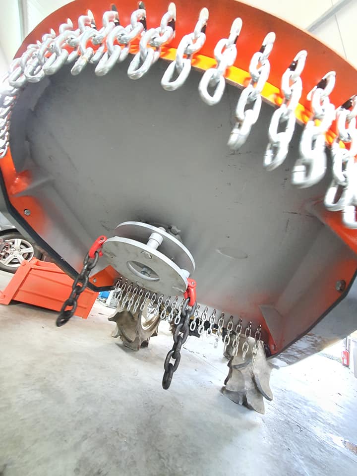

Most spindles come with 2 chains with the option to run 4. I've never tried 4 sets of chain though. A few manufactures will also offer a 3 chain spindle.
I suppose one could modify on of your style mowers to run chains. It's just a piece of chain and a connecting link. Always use grade 80 or superior chain.

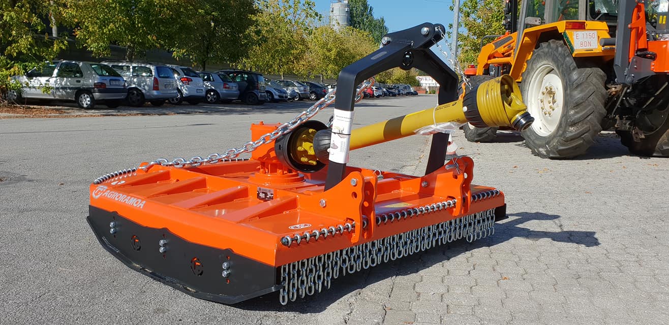

Thanks. It looks well designed, with what looks like replaceable skids, bracing and the back seems quite sturdy as well. I assume it is from an European manufacturer?
   / Solution for Heavy/Dense Brush with 34 hp PTO tractor? #53
Yes. This actually a Portuguese manufacturer. We have quite a lot of them making these things for kinds of budgets.
These are built to take a beating. I mean, we back these things against everything and it just takes it.
The skids are adjustable in height, usually in 3 steps. There is a hydraulic side shift option available as well.
The forestry versions are even more sturdier and heavier duty with the option of a hydraulic gate in the back.
Here is a brochure I found in English from Joper, one of the best manufacturers here: http://joper.com.pt/attachments/upload/Catálogos/ctlg_cortamatos_joper.pdf
I like this one a lot because the skids are curved and doesn't tend to drag brush in front of it or leaving a mark on the ground.
