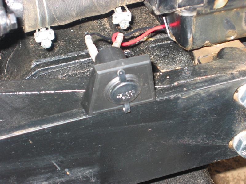

Well, I saw the $5.99 ones at HF but I have no power on the property so I ended up getting the solar ones . Here are some pictures mounting the Radio Schack 12v plugs. On the tractor, I mounted the plastic holder by drilling #29 drill and tapping 8-32 on the frame so it is under edge of the hood.

Another picture of the Radio Shack socket with the Harbor Freight solar panel plug in it. It is located just behind the hood so I don't have to open the hood to plug it in or take it out.
