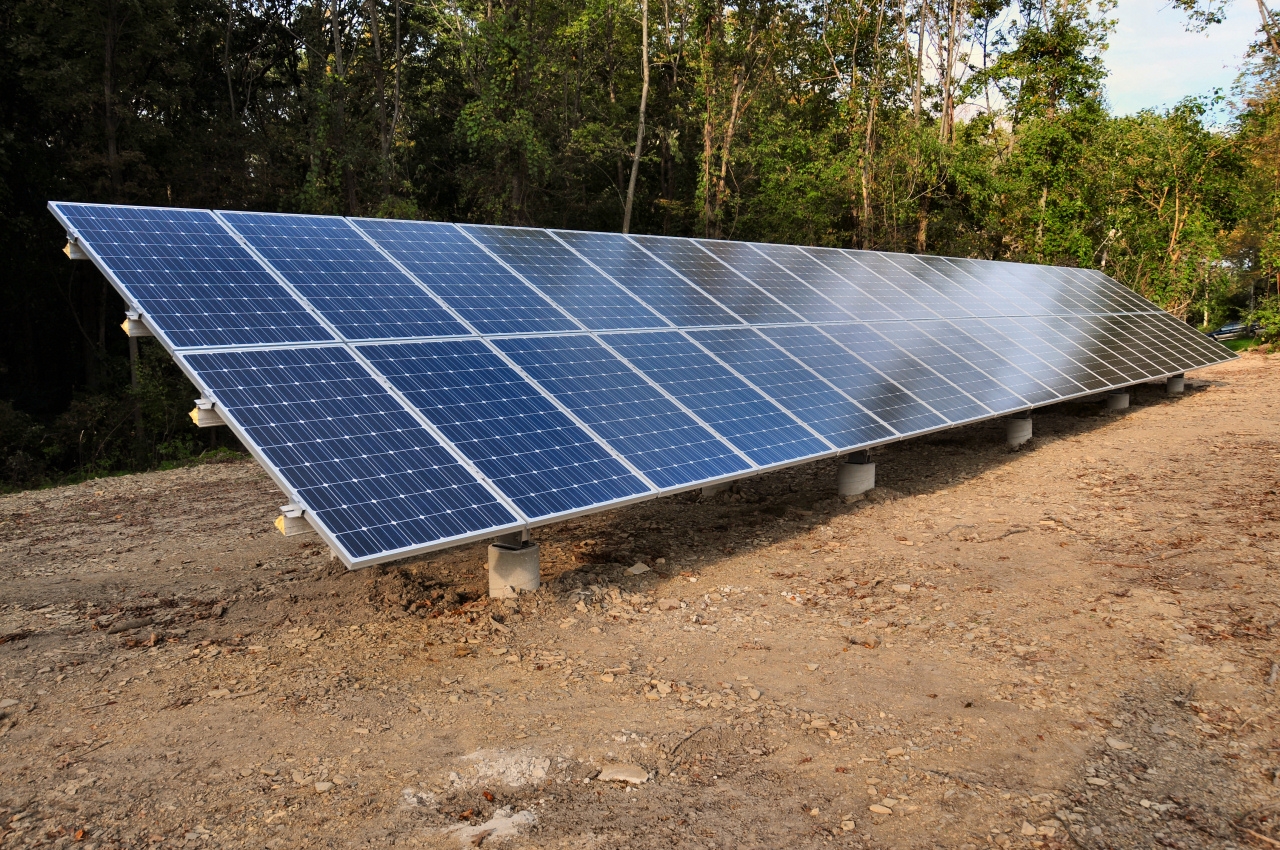

I installed a ground array in 2011, with 40 230watt panels. I bought a Schletter rack system. All aluminum extrusion which was delivered engineered by Schletter for my installation. When I bought the rack in 2011 it ran me $4700. Schletter wanted 5 8' footings in the rear and 3' in the front. They said this was for wind uplift. I consulted with a civil engineer from the university I went to and he did some quick calcs and said "way overkill" I went with 3-4' x 12" for all 10 footings. I dug the footings with my Kubota, but before I could get them inspected we had heavy rain and most of the holes filled half way up with dirt washed in by the rain. Another day of digging was needed before inspection. Inside is a single Fronius 10KW inverter.
It has been 13 years in service and not one minute of trouble with the system. I have saved & 21,275 in electric cost (with net metering) as of this month. Additionally I have been paid $3500 for carbon credits (SREC). Along with ground source HVAC that I had installed in 2005 my average monthly cost is $ 130 to the utility.

SREC's is something new. I had to google that. Interesting concept.....have never heard of such a thing or even understand how it works....or even if it works with a rural coop for electric provider....which is member owned and not a public utility.
The brief looking that i did seems to show that most places want to be able to hook into your monitering software to see how many credits you are generating....then sell them on your behalf and take a percentage....
