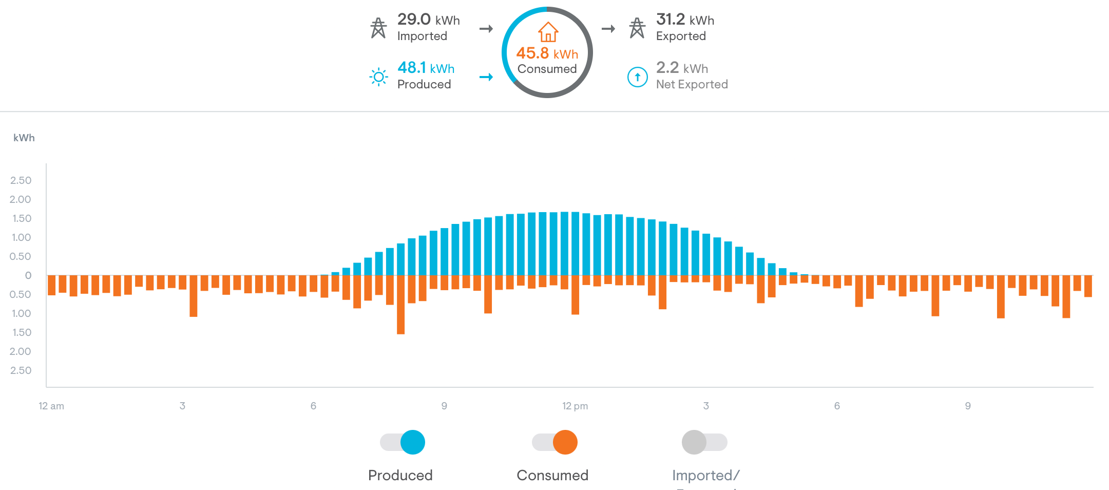

Yep cloudy/rainy days have sure put a dent in our solar output for the last two months as well but every now and then we get a nice SUNNY day making plenty of power. Our output for today was 32.3 kwh and today was partly cloudy. On those full sun days I look at the Enlighten app and go "Oh, yeah". :cool:

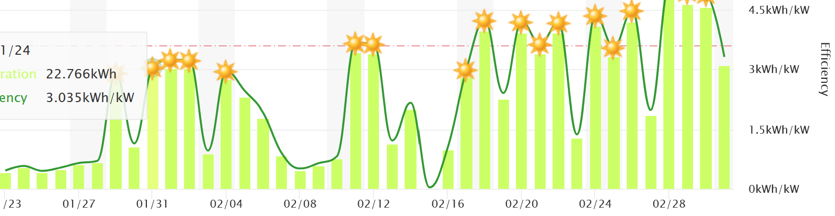

My solar went positive for the first day this year. That’s normal for where I live as January and February are cloudy months. It will only get better as May is my peak output month. Peak output was 6.9 kW. Not bad for a 7.5 kW system.View attachment 854869
My 7.5kw is going positive too. (A little harder in central Minnesota.)

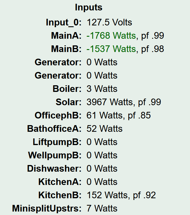

The current output of our 7.5 array. Produces about 9 mega-watt-hours per year.
Net out-of-pocket cost was $9,400 in 2019.
