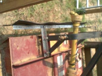

Does anyone have any suggestions on how to soften/condition an old flat-style PTO belt? I want to use one I picked up as a "deflector" on the back of my PT's rough-cut mower (see pic below). Because of the way it is made, I can't simply put chains on it like you normally would. So, I've been thinking of using a piece of a tire or something -- then I happened to see this old belt. I thought I might be able to bolt it to the back edge of the deck. Even if a blade should happen to strike it, it wouldn't be like chopping off chain links and sending them flying...
It's still pretty pliable, length-wise, but is getting stiff and somewhat brittle I'm afraid, when you try to bend it side-to-side. It must be at least 40-50 years old, and I'm not as limber as I used to be either. :p
Does anyone know what they used to use for "belt-dressing" on these old flat belts? Notice that I don't have to worry about it slipping, so it could even be oily, but I don't want something that would swell it/soften it too much...
Thanks!

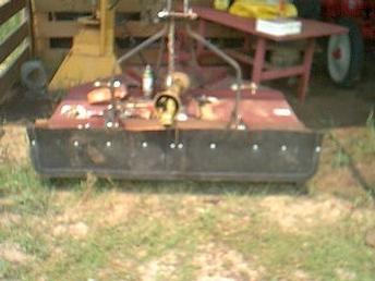

As an alternative, stop at a truck stop and pick up a 4$ truck mudflap.. nice thick and heavy.. I made a brush deflector for my rotary mower with that and some hobby angle iron..
cheap and easy...

Was that for one with chrome and nekkid' wimmin on it?
Seriously.. all the local truck stops and big truck parts stores have em for 4-6$.. just plain black thick rubber ones...
Mine cost me about 15$ to make including the perfed iron and 1/4" bolt hardware I bought from the bulk bin.
here are some pics..
Soundguy
