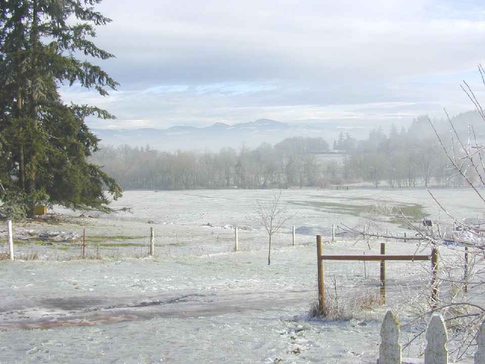

This year I intend to replace my 30year old stock field fence. I’ll be doing almost 40 acres so I think that I will build my corner posts and associated bracing in the shop with sch 40 pipes. Then drag them out and place them were I need to. I’ll do the same with center bracing then stretch new red brand field fencing between them. My cows are pretty content to stay around but since the neighbor to the north doesn’t do anything with his field come August the neighbors untouched field is a pretty strong temptation.
Attached is a picture of the lower 20 last week after our very rare ice storm.
I have really enjoyed your gate and fencing pictures. Thanks for sharing with us.
Eric

Morning Eric,
It sure is pretty but it looks a mite cold. /forums/images/graemlins/smirk.gif
The only problem I'd have with your idea would be premade H fixtures and corners work and look good on level ground. I got the sneaking suspicion some of your land isn't.
BTW the HD in Weatherford Texas carries corners and H fixtures all welded up with two and a half inch (2 7/8") schedule eighty pipe. It's a shame too, all that good steel and the horizontal pieces are too short. /forums/images/graemlins/crazy.gif Some folks forget the strength in an H fixture comes not only with it's design but a lot of it comes from distance between the posts.
If I was you I'd premake those for the flats in the shop and build the ones in place that are where the terrain is horizontally challenged. I use 96" as the key number. Posts eight feet long and the horizontal spacing between the posts, eight feet too, nice round even number.
You only regret digging a hole too deep for a couple of minutes. But you can regret not digging it deep enough for years and years. /forums/images/graemlins/grin.gif

That's a pretty neat picture, 40Kchicks!
More like a painting than a picture...you are a luck guy living in a nice place like that... /forums/images/graemlins/smile.gif
