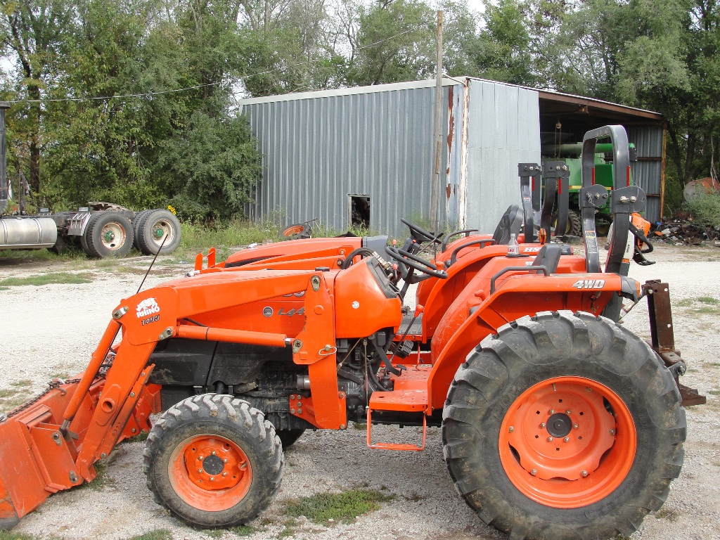

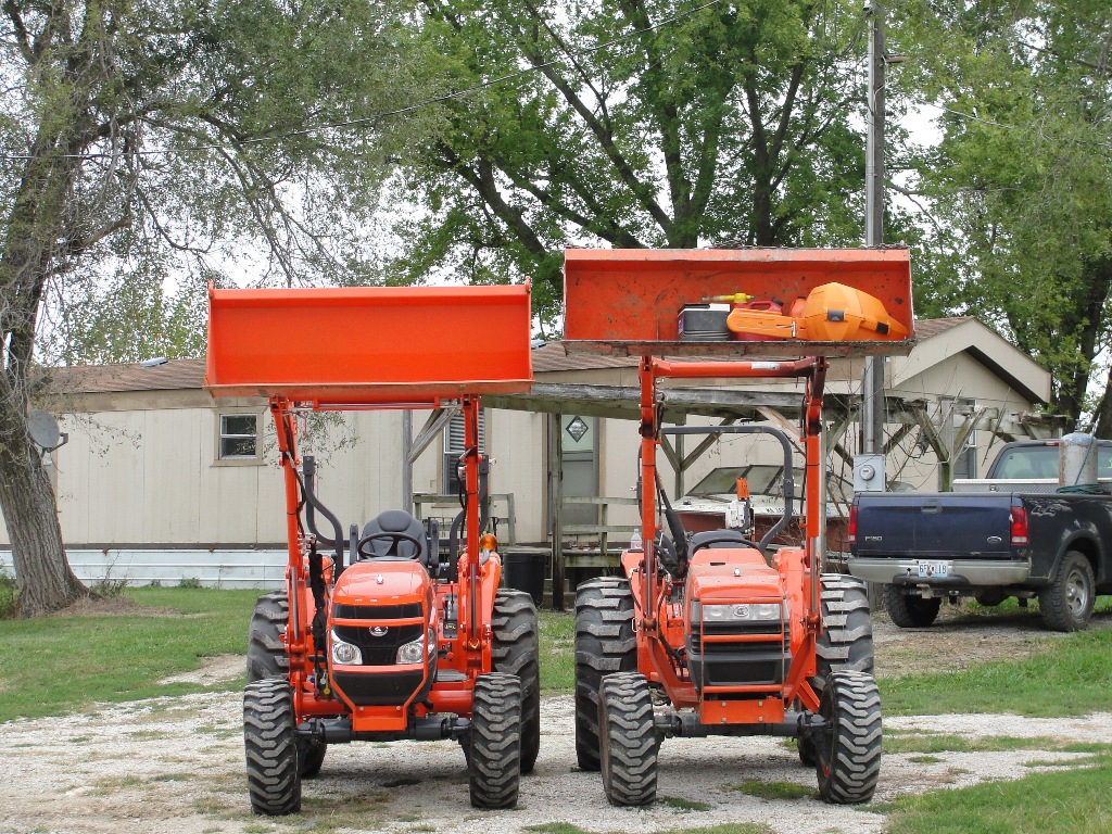

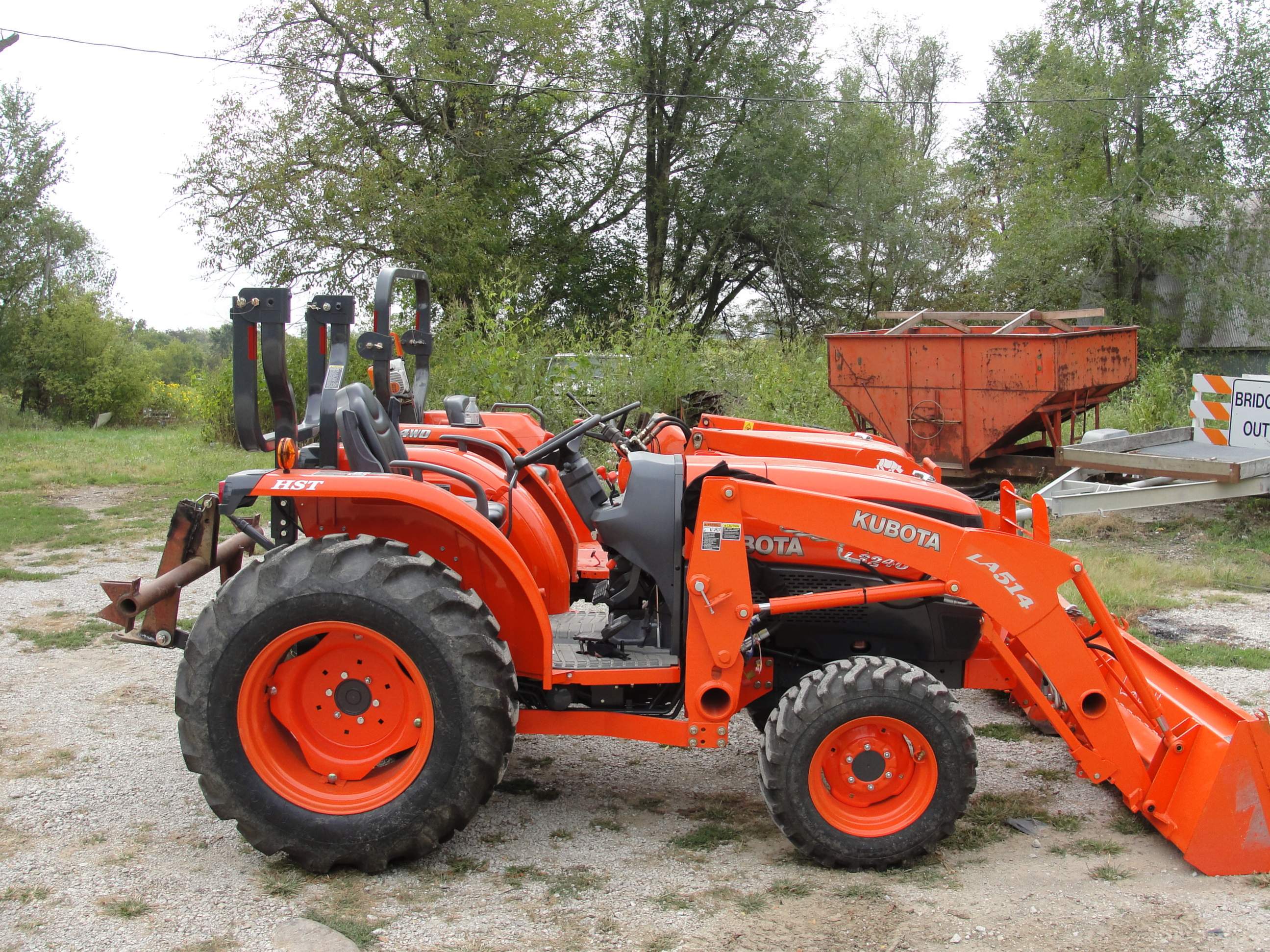

Here's a couple pictures of two different designs. The first is my Brother's Kubota L514 loader. Second is my Rhino 1495 loader. Notice how much closer to the front axle the loader frame sits on the Rhino. The Rhino bucket is QA and a considerably larger bucket but yet the cutting edge isn't any farther forward. If we switched buckets the Kubota loader would extend the bucket 3-4 inches at least. Also, even with longer arms, the Kubota loader lost lift height, not sure how that happened.
The answer to the loss in lift height is the length of the lift cylinder, and more so the lift cylinder pin is located lower on the loader tower. In other words, it is the loader geometry. The capacity of the 514 is 514 kgs (1131 lbs).
What is the lift capacity of the Rhino loader? Is it 680 kgs (1495 lbs)? How long does it take each loader to lift from the ground to full height.
Are there any reasons not to go with a Rhino loader?
