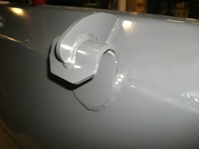

I don't agree with how they reinforced the upper brackets though.
:confused::confused::confused2::confused2: Why? Have you ever read about or seen one fail? Not me-never.
   / So you think converting a Pin-On to QA is Easy! #22
I have talked with people that have had them bend. Here is how I engineered it. Certainly not looking to pick a fight here.

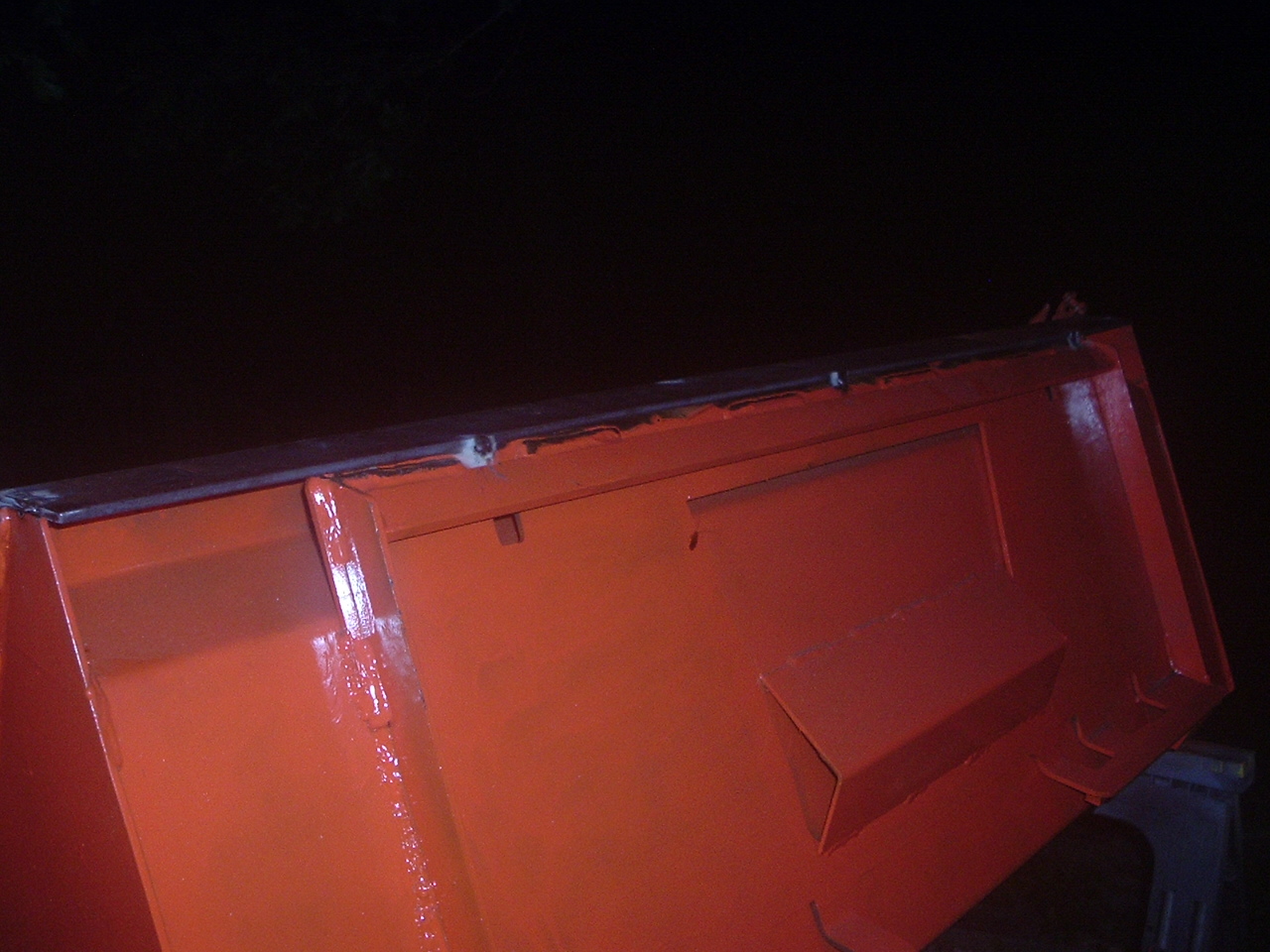

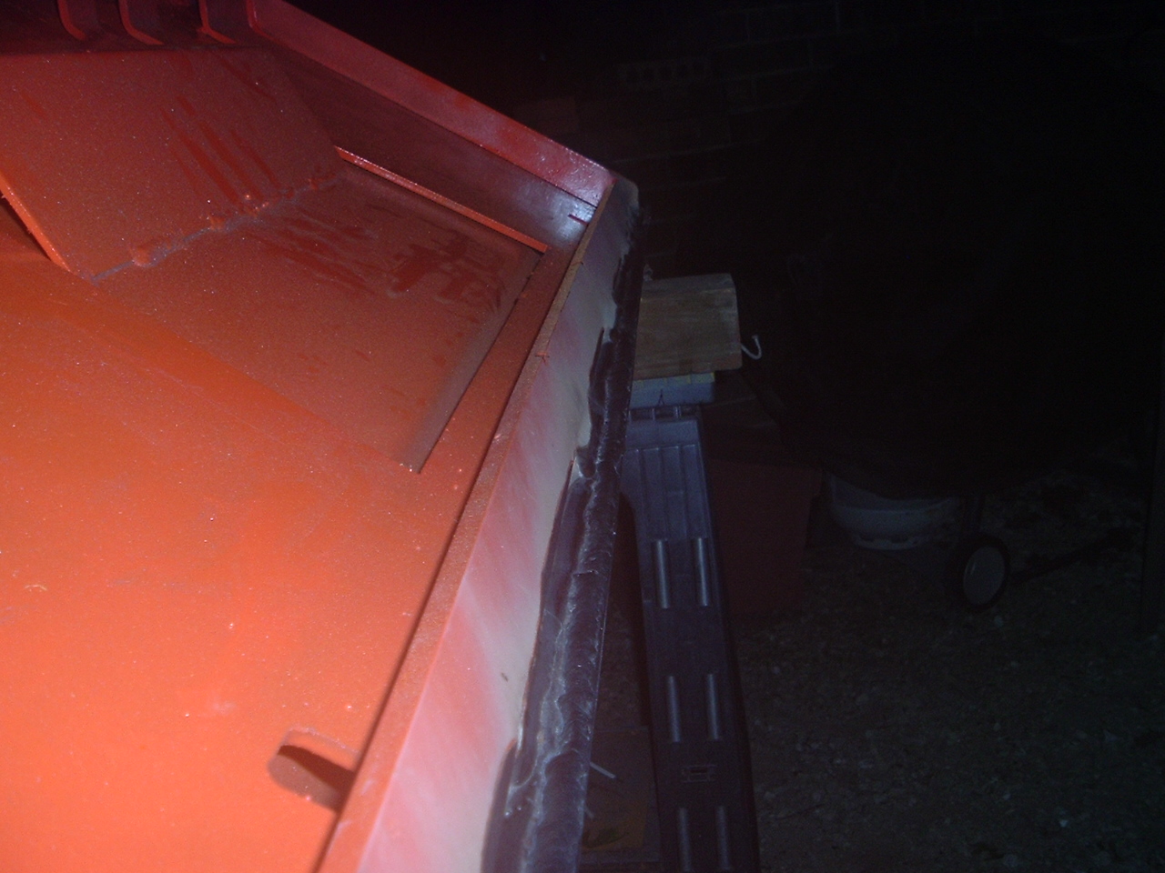

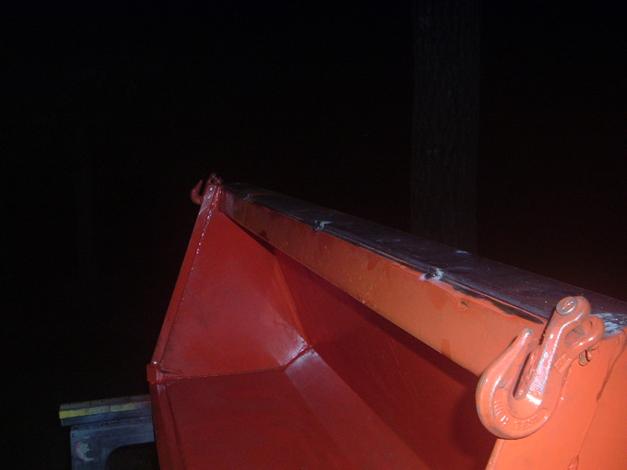

Well here is the top bar of steel. tacked on only. too dark, not to make excuses (Don are you there?:laughing::laughing:) lest Don think I am a Candy.. um you know... anyway. maybe tomorrow I can finish welding the top and weld on the hooks in line with the loader arms, and paint if there is enough time. Painted it Sunday, all over. but of course did not have the top piece of metal yet..
Thanks for looking.
James K0UA

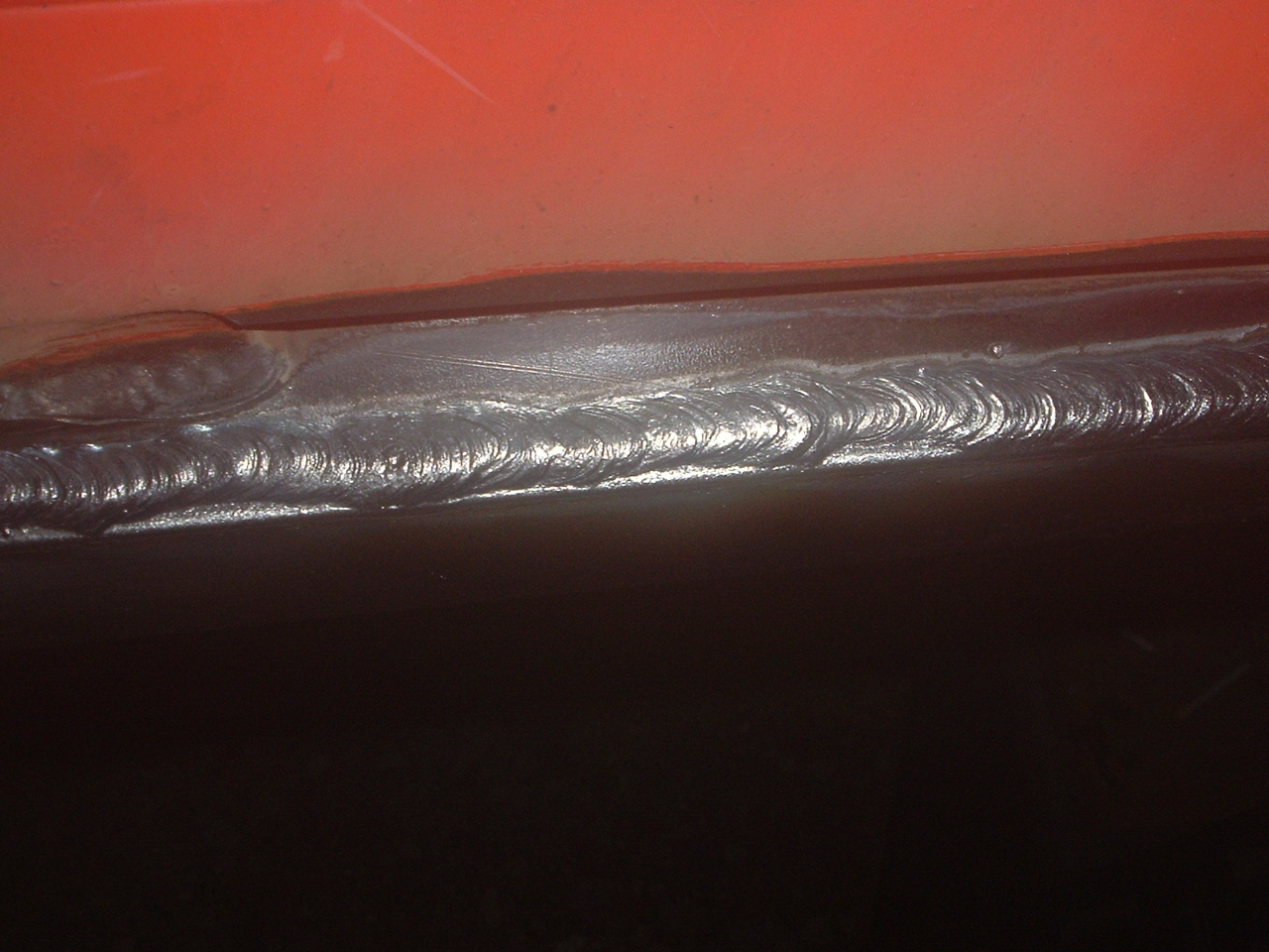

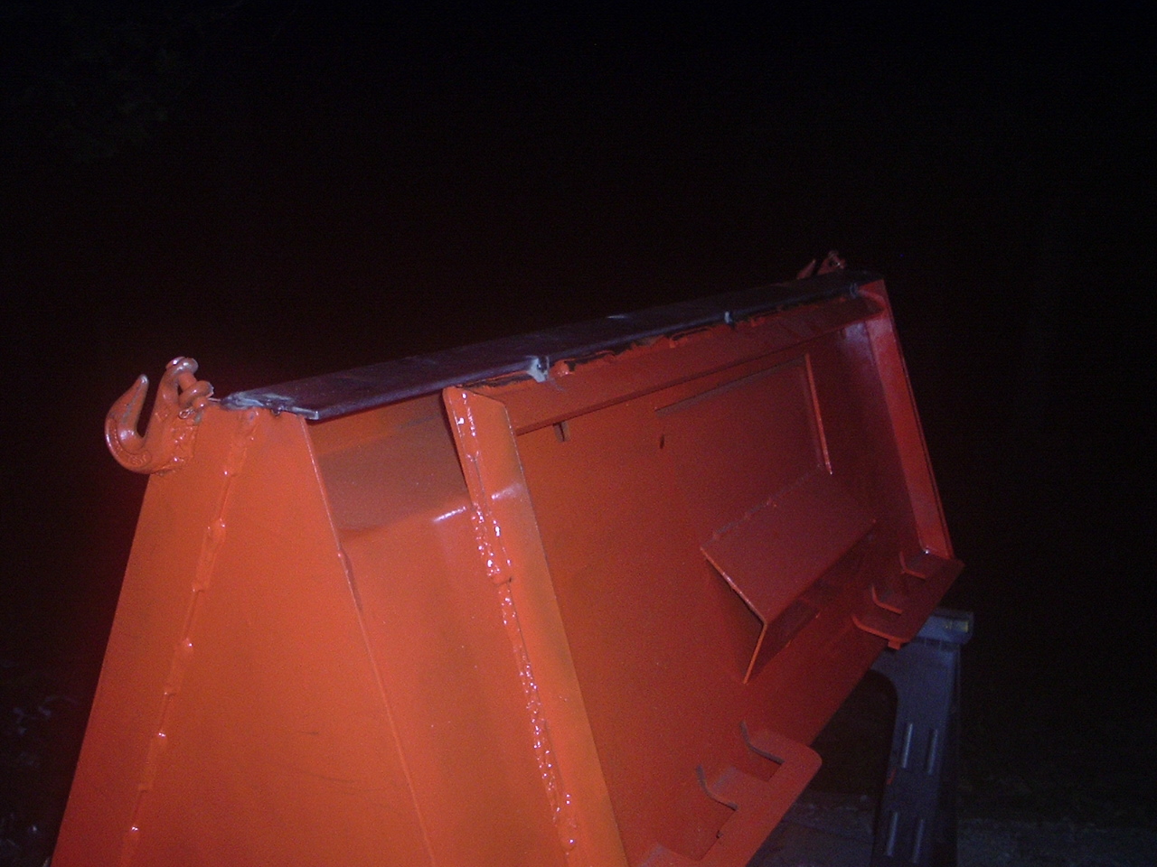

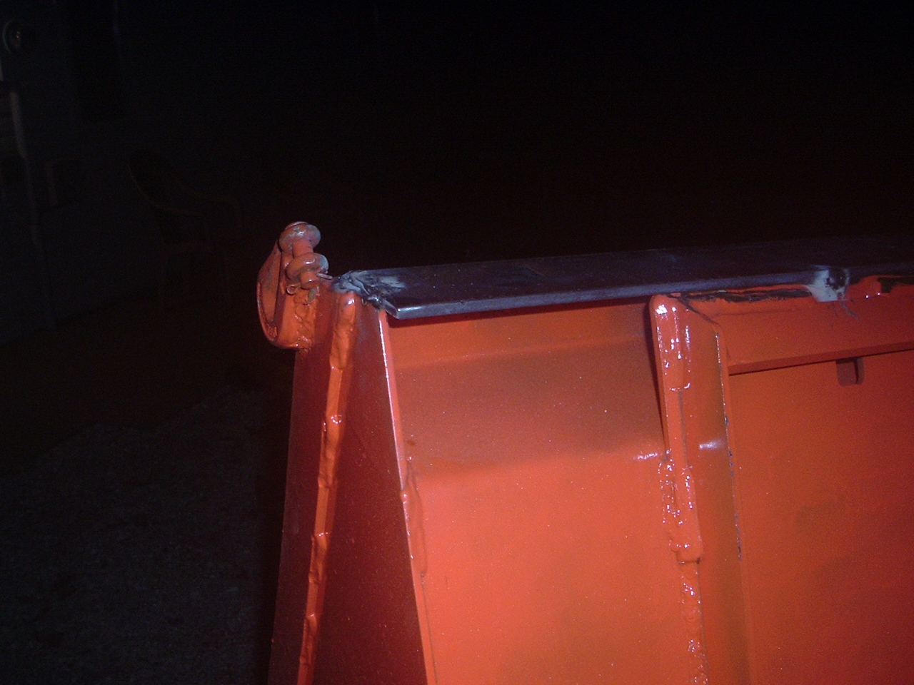

I finished welding on the top plate tonite, I went with 1/4 instead of 3/8, I looked at my
new Kubota QA bucket and that is all it had on it. I did not get to the hooks. Maybe tommorow
The continous bead on the back is the most I have ever welded in a single line. I know I
would not make a pimple on a good welders.... but I was pretty proud of the welds. Its about
as good as I can do anyway. Rod-US Forge 7018 Size- 1/8 Polarity-DCEP 122 amps
Welder Everlast PA160 Inverter.
As for removing more of the center metal, I though about that, but it looked hard :laughing: and I also though it would add more stiffening in the center, oh well it is a little late now..
thanks for looking.
James K0UA
