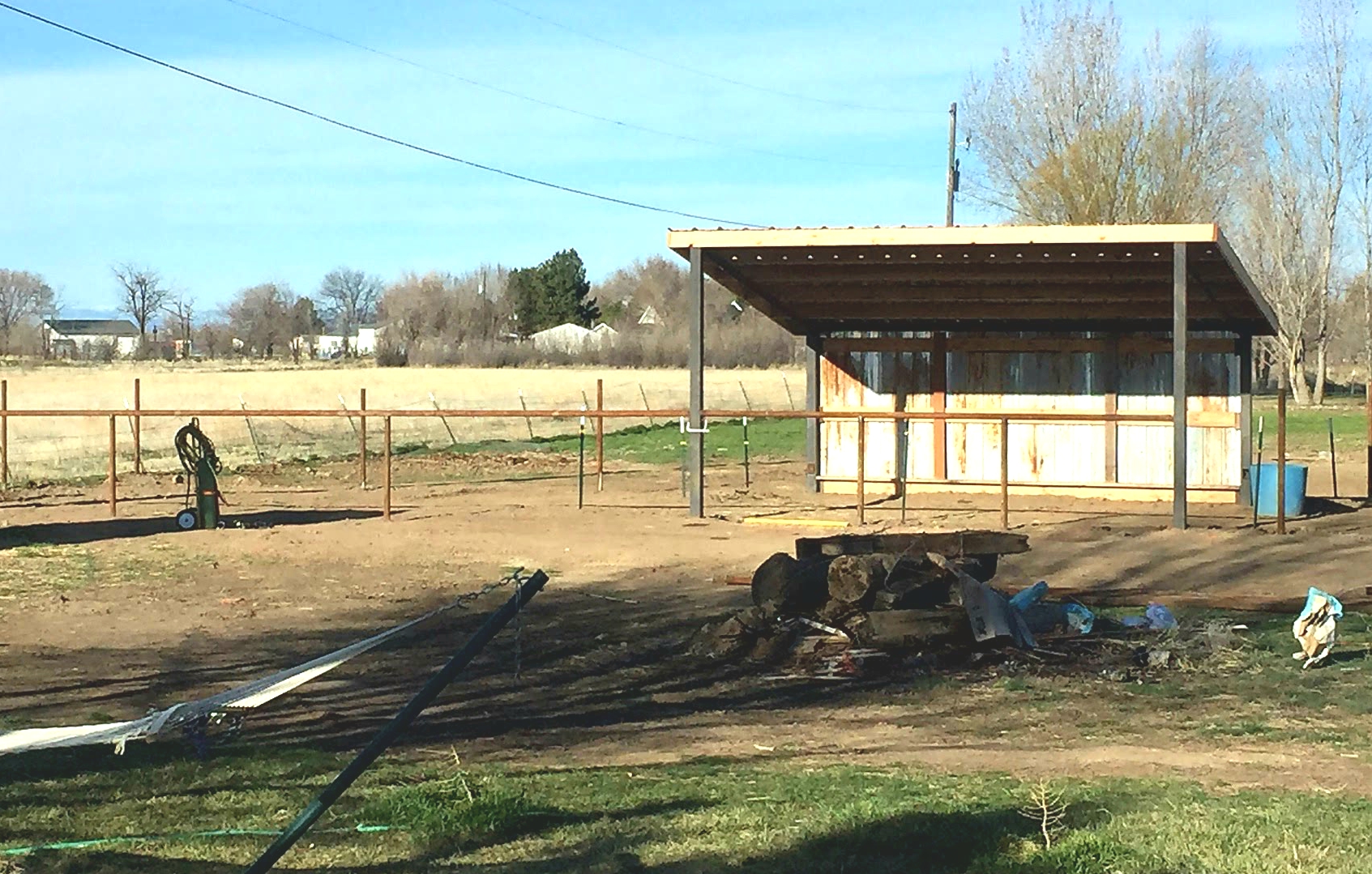

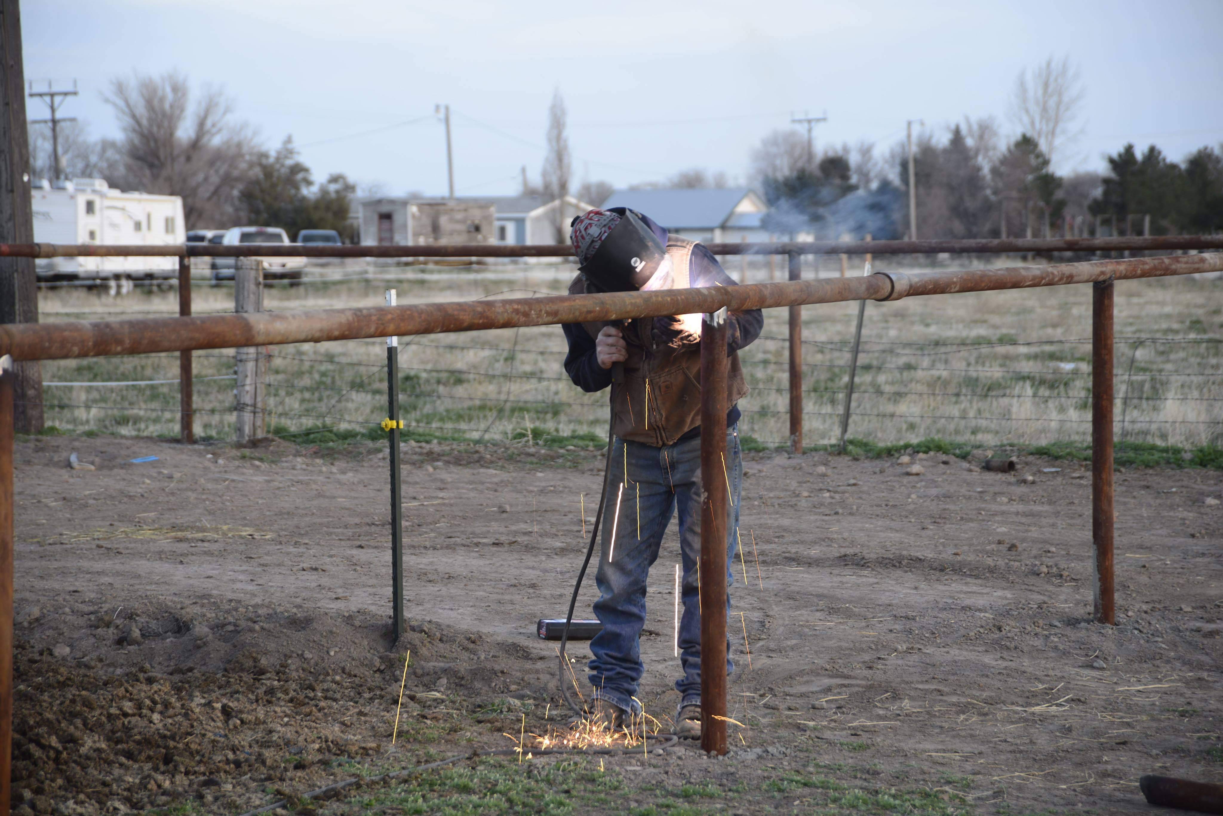

Starting to figure out arc blow and deal with it
Crystal did some low light shooting as good as infinity is i tend to quit just after the sun goes down
Have 150ft to goe welds starting to look better

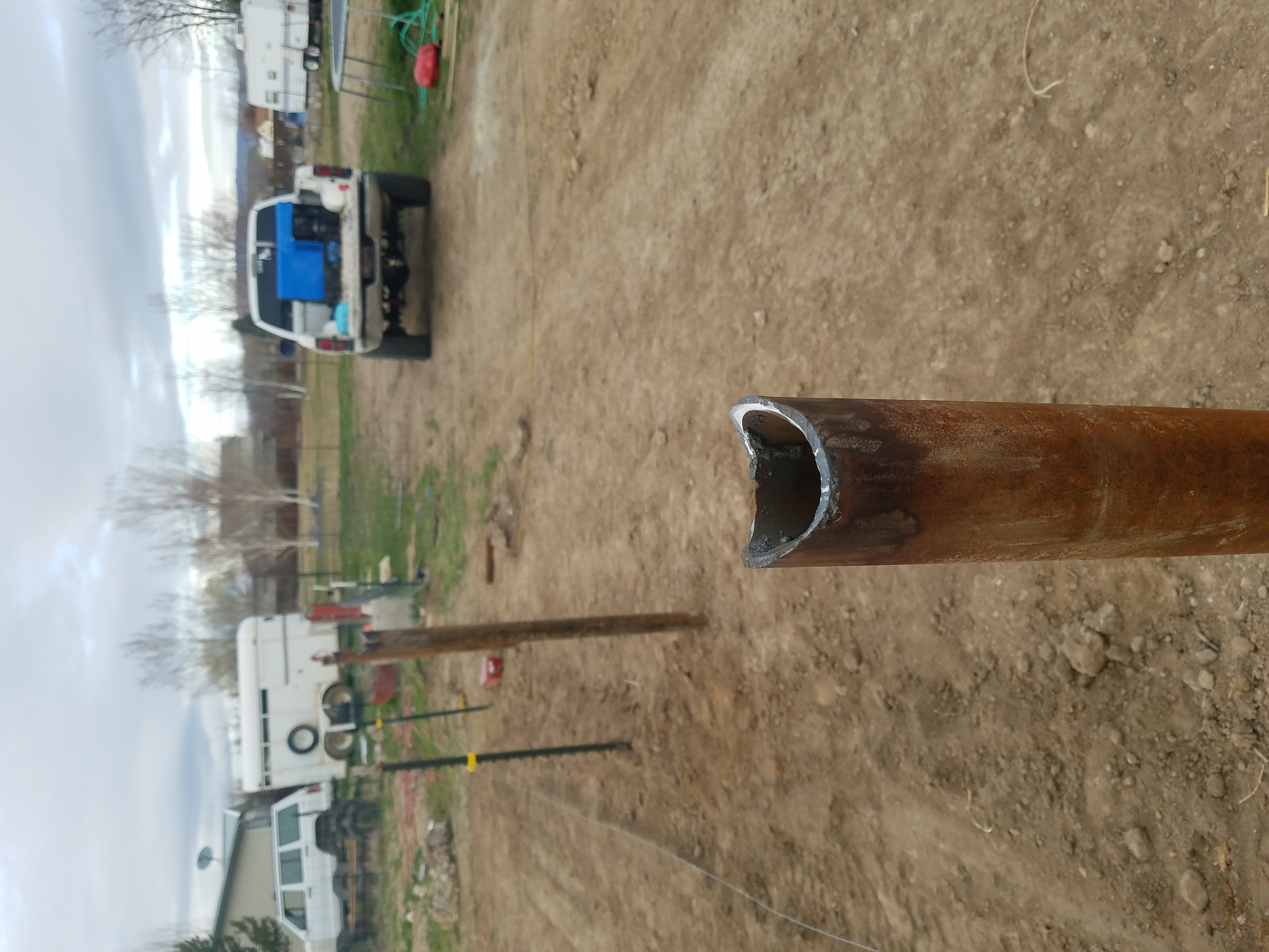

Tried the 106 road switched back to 7018 might try a unopened package.
Doing feild fence now strung tight
/ So it begins #27
Try a pass with 6011 because it will work better on that rusty surface, or take a grinder and just touch the surface enough to get past the rust, and you will end up with a lot better weld.

7018 is welding through the surface rust and penetrating just fine. Im getting better at welding with arc blow.
Stretchn wire nowView attachment 546714oh

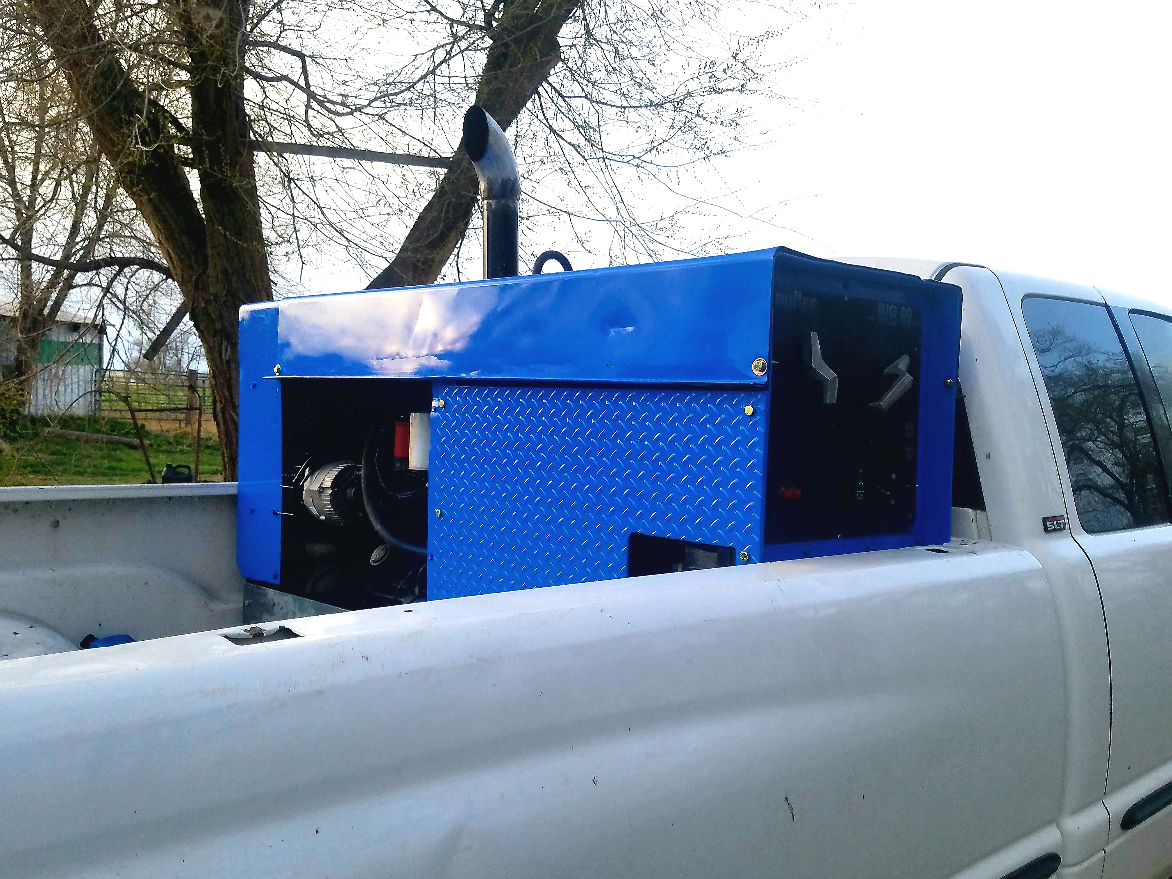

The bobcat crashed offcourse the day after i picked up work from a commercial contractor. It chucked 1 piston off the crank.
I have thought about buying a new bobcat or trailblazer. With today off i decided to bring duane and other guru's in and see if we couldnt get the bug 40 going.
Those guys over at welding web really stepped up and they pretty walked me through rectifier replacement now big 40 is up and welding and welding amazing. So so much smoother welding than the bobcat.
I will hold off on jumping in on trailblazer im pennies invested in this machine.

The f163 sounds amazing straight piped dragging beads. It should be able to weld that horse fence better than bobcat due to running smooth .
Ive got alittle cleaning to do on it. Plugs maybe coolant hoses and belt then maybe paint torch bottle mount.
Only downfall is its 1000lbs heavier and is bed raik to bed rail behind the cab of my truck
Thinking about going with cat yellow on 163 with black high lights under sail blue covers

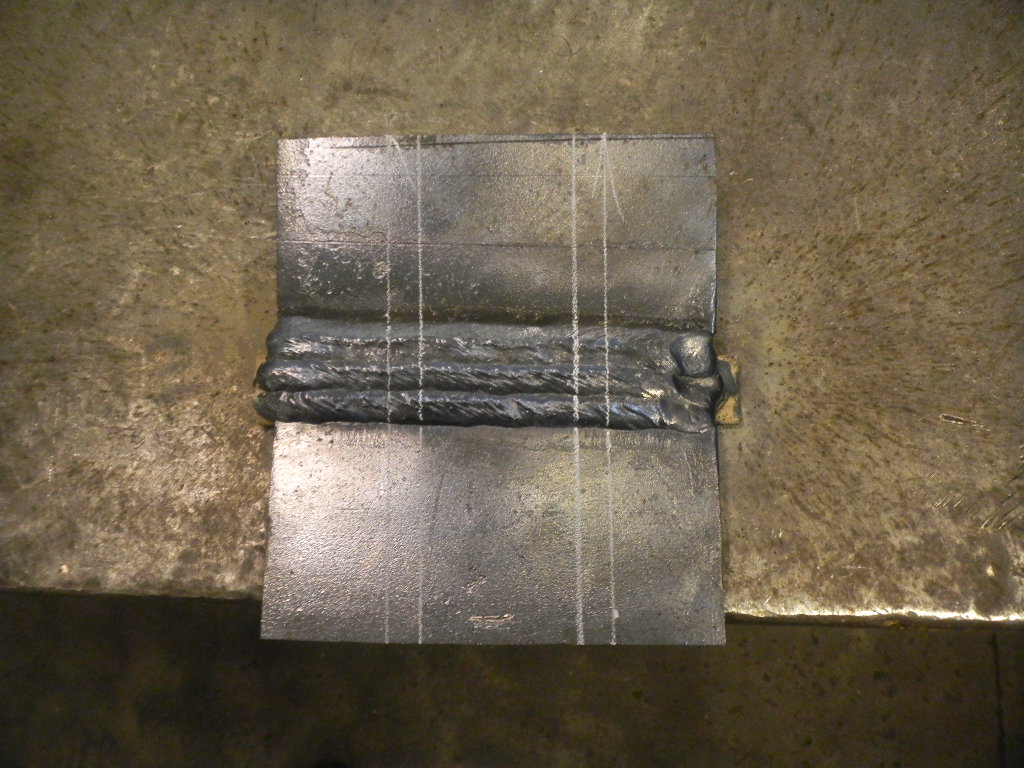

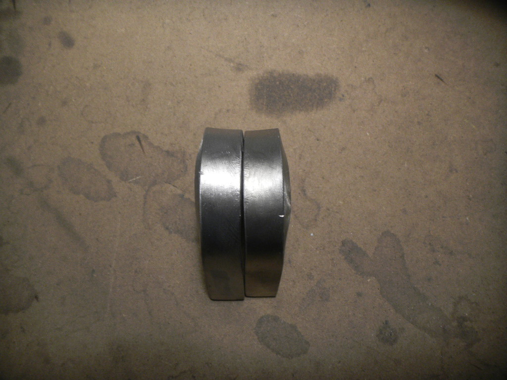

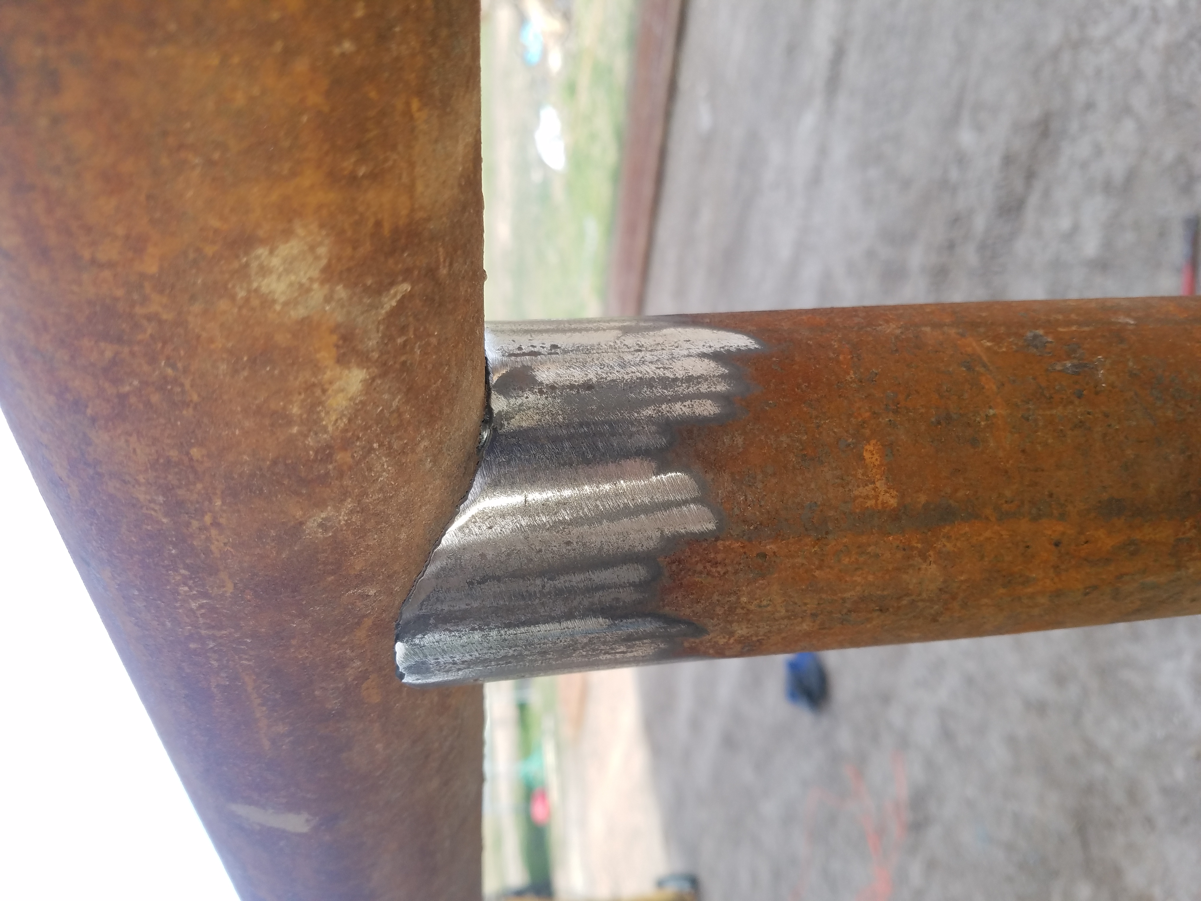

Don't everyone laugh at once but I was asked to weld some fence for a guy. At the time all I had was my portable wire feed welder available and big generator. As it turned out me using the flux core wire in it was fast and easier then stick. 10 lb of .035 Lincoln wire goes a long way. Am I wrong in considering this to use from now on?
/ So it begins #32
I think you would be surprised what is welded in heavy civil, and marine construction with self shielded wire.

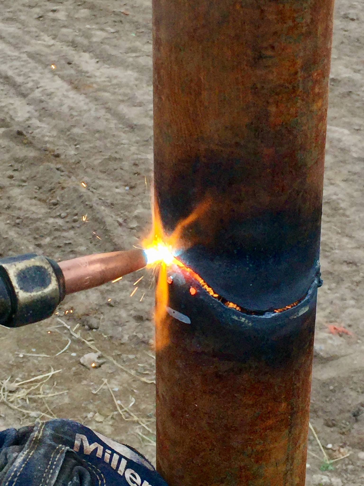

Miller Fab is rolling
Torch practice last night fabbing lead holders
Next is tank mounts
