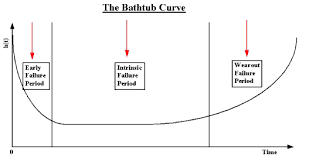

https://encrypted-tbn0.gstatic.com/...lM5d6e6pTtSN68Jhk51Zd7OKuWdKh0PzpMKIbjB-YtUgM
Bathtub curve - typical product reliability based on large samples. VEHR is Very Early Hour Reliability which is a measure of build quality - loose and leaks primarily. Next comes useful life with some random failures - material flaws, etc. at the end failure rate starts to climb at the end of useful life. At the start I wouldn’t be concerned about having to tighten a hose but computer problems and other things that shut you down shouldn’t happen. Even loose and leaks - my last product line was about 4,000 annual sales and if the VEHR rate reached 1 in 10 machines having a loose bolt or leaking hydraulic fitting the assemblers started getting hit in the pocketbook. If the company from whom you buy sends surveys, respond and be tough. If you really feel you have a lemon go right to the top. I worked for 3 very large manufacturers. None of their CEO’s liked getting a customer complaint - it meant the customer was really upset and s*** flows downhill. You do not want a memo from the CEO saying you will make sure this customer is satisfied or your replacement will.

My Kioti is now at the dealer's for the FOURTH time in less than 2 years. It took them two tries to seal up the cab following initial delivery: they also replaced the loader at that time as I noted that it was crooked. A little less than a year ago the rear axle was leaking. Now it's there because the other side of the rear axle is leaking (and they preemptively had resealed it last year!). The left side cab door has become really tough to latch (not an issue with the latch but with the glass seemingly now distorted and causing a binding at the hinge end). Travel pedal, forward, is now sticking: actuator arm appears to have a slight curve in it- it had the slightest of hitches from day one and I thought that it would just loosen up. I recently replaced one of the loader joystick cables after it had broke: easier and quicker for me to replace than to haul the tractor in- I saved the factory some $$ (no parts cost per warranty)! I see most of this being issues of falling on the left side of the statistical curve. Up until the axle leak(s), and the door, one could chalk this up to minor factory/dealer prep issues.
