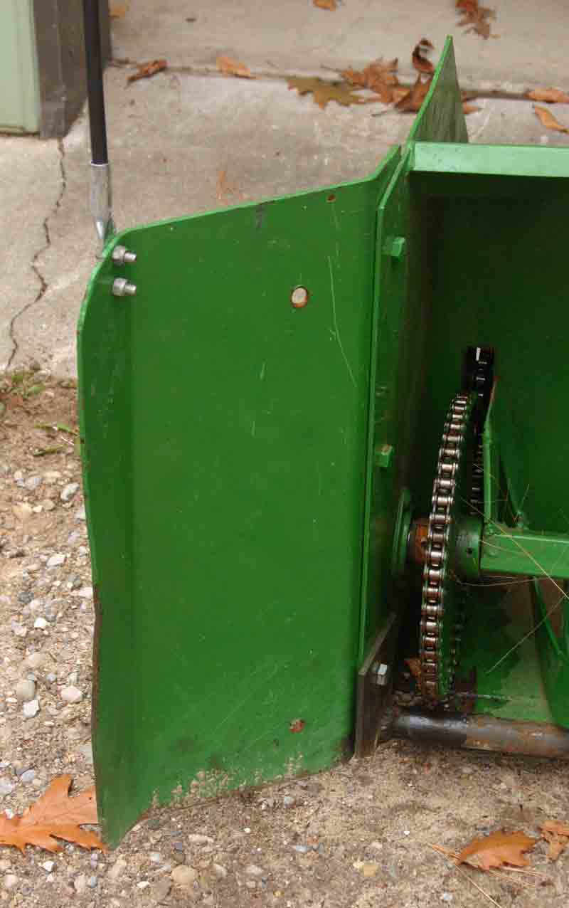

to pursue a similar thought (I am planning my own set), if you make them sturdy, the mounting bolts should be flimsy (like shear bolts) so that they are the weak link (like a fuse) ...alternatively, as suggested make them flimsy and plan on replacements ...or some combination of both
if you looked at the thread cited, there is the forward edge as I mentioned ...and the drift breakers ...
here are two of his pictures, repeated

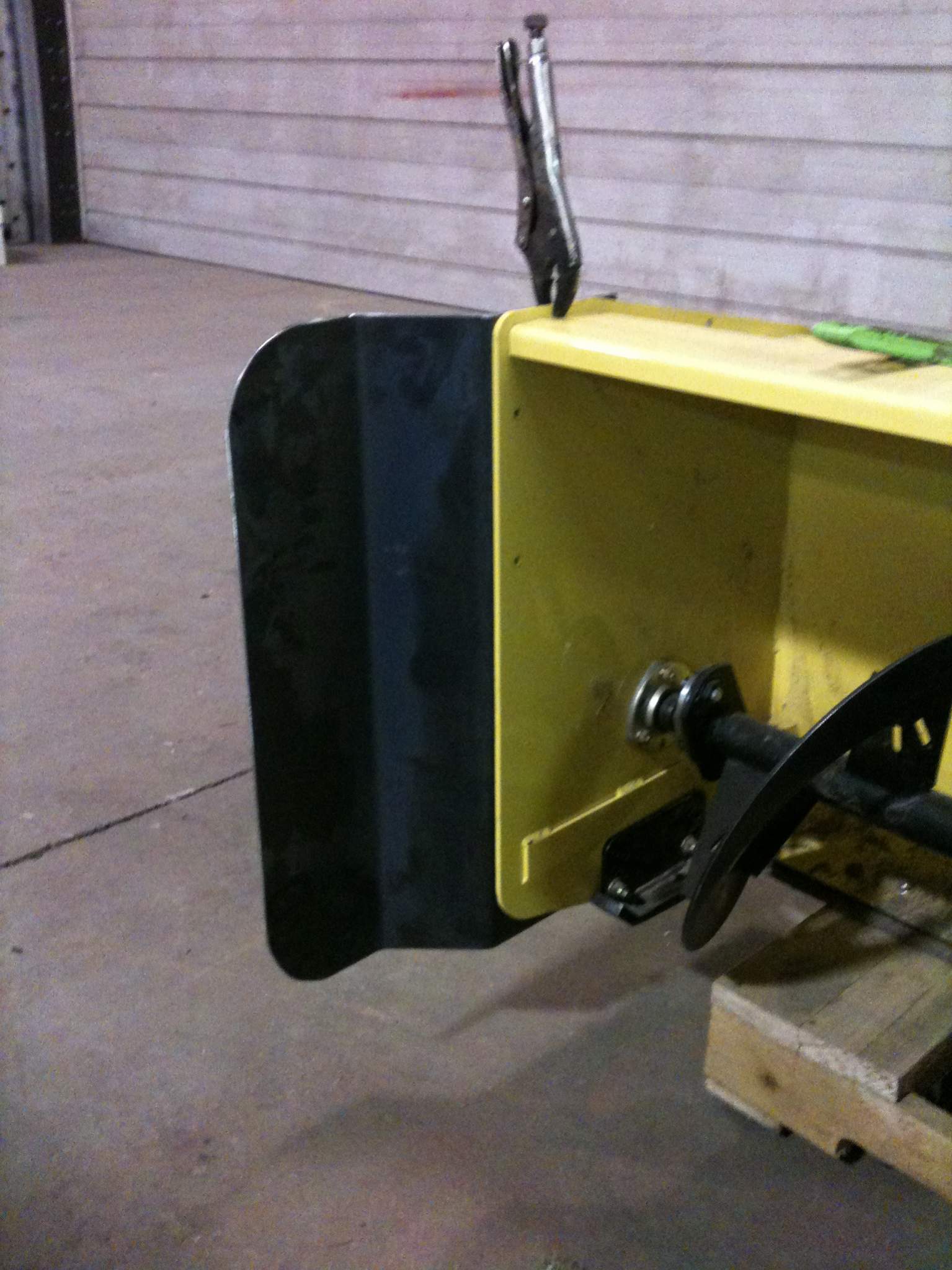

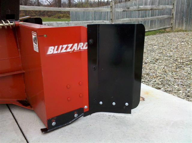

Got my wings on.
I mounted them flush with the bottom of the sides, but I just couldn't see having that 2" of space where snow could slide on out, so I mounted a piece of thick rubber on either side and held it up about even with the cutting edge. It can bend up out of the way if needed, but should still be able to gather snow.
I am not in any hurry to try them out, but am still looking forward to it, if you know what I mean :confused2: It will be nice clearing wider than the tires. They give me 8" on each side. I still need to pick up some conduit clamps for my "drift cutters".

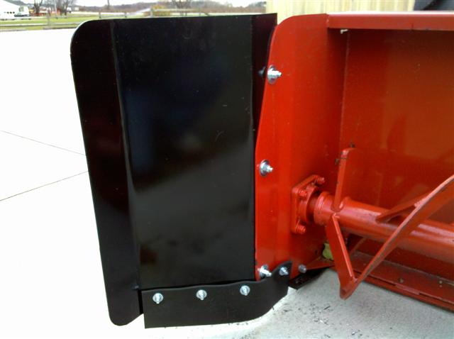

I have had a set for 12-15 years left and right are each are 6 inches
