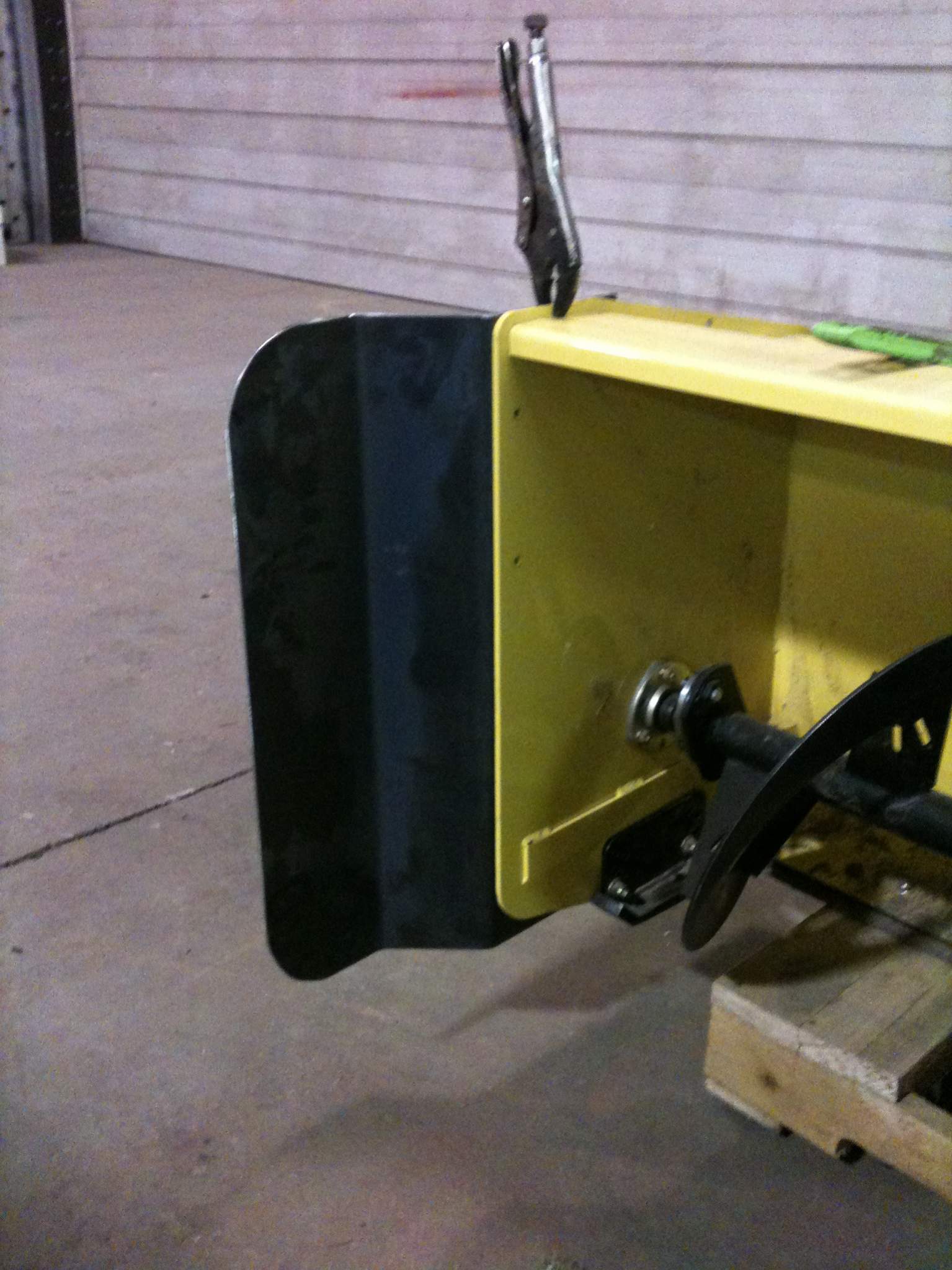

I'd like to make some wings up for my 3PH Blizzard snowthrower this year and have a few questions for those that have gone before me.
Is it possible to make them too wide, within reason?
I need 4-1/2" to meet the outside of my rear tire. I'd like to round that off to a foot :thumbsup: 12" extensions on either side angling out, or back in towards the thrower, depending on your point of view. I'm assuming one only needs to go slower for that first pass? 12" would not only cover my tire, it would allow me to clear the snow 12" on either side of my newly concreted driveway without the shoe dropping off the edge.
Bolt on or weld?
The thrower looks to be close to 1/4" plate. If my wings are similar thickness, that's some serious drilling for anyone without a proper garage or tools, plus bolts do loosen, but it would be nice to take the wings off if the need arose. Although I don't ever see the need arising...
And of course with bolts there would be some flex at the point of bolting if I only went with one vertical row, however, welding would eliminate that. Especially with some well placed stitches. Any preference?
And, if I make them out of similar thickness metal, 3/16 or so, would I need any gussets back to the thrower? I'm thinking I wouldn't, even with a 45* angle.
Any advice from some others who have modified their snowthrowers in this manner?

Not to throw water on the magnesium fred but if you add wings of any width beyond the working width it will become so bogged down the tractor will not move because the snow will not funnel into the blowers cross auger.
The blowers immediate advantage of being able to eliminate the snow weighing 21 pounds per cubic foot will be lost.
Dont forget the issue is the cross auger as it floods the housing and snow flow is unregulated due to the open auger configuration.
A wing will only win you the advantage when you are slicing to widen only with less than a full width of cut to remove snow at depth.
leon

I'm guessing that a little bit of "straightness" (1-2 in.) in front of the flare will improve performance and lessen force on the flare as you move into drift...in fact extending that piece up some distance would give you useful "drift breaker" and let you see better where the edge of the blower is

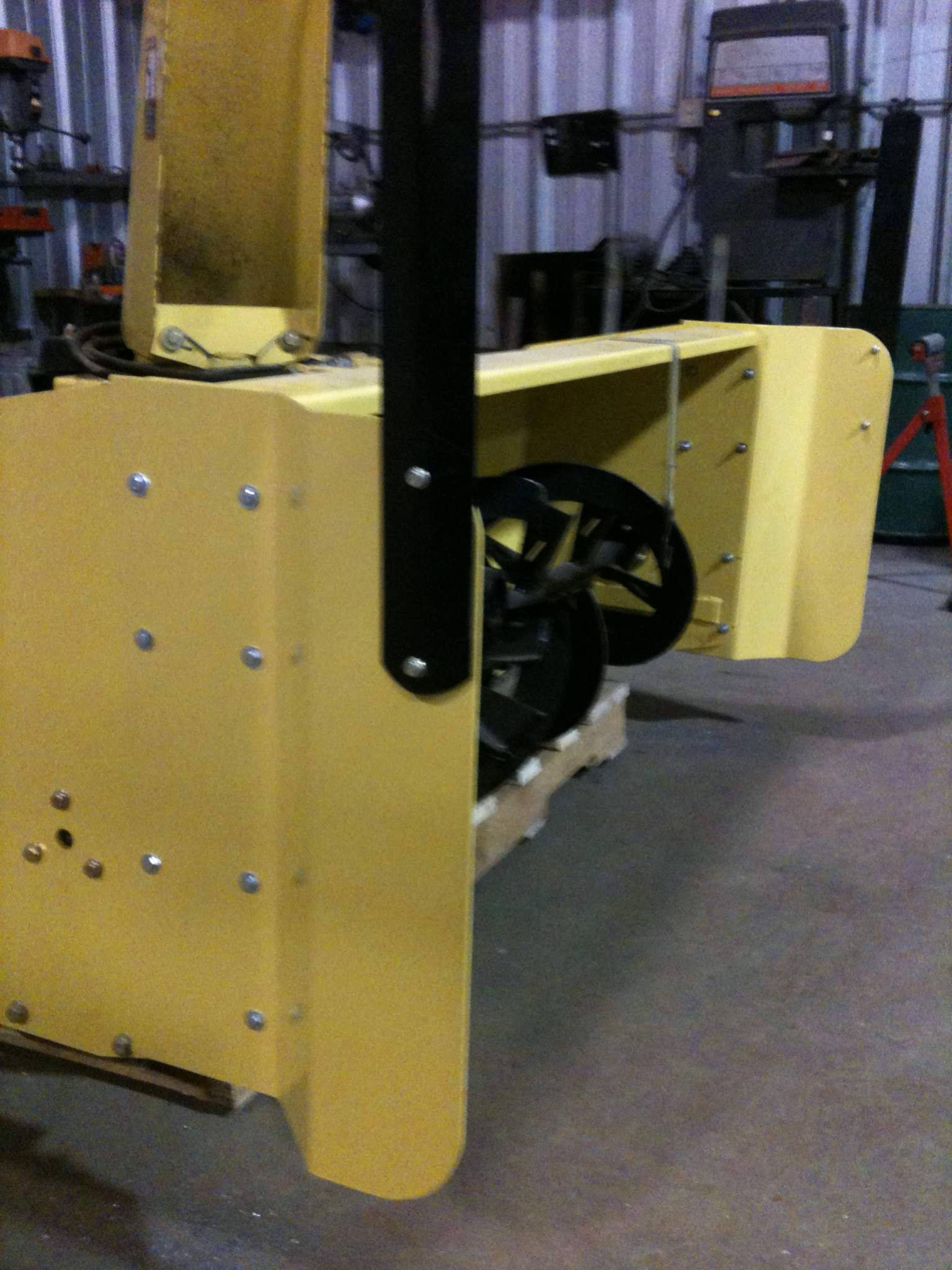

Yes, very similar to those hawkeye, with a longer angled section to get me more width than his 3.5". His were 10 ga, which is .125", 3.5" wider each side and he did not use gussets or braces. That's probably short enough not to get any flex, even with the thinner metal. Thanks for hunting up those pics.
Joel, I like your drift breaker idea. I do get drifts along one part of my driveway and something to reach up and slice them off, tumbling them into the auger area is a great idea.
Leon, I'm not sure pulling in more snow would be that much of a problem. Sometimes I have 4" I'm clearing and sometimes 4'. Four feet just requires a much slower pass, and if I remember right, one time I even held the snowthrower up off the driveway and cleared the snow in layers in one particularly bad spot, but that was more an issue with traction. Maybe clearing a wider path would solve any traction issues. I'm not sure the amount of snow your throwing is necessarily dependent on the width you are clearing. Clearing snow higher than the housing will also flood the housing I'm thinking.
I appreciate everyone's feedback. Sometimes it's good to hash things around. Time to get the cardboard, tape measure, sharpie, duct tape, protractor and tin snips out.
/ Snowthrower wings #12
jjmarotz's wings (link above) are a good design. Wings have to tolerate the occasional collision with posts, stone markers, building foundations, walkway corners etc. - the mass of the tractor is high so they'll eventually get bent, especially on front mounted blowers. If you make them gusseted and super strong, something else will bend instead - maybe better to design them to be expendable, protecting the blower from damage that's harder to fix ? jjmarotz's design has two folds - great for absorbing a crunch without wrecking the housing.

to pursue a similar thought (I am planning my own set), if you make them sturdy, the mounting bolts should be flimsy (like shear bolts) so that they are the weak link (like a fuse) ...alternatively, as suggested make them flimsy and plan on replacements ...or some combination of both
if you looked at the thread cited, there is the forward edge as I mentioned ...and the drift breakers ...

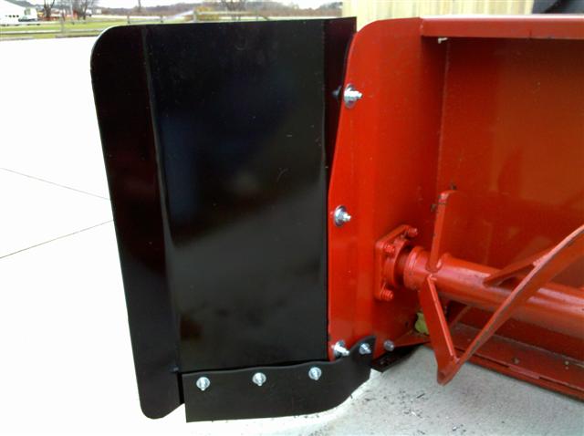

Got my wings on.
I mounted them flush with the bottom of the sides, but I just couldn't see having that 2" of space where snow could slide on out, so I mounted a piece of thick rubber on either side and held it up about even with the cutting edge. It can bend up out of the way if needed, but should still be able to gather snow.
I am not in any hurry to try them out, but am still looking forward to it, if you know what I mean :confused2: It will be nice clearing wider than the tires. They give me 8" on each side. I still need to pick up some conduit clamps for my "drift cutters".
