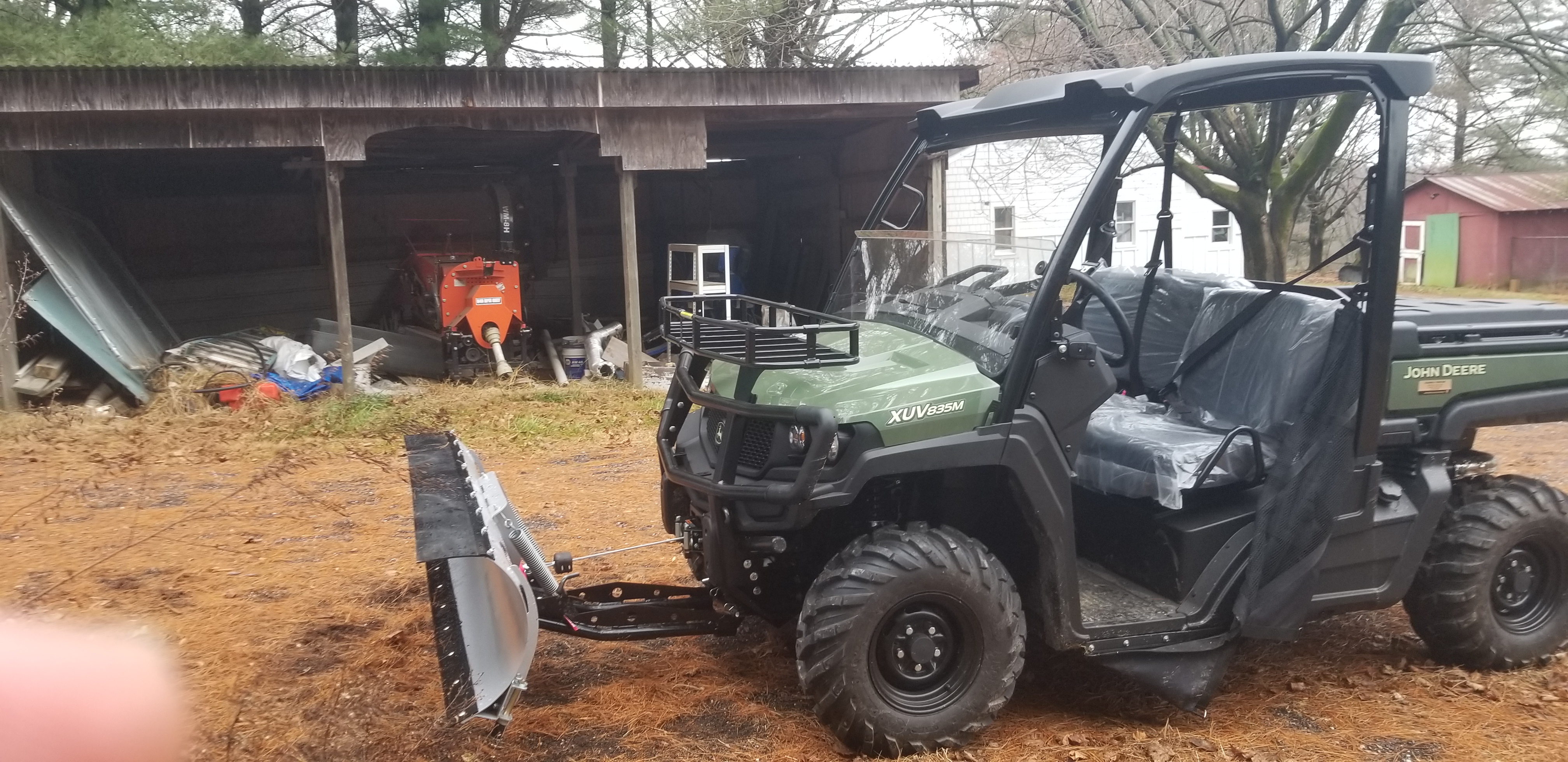

I thought I'd send photos of my completed plow setup.
I bought the plow itself, which was designed to be lifted by a winch.
I set it up for hydraulic lift.
The lift piston, which is powered by the aux. hydraulics, attaches to the front 1 1/2 inch receiver hitch.
The lift works great.
Total cost for the lift system was about $190 plus $679 for the plow itself.

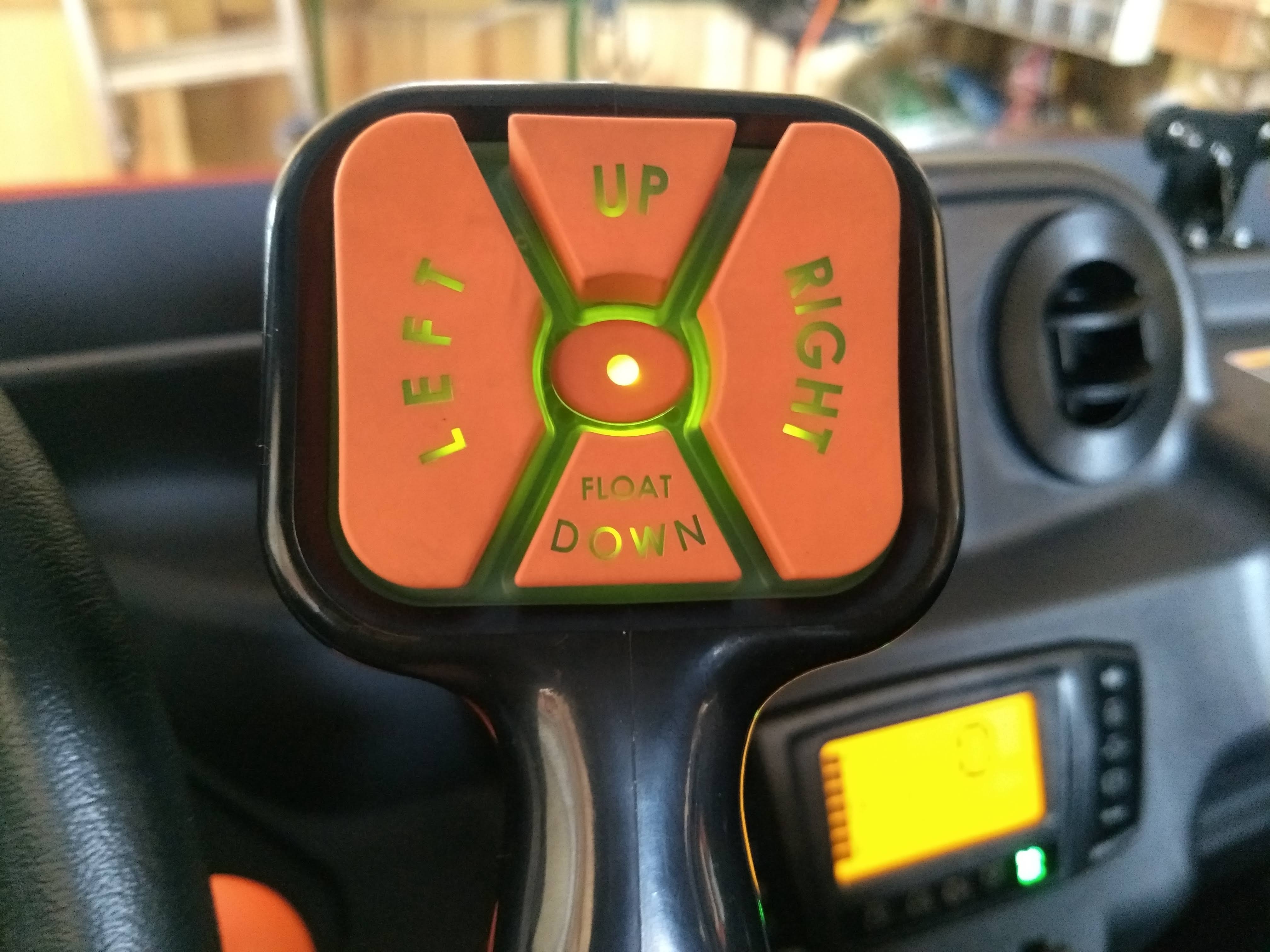

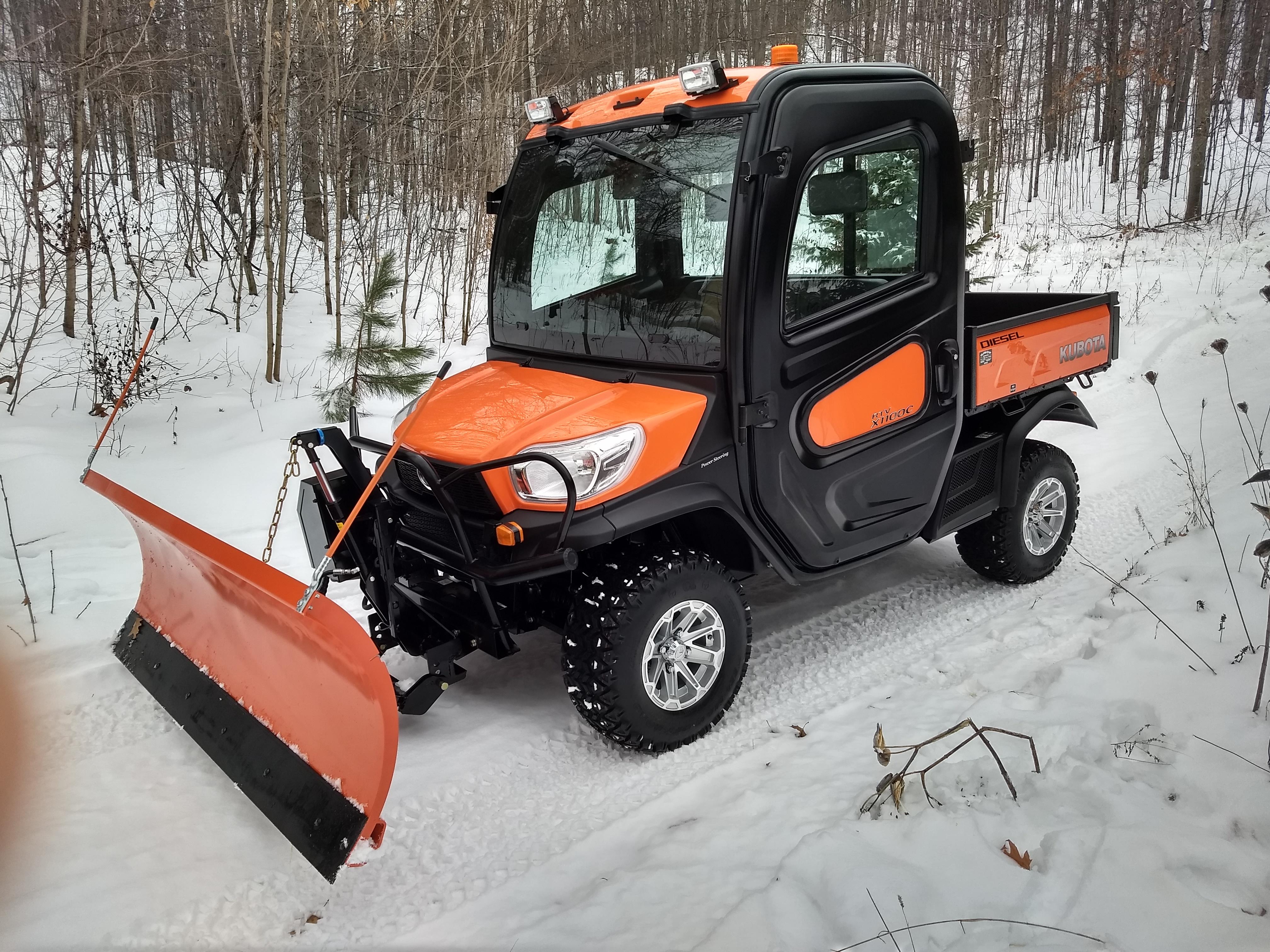

I have a brand new (well, 15 hours now) Kubota RTV-X1100C with the Kubota plow and it definitely has self-contained hydraulics. It mounts in the UTV's 2" front receiver and you have only one IMG_2594.JPGelectrical plug connecting it to the machine, no hydraulic connections like I had on my old JD Gator with the "PowerTach" plow. The Kubota plow gives you up, down, left, and right and actually works better than the fully hydraulic plow I had on the Gator. I was worried about a lack of downforce, but just the weight of the plow provides plenty of ability to scrape off packed snow and ice.

I have a brand new (well, 15 hours now) Kubota RTV-X1100C with the Kubota plow and it definitely has self-contained hydraulics. It mounts in the UTV's 2" front receiver and you have only one View attachment 586922electrical plug connecting it to the machine, no hydraulic connections like I had on my old JD Gator with the "PowerTach" plow. The Kubota plow gives you up, down, left, and right and actually works better than the fully hydraulic plow I had on the Gator. I was worried about a lack of downforce, but just the weight of the plow provides plenty of ability to scrape off packed snow and ice.
I too prefer the plow to float using the plow weight to follow the ground contours. If down pressure is needed I can slip a piece of pipe over the lift chain.

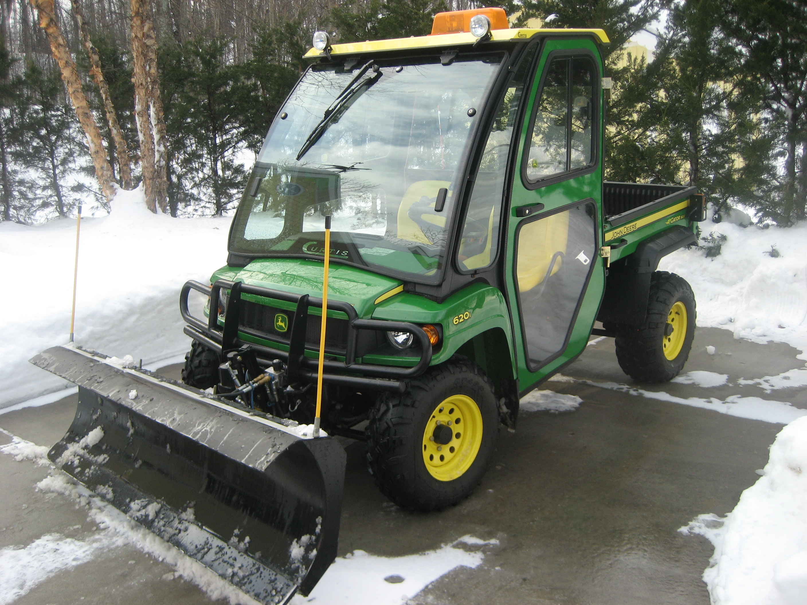

I had an Eagle plow mounted on my Gator for a couple years...winch lift and manual angling. It worked great for the smaller snows we get in Vermont. I'm sorry I ever sold it...
One recommendation for those who use a winch to lift the plow...get a boat trailer strap to replace the cable on your winch. The constant lifting and lowering of a plow is tough on a few inches of the cable. The boat straps handle the lifting and lowering much better.

Thanks! I'd been looking at the 1100C for a long time and now that I have one I wish I hadn't waited so long.It's a great machine!
