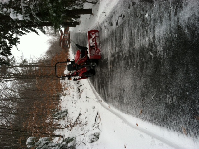

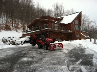

If you look at the photos below, you will see that I have 400' of pure fun, especially in the winter!
So, going downhill with my scut tlb and front mounted blower works real well, but coming back uphill sure is tough. I have also loaded the rears.
My issue:
I have BH mounted to give me more weight over rears, but it seems like too much weight. I cannot steer easily due to the uphill grade (24% by some estimates) and all the rear weight. I've tried turning the BH to the side and of course I could reverse back up and snowblow just coming down, but that's a waste of time and fuel.
Should I try another rear weight like a 3pt block?
Load the fronts? Not much added, I hear.
Add front weights?
Tx.

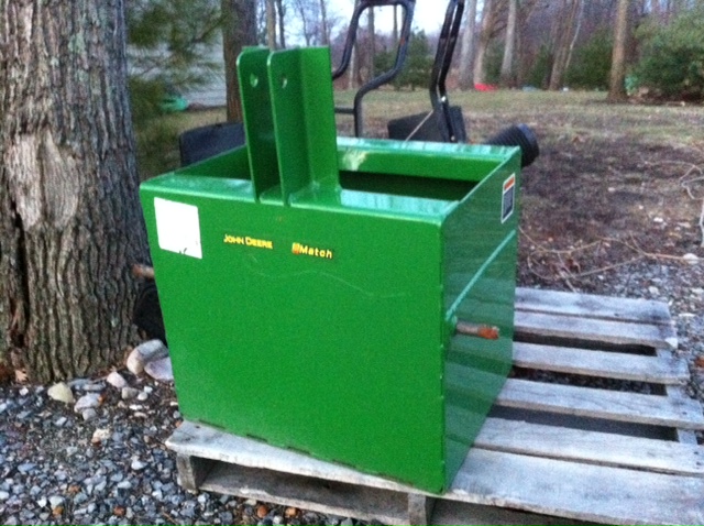

Any good photos of your box Gizmo? Did you make it yourself?
Tx
/ Snowblowing up steep grade issues #16
I use the John Deere Ballast Box. Got this picture off the Internet.
Do a search for "ballast box" here on TBN and you will be amazed at how the people on here have modified them and pretty cool too.
