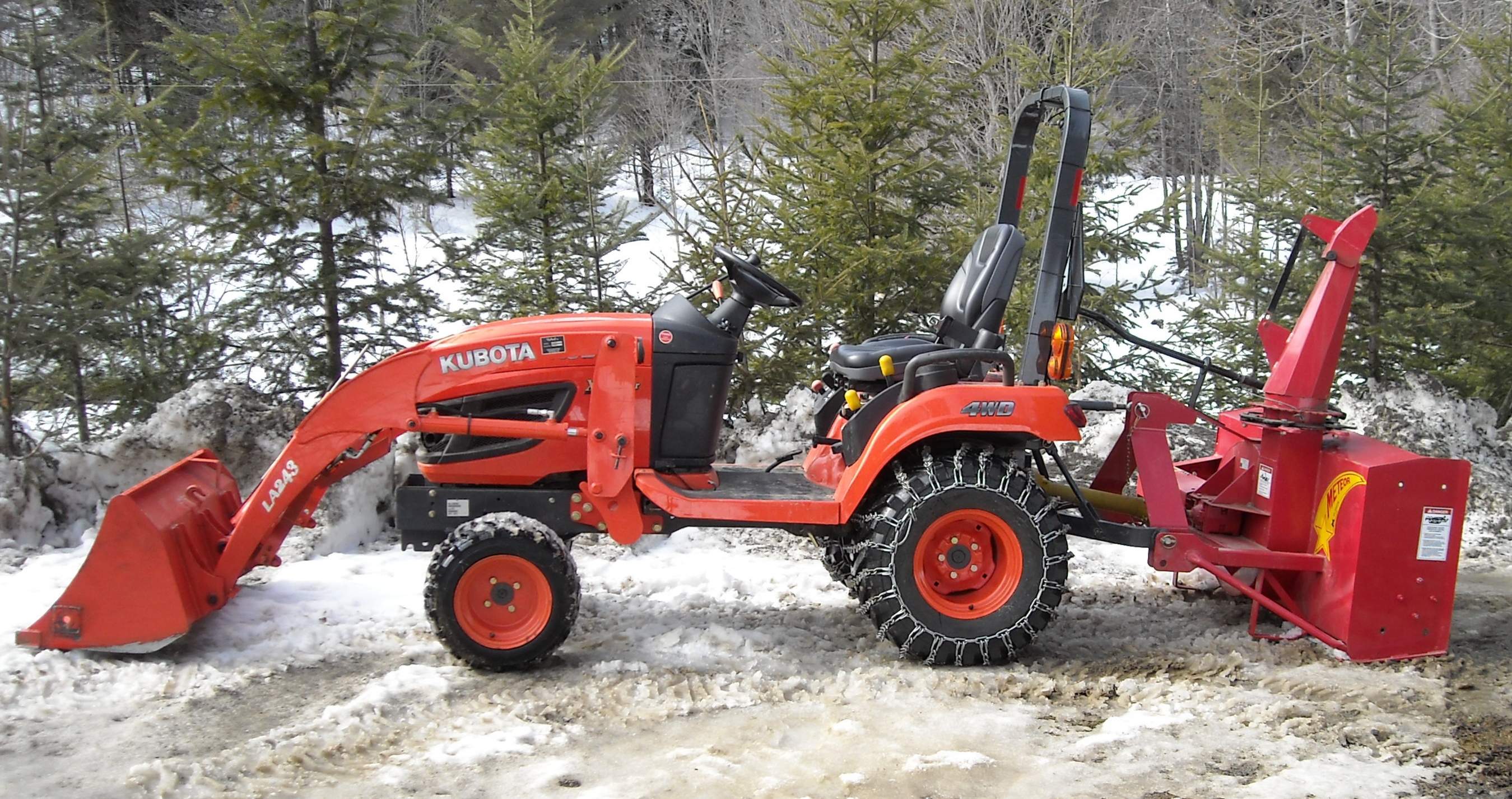

I have about 1/2 mile driveway I plowed with an ATV and plow this winter. The heavy snow eventually bent the mount of the ATV plow. I'm considering getting a snowblower for my BX 22. Using the loader this year dug up a lot of gravel from the driveway.
What size blower would work well on the BX22?
Any other suggestions. The driveway is gravel and hilly.

If you want a front mount I believe the only option you have is a Kubota. If you're thinking rear mount, there are many options. Even though your Kubota is underrated for this, I wouldn't hesitate to use a 60" blower. You may end up going a little slower at times but for the most part you'll be working more efficiently and with less chance of driving over unblown snow.
The key is to pack down the first few snowfalls with your vehicle. This helps keep the gravel where it belongs.

I bought a Meteor 5' rear blower this winter and loved it. Although we had a very low snow year, it worked excellent for me. I have a 1/4 mile long very hilly gravel driveway. I broke NO shear pins all winter. Rear chains were a must for my site.
Obviously the advantage over plowing is you don't have snowbanks to deal with.

I will agree on the Meteor rear blower. Nice rugged machine at a good price. I bought mine new (last year holdover) for $2000
