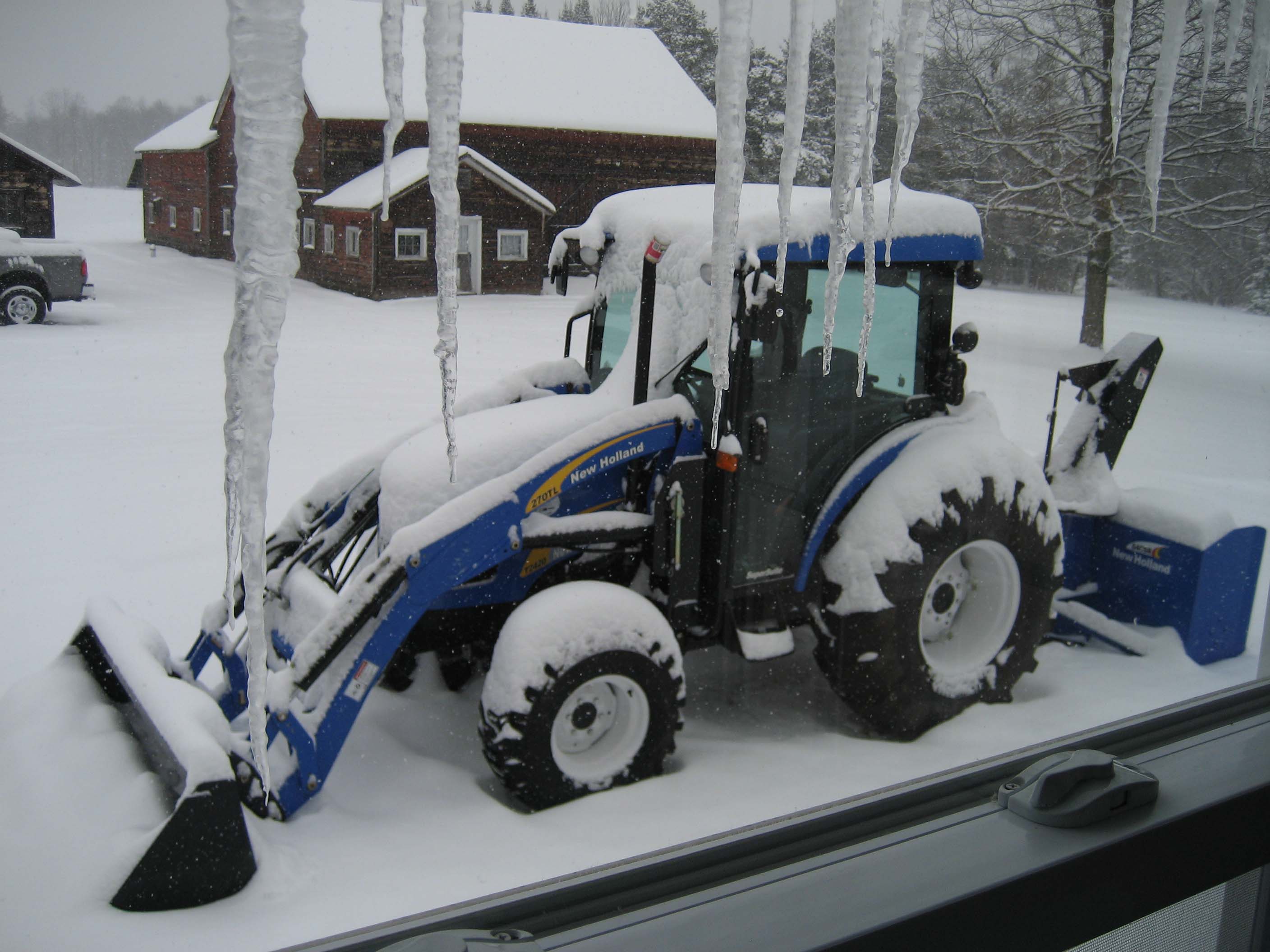

If you're referring to a clutch tractor TC 40 TC 45 including T4060 all of these tractors have three ranges four gears, all transmissions are synchronized so you can shift while moving. The simple answer is yes not quite as good as a hydrostatic transmission that's the ultimate for loader and snow blowing work however you can easily find a gear ratio perfect for the situation the slowest is low range gear one you'll be creeping along. The only difference in the tractors whether the clutch is SSS meaning that you have to clutch between forward and reverse or EHSS where the tractor will clutch for you going forward too reverse I personally have SSS 4060 I have to clutch between forward and reverse I personally love it I'm just strange that way ;-) I would never have the other system I have a rear snowblower and I'm going out this morning to clean up the storm we just received last night, around buildings I can use mid range first gear and never have a problem with speed near buildings
