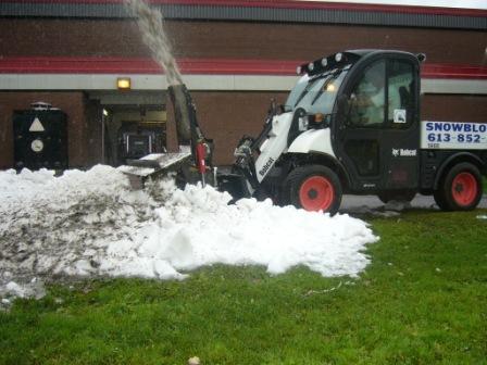

Here is a pic of mine cutting through sticky wet snow from the hockey rink. It is low flow but just seems to chew away at the pile and blows it pretty good.
It does not move as much volume as my John Deere blowers but the fan is only 4" on the toolcat and 12" on the JD.
Good luck
