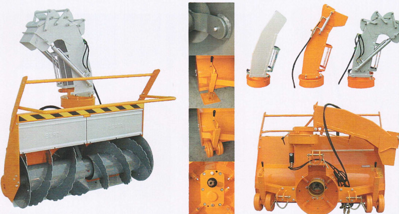

You need to ask the dealer if he can get you the smallest Berta brand rear mount three point hitch snow blower for your mule.
The thumbnail image I have uploaded is of the largest of these three Berta snow casters and the smallest one will work well for you.
If you can buy the Berta rear mount you will not have problems with your type of snow.
The other option is a Lorenz or Pronovost rear mount snow caster so you have no problems.
