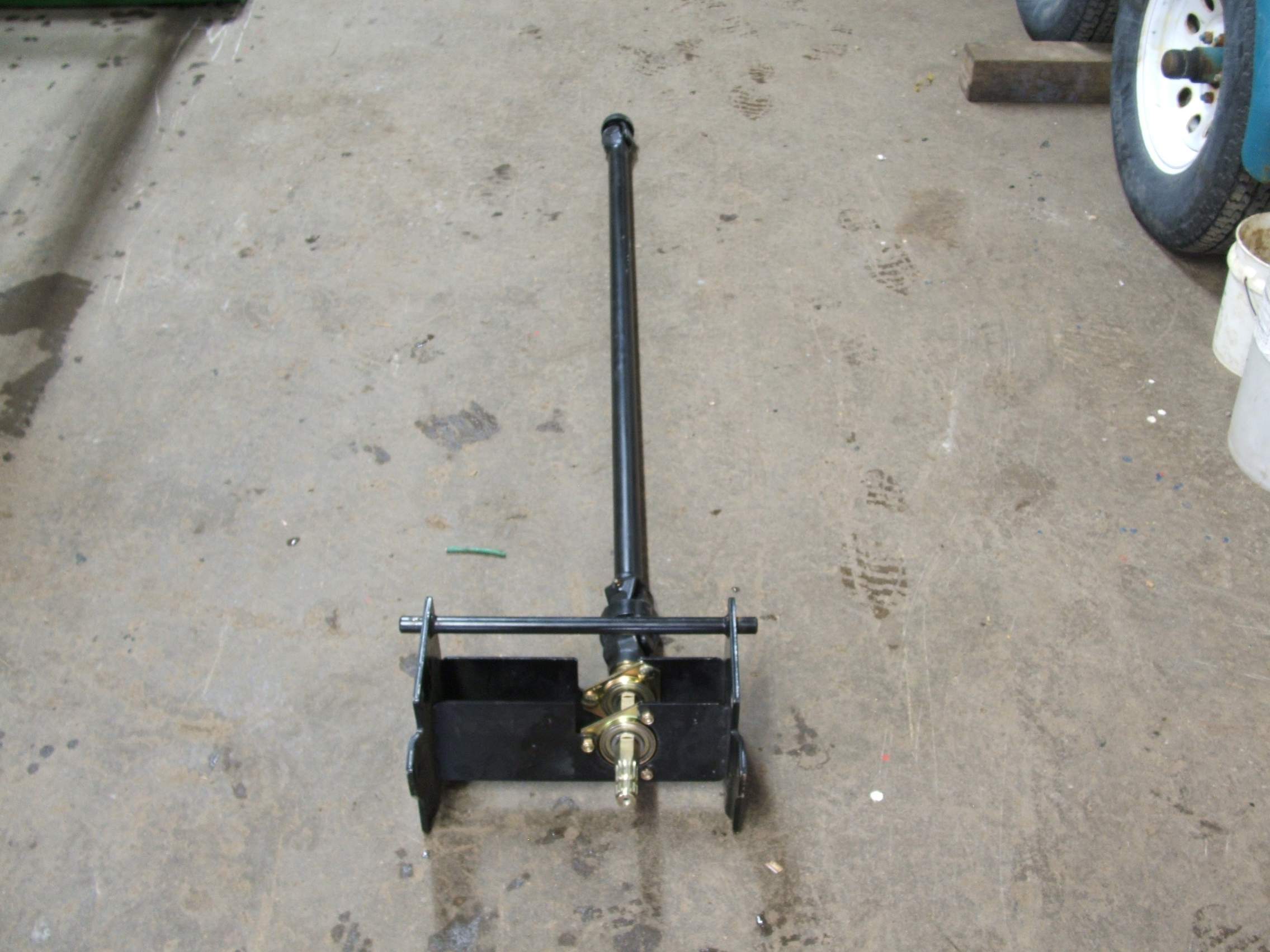

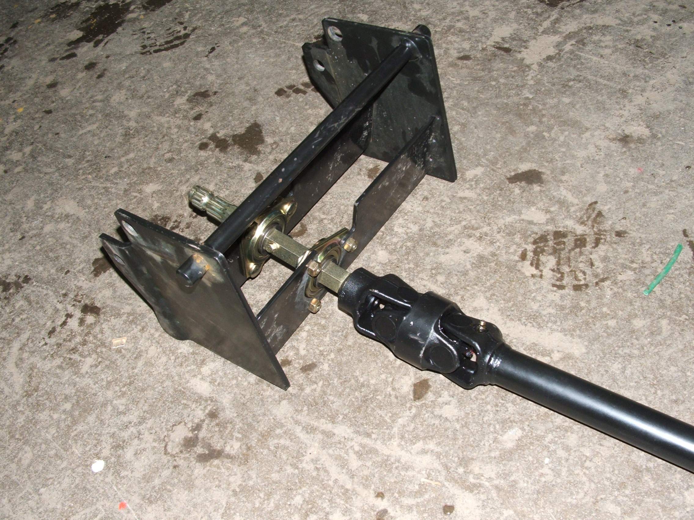

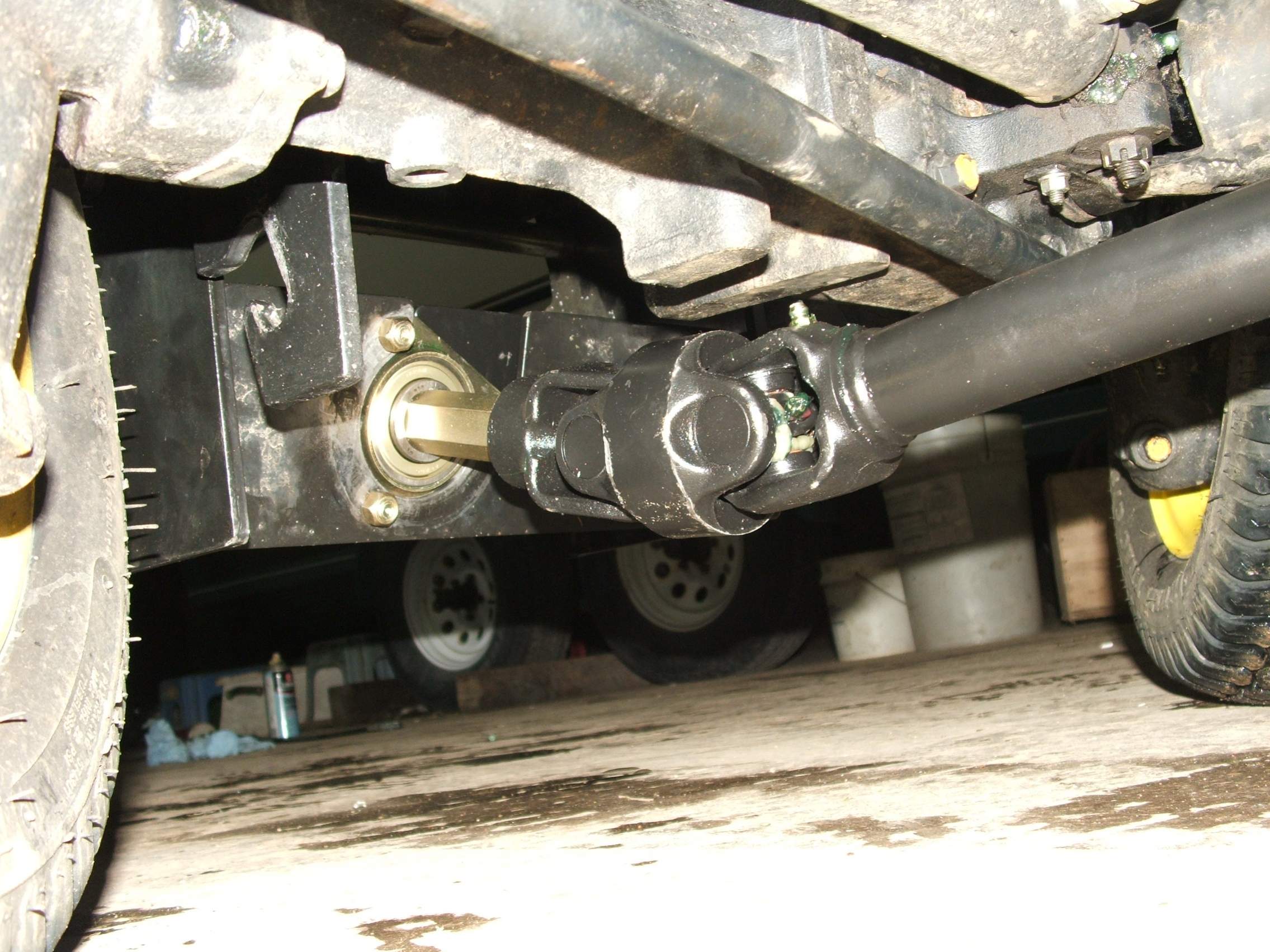

Here's what the kit will look like. It eliminated 90% of my vibration and most of the noise. My understanding is that the new 1026 series come also with the cv joint on the small shaft. Have not find out yet if it would eliminate the rest of the vibration.
   / Snowblower noise on 2305 front blower #13
Yep 1026r has cv joint from blower and the long one going to middle of tractor.. Much nicer than the old setup very little vibration. But honestly if all ujoints were lined up vibration wasn't to bad or at least on my 2305.

I gave in and bought the kit, what an amazing difference and worth every penny! It only cost $306 as well so it wasn't as painful after all!
