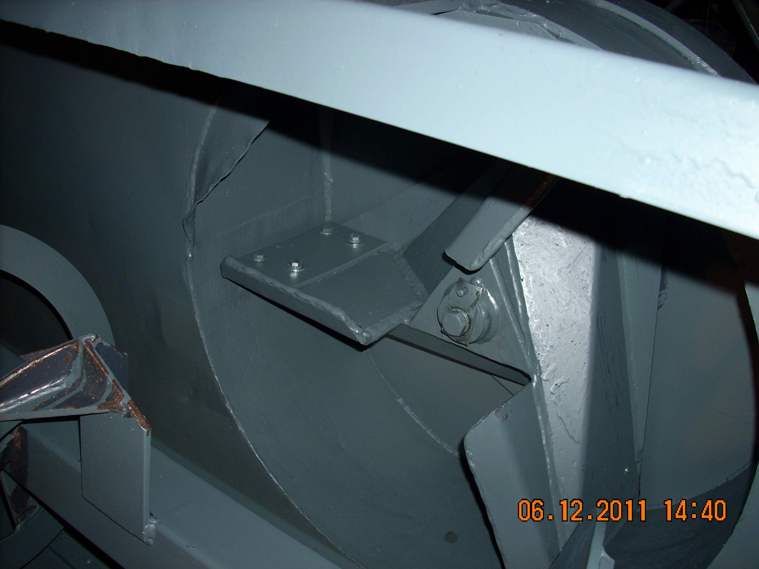

I used 1/4" mild steel plate when I did mine - with four 5/16" through the fan blade. Instead of steel, 3/8" thick conveyor belt would work really well as it is reinforced. I installed my metal plates in 2011 ( I think) and blow snow at 720 rpm ona 540rpm blower. Everything works fine and the blower really pumps out the snow.

I did this mod on my previous 3 point hitch mounted blower, using 3/8 " conveyor belt, and it worked great.
What you have to watch, if your doing this mod, is measure and mark each blade individually, because each length of blade might be a bit different.
Rotate the blade by hand and find the tightest area in the chute and adjust the belt to freely go by that spot.
I used 1/4 in. bolts, with washers on both sides, and a lockwasher and nut.

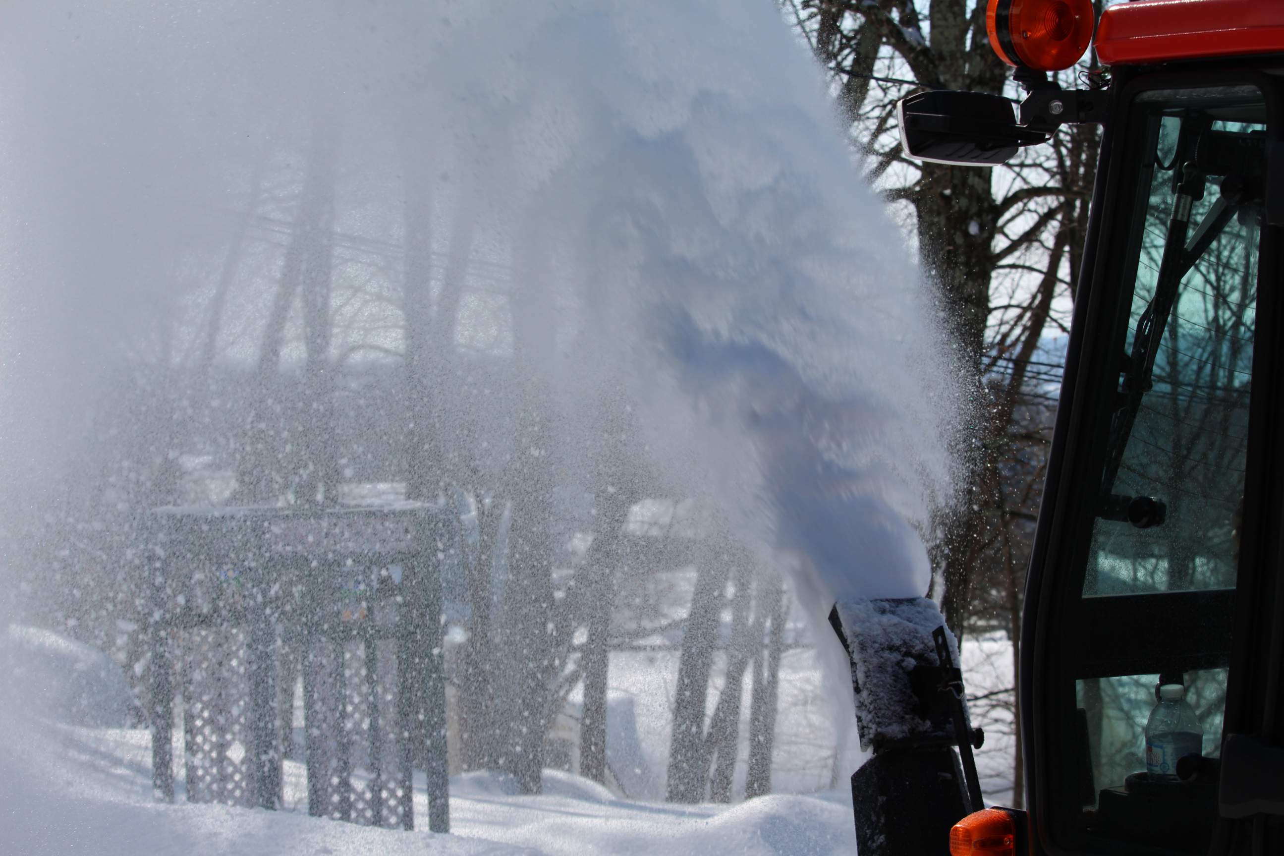

Today I woke up to about 2 inches of heavy wet snow. Based upon the snow blower's performance in removing this snow, I believe the modification was worth every penny. The snow may not had been thrown as far as I would have liked. However, I didn't experience any clogs whatsoever. Attached are some pics. One shows the wetness and consistency of the snow in my Kubota's bucket. The second shot shows the blower's discharge.

Looks good. I thought you'd find it worked. You might want to use some Teflon or Fluid Film spray on the impeller also to minimize the potential for freezing up overnight.
