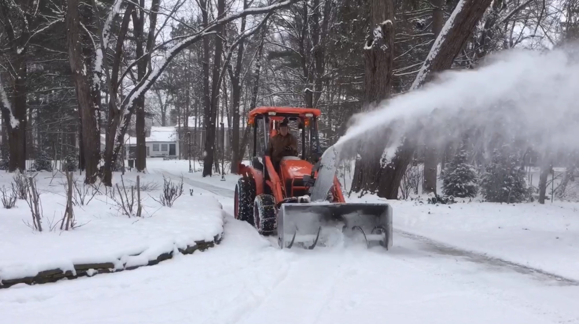

I had the 72" Provonost version on a NH 4835 (56hp at the shaft) and I was blowing well over a 1/2 mile of pavement as well as a gravel parking area and another gravel drive about 1/4 mile. It worked OK.
The Normand inverted on my JD4720 would easily spit out the pieces of the 72".

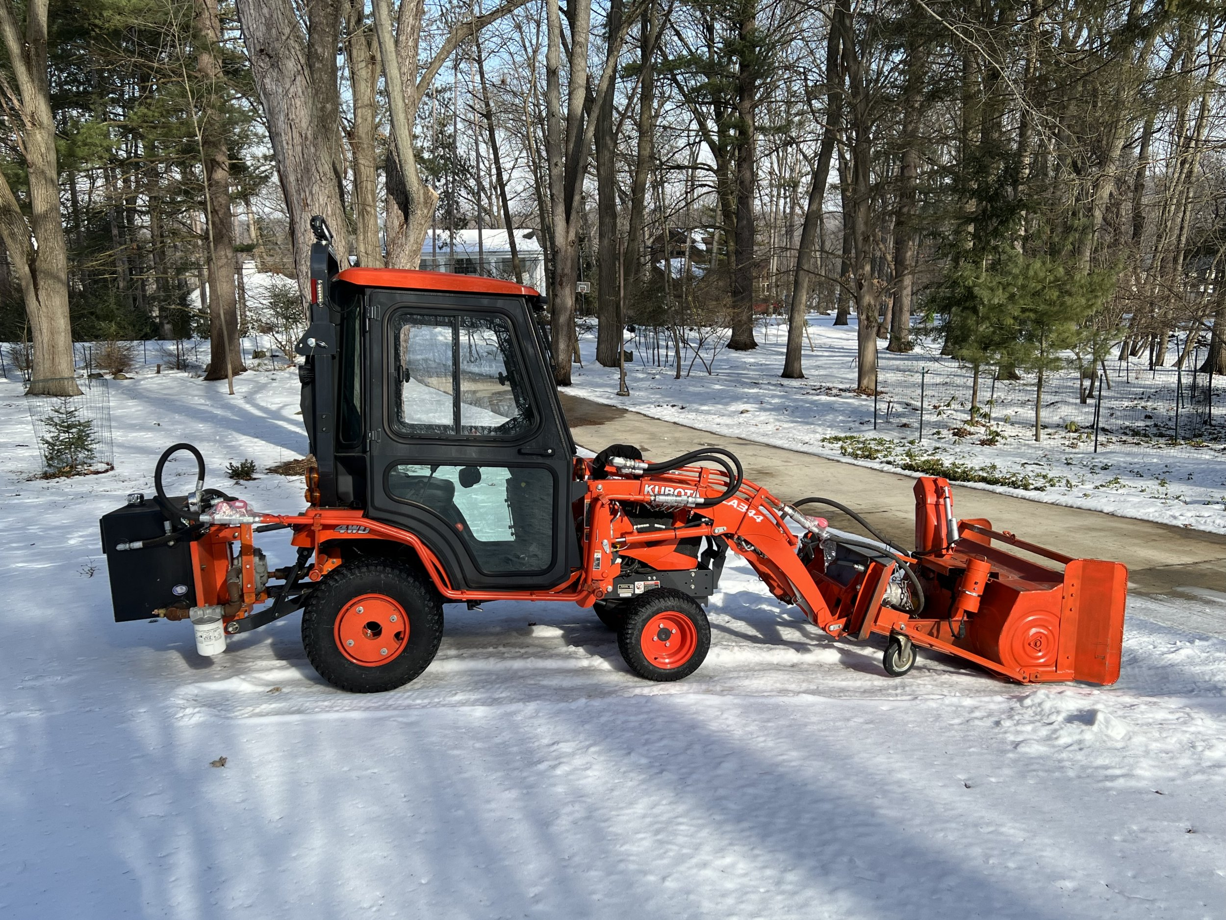

I have a hydraulic front blower on a 45 hp machine. Been working awesome for 10 years now. For those that say they dont work……..your wrong.
/ Snowblower for FEL, price, comments? #9
Your Land Pride system looks like a good solution. I have 2 systems- hydraulic front loader mount. On two tractors. Only caution is it could be slow with deep snow. Physics: you are lifting all that weight. Hydraulics is less efficient that direct drive. Plows don’t lift, so faster. I’ve never worked my systems as hard as you will so I’ve never needed oil cooling. Exposed tank and hoses are enough for mine. With heavy snow , it piles up in front of blower and waits it’s turn to go thru the blower. So you slow down. You will love it. Cost ? Higher than other methods. Mine was home built.

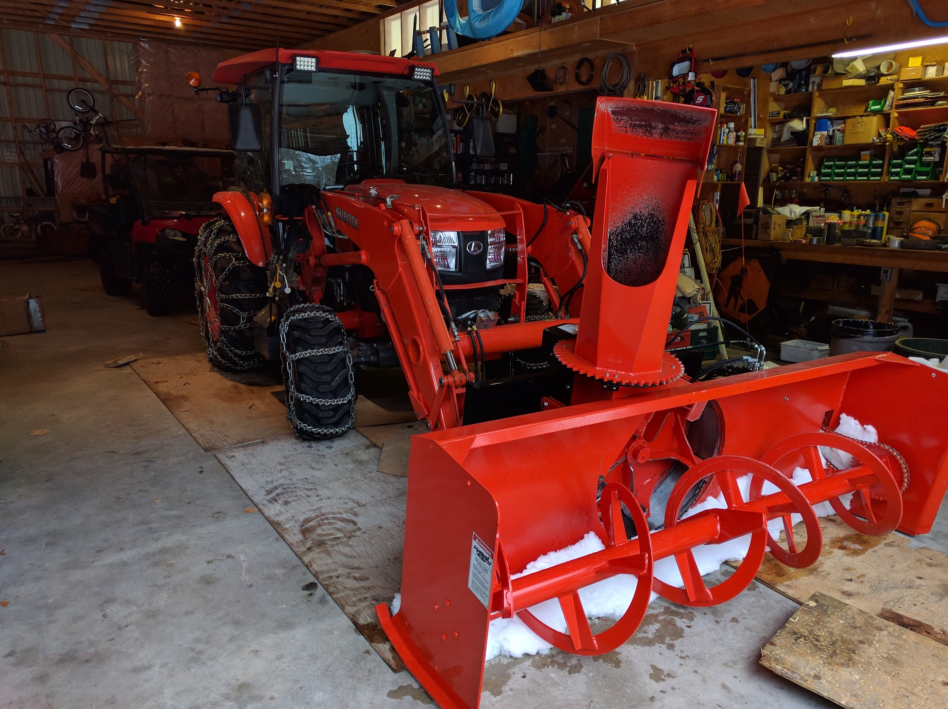

I have a PTO pump/3ph reservoir and a loader mounted hydraulic blower. Works well. Not crazy GREAT, but really rather well.
It is very important that the available PTO power, PTO pump size, and hydraulic motor sizes are correctly matched to the application. For example, too much pump flow and/or too small hydraulic motors will yield a fast spinning snowblower when not blowing snow, throw a good distance moving small amounts of snow, and bog/pack with snow when loaded heavily. My system was like that before I got everything better matched. It made for a miserably performing setup.
My GUESS is the HRS30 flow is a bit too large for your PTO power and the "spin fast, bog fast" I described above may be the result. To know for sure will require trying it out or consulting with someone very familiar with very similar setups.
The HRS30 without a cooler should be fine for winter use, especially with snow dust in the air! :) Too big of a pump and/or too small of hydraulic motors will not be your friend however.
BTW, I think that blower is 66" wide which I THINK is several inches narrower that your NH. If so, it will work, but not ideal. Especially inside turns.
