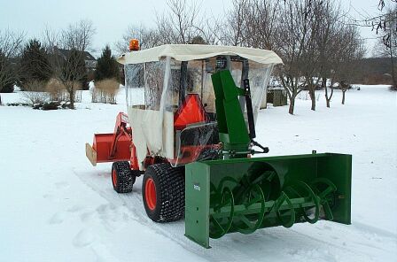

I went with the FEL and 3PT snowblower, a Puma, 54" got it for $1000. It had a work out this winter doing my driveway and about 10 neighbors 300 foot long driveways. It worked great had no problem with the 24inch plus dump we had.
If you can afford the 3 pt snowblower it is the way to go, BUT got to figure in a cab with a snowblower, very cold and wet without one, here is what I did.
Good luck

   / Snow removal with BX2200 #18
this is one of those things u are going to have to find out for yourself. personally like the fel and rear blade combo for moving snow(and i get a lot) the front blower at times would be faster , but i hate giving up the bucket. all a matter of preference
