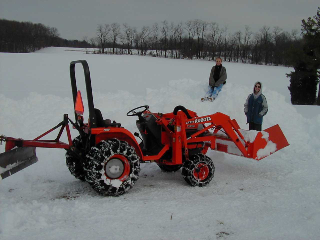

next angle
   / Snow Removal w/FEL #22
and one more (notice the barbell weights mounted on the rear wheels. . . . . )

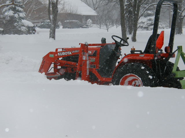

Last year was our biggest snow fall I've seen since 1999.. the snow was chest to waist deep.. just trying to get to the tractor I had to stop half way & rest. I couldn't believe how well my TC35D got around in the deep snow. My farm neighbor across the street got his 100hp tractor stuck just trying to get into his driveway.. the plow trucks couldn't even come down the main road due to the snow drifts blown from the fields. The neighbor's are really happy to see you on those days.. I helped dig out my 2 farm neighbor's.. & 2 close by residences.. it was a long day.. but a fun one working that tractor & FEL. Here's a picture off the back porch.. before I headed out.
